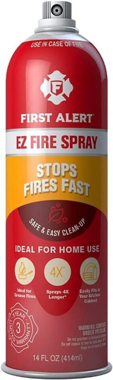

Re: Would like Fire Professionals' advice on car fire extinguisher
I am not sure how good these are. They have a high rating on Amazon, so I have one in each of my T's.
A video is included.
