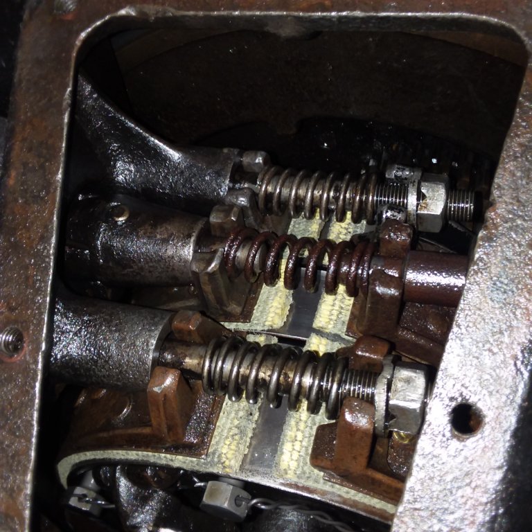

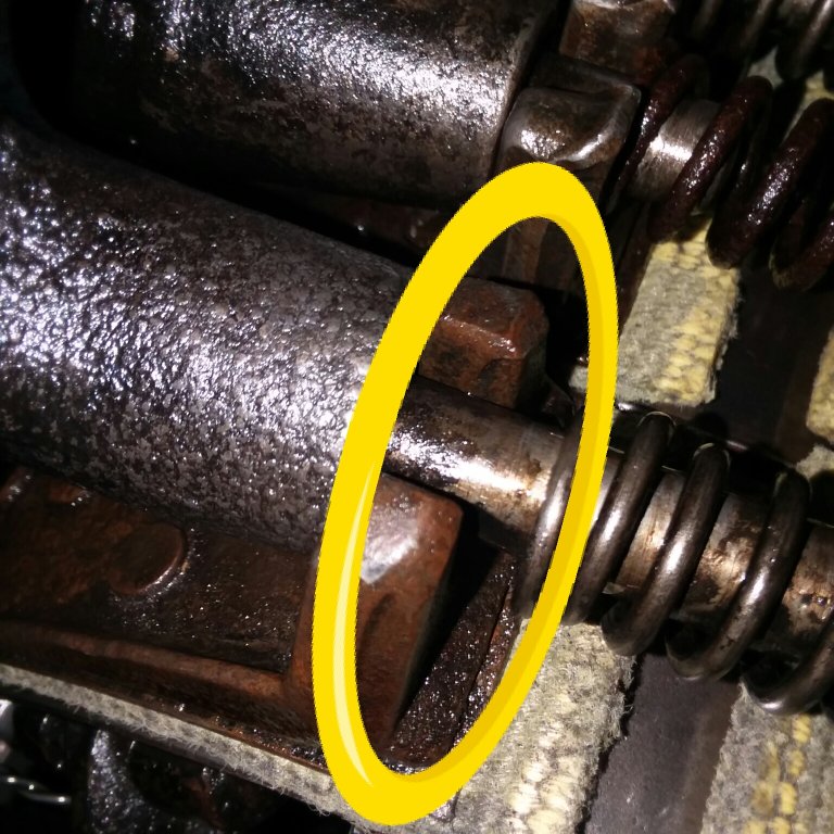

Do I need the longer spring, Lang's 3425BQ, because my kevlar brake and reverse bands are not under spring tension when released. The only spring tension is from the band itself wanting to open up. 1/8-1/16 of travel space before spring begins to tension.
Nuts spin easily by fingers and I don't want one coming loose and getting lost in the transmission.
So longer spring needed? Anyone see this before?
Thanks!
Thanks!

If it were me, I would get the new longer springs. One concern with longer springs might be that they would go into coil bind sooner, but from the picture on the Lang's site it looks like the spacing between coils is wider, so coil bind shouldn't be a problem.

Can you get the band tight enough to clamp the drum when it is 1/4" above the floor? and does it completely release when the pedal is all the way back also will the spring move the pedal all the way back and will it release completely the band when you remove the foot from the pedal? If so it is OK. But if it won't move the pedal all the way back and release the band so the drum turns freely, the springs are too short.
- Posts: 5267
Re: BAND SPRINGS TOO SHORT?
My common practice is to put new springs in with a band change (if short)
I would say 9 out of 10 band jobs needed new springs.
They do tend to take a set.
New springs are cheap.

Other than being smidge short, my big concern is there is little tension on the holding nut. I don't want it to back off and take a deep dive into "The abyss."
The only tension I get is from the metal band itself.

I’ve seen a few short band springs with washers to take up the slack. Always best to get the longer springs anyway with new band longings. Cheap security.
The longer springs make for a tighter setup which is good.

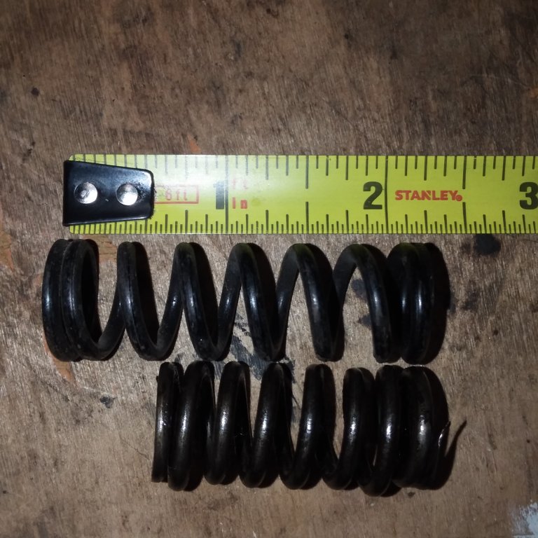

3425BQ springs are 2 1/4” long. Longer than Ford standard size springs.
They are sold 3 to a set by Lang’s. Some of the standard sized springs are too short.

Was able to find some longer springs today.
1.52 in car
2.15 new longer springs
1.95 current adjusted gap between band ears.
I should be all set now. Install Friday a.m.
1.52 in car

You can see by your dimensions, the old springs have shortened themselves quite a bit.
All is well.
All is well.

Springs changed out for correct longer ones. Binary feel of short springs gone. Nice pedal feel that now gives great feedback. Glad I caught this in time.

I learned a long time ago to check & change the 3 springs for every band change.
Of the past 30 springs I checked, only one was less than 1/8" too short. That one was replaced also.

Wow .... Both springs show, just from visual, show the same diameter wire used to make the springs.. and both have the same number of turns... The long spring never was in an engine, and the shorter one, removed from his car is almost 100 years old, has been under countless heat and cold cycles from use and weather and also been compressed all these years. ... If you were compressed all these years, tightened to compensate for band lining wear, like this spring, you'd be shorter yourself. A better comparison would be to find out the metal blend that was used to make the wire for the springs...... Thank you Professor Fate for your picture and comments on your new springs.

Moxie,
Recall, We pretty much had a near similar experience when we redid 'Tom Edison' Model T bands up at West Orange Carriage House turned Garage.
Not only were the original springs almost mush...the new springs were actually just a wee bit too long for the re-rounded bands with wood liners and their ears. I had to put the springs in the bench vise, squeeze them shut to look like the old spring shown in the photo with the vice, and then let it expand back to 'almost' original length. They then went in with only a little bit of persuasion through the tranny door

Out of curiosity, ... does someone have a verified Ford NOS band spring that can be measured , and post measurements and photo???

That is WAY to much kevlar band beyond the end of the steel band.

I couldnt jump to that conclusion.
One method of installing lining is to cut the band lining in 1/2 & leave a gap @ the bottom.

Maybe a method by anyone, but, ...the manufacturer of the Kevlar linings does not approve of that method of installation.

. FRED : ..... Sometimes I wonder that myself, it seems that people just comment on the last one or two postings, and then put in their comments. Thanks for your consideration.fschrope wrote: ↑Tue Jul 25, 2023 5:32 pmI can't believe more folks haven't commented about this.Moxie26 wrote: ↑Sun Jul 16, 2023 2:10 pmJust a question .... who re-lined your transmission metal bands with the Kevlar linings? . ..From your picture it seems that there's too much lining beyond the metal band and bracket. The lining should be installed to the band at the open ends with maybe a quarter to an 1/8 inch band beyond the metal on both sides and then the lining material moved and worked in to fit inside the metal band prior to riveting the lining to the band. I apologize on my comments if I'm wrong with what I saw on the picture.... Since you are going to replace the band springs , if need be, it wouldn't hurt to remove , check and adjust the band lining installation.

The Kevlar Bands are a lot thicker when new and that requires the longer spring.
They can be placed around a drum and compressed with a C Clamp to make them thinner before use.
Normally new Kevlar bands require three adjustments after a very few miles and then they are good for a year or more with no further adjustments required.
Using those short springs might be OK after some short runs and those three adjustments.

Band springs need to be long so pressure is placed on the band in an outward direction so the adjusting nut and lock washer are always engaged and will not come loose and drop into the engine causing serious damage to both engine and occupants.
