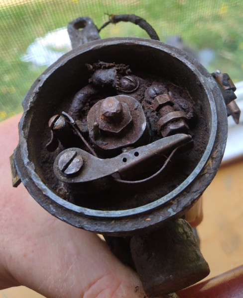

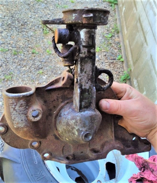

Hello guys,
Picked this up from a friend yesterday. Not labeled, and I've spent hours comparing it to others. Not sure if I'll actually run it but it's interesting to me. No rotor, distributor cap I have with it looks a lot like a early 20s Delco type. Anyone recognize it?

Loos like what was called an "Timer Elevator". Basically a standard commutator would sit on top for easy adjusting, Need to see what is on the plate where points would go. I see that it has a condenser. May be a modification of sorts

Yep I can get a picture when I get home. Don't think it's a timer elevator, that's what I initially thought too. Only modification I can see is the modern condenser. Inside distributor has point "cam" points and provision for rotor. Also has clips to hold cap in place, and indexing point to clock cap in correct location. All looks original to the assembly.

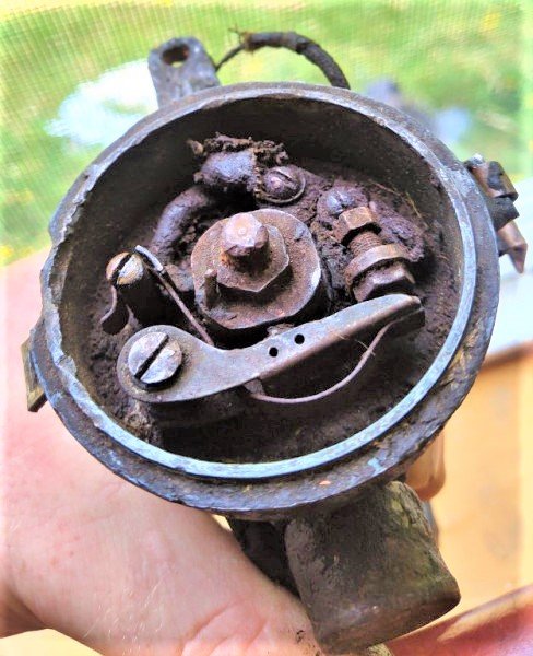

Post by TRDxB2 » Sun Jul 16, 2023 3:01 pm
Enhanced the original photo

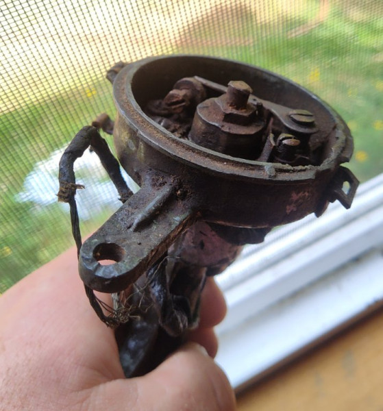

Post by DylanWills » Sun Jul 16, 2023 4:30 pm
Here's a couple of the top. Thanks for enhancing that picture, way better!

Very Interesting. Clean it up you might find something to help ID
