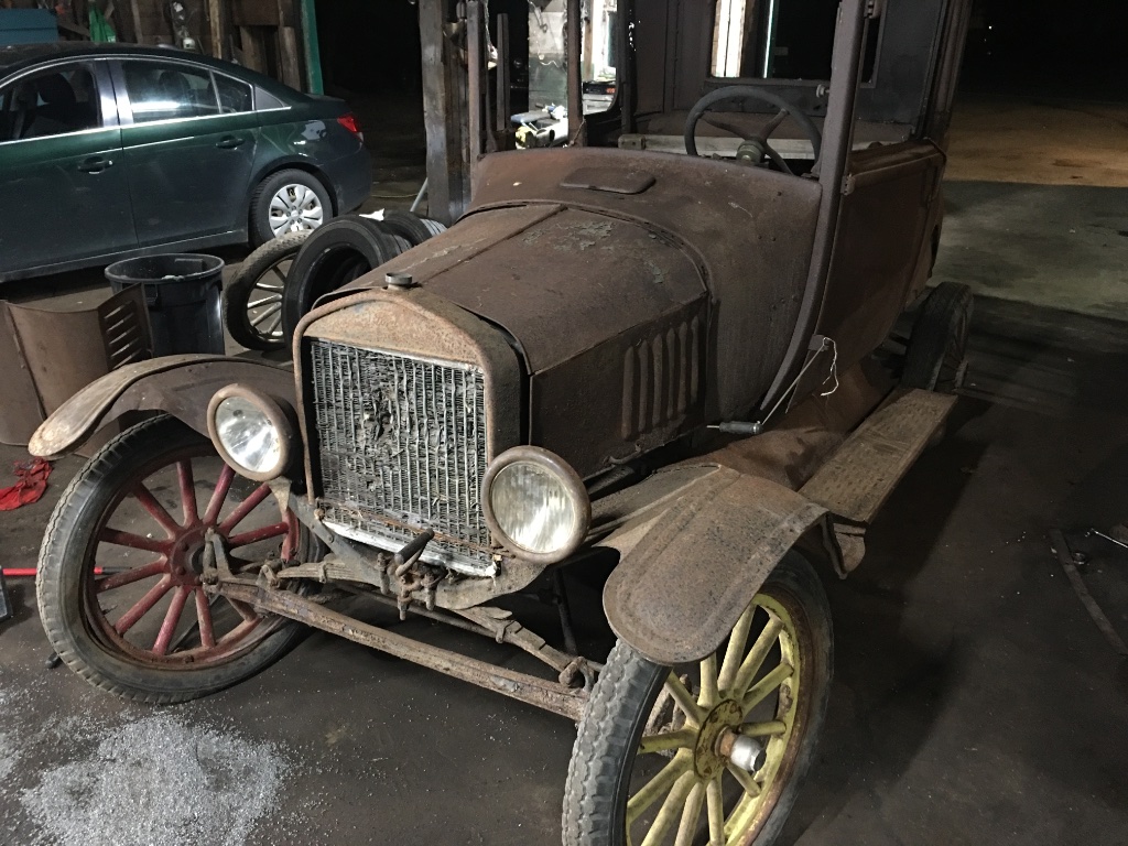

Just bought a 25 coupe project that came with 2 truck loads of fenders and other parts. I am putting it together not going to be fancy just going to drive it the way it is maybe brush a coat of paint on it my problem is my hood is too short. I have 3 1925 hoods but it won’t fit the 27 body. What has changed between the 25 and 6? Is it where the rad is or is the whole body different? My firewall is a 26 but I have a 25 firewall with it but that still doesn’t make the hood fit

for all the typical mis-shapen bends which can be rectified, the hood appears to fit like it should
where does it not fit?
Paradise Garage
Posts: 54
Joined: Sun Jul 16, 2023 8:27 pm
Last Name: Howie
* REQUIRED* Type and Year of Model Ts owned: 1924 coupe
Location: Paradise, Nova Scotia
Re: 1925/26 coupe project
Post by Paradise Garage » Sun Jul 16, 2023 9:25 pm
The hood is an inch or so too short. If it sits on the radiator where it should it doesn’t touch the cowl I believe this is because I am trying to mash 1925 and 1926 parts together

You might have a “high” radiator and a “low” hood.
Or maybe your radiator support rod is the longer one for wood firewalls. 20 3/4” versus 19 1/2”.

regardless of what year the hood is or how tall it is (early or later radiator height), they all are 24 3/4 long along the center hood hinge (front to back)
is the body solidly on the frame or is it just set on the frame?
there are millions of reasons why things won't fit, but since the radiator is at a fixed point, if the body is too far back, it's too far back (and if it is, then body mounts are not going to line up with frame brackets)
a 26-27 body will not have a separate firewall

There's a lot there that is earlier than 1925 even. It appears to have a high radiator shell on a low radiator, going on how much of the radiator filler neck is showing. it has the early two U bolt front engine mount. The hood sides do not appear to have indents where the hood latches engage on the bottom. This would indicate that the hood is for a low radiator car 23 or earlier. I cannot see the dogleg at the rear of the hood shelves either. Until you know just what you have, it is a bit pointless trying to make it fit.

That is a 26 body, so you need 26 hood and high radiator.

Your '26-'27 Coupe body is radically different from a '25 coupe, for one, the gas tank is in the cowl.
Good news is you have a '26-'27 chassis, so at least the body will mount correctly to the frame brackets and both must match.

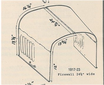

Now the bad news, the radiator is low style '23 and before, shell and the hood are earlier and hood is narrow at the cowl, and the fenders and headlamps are '17-'25, but they hang because of no fender/headlamp arms of '25 and earlier, as the '26-'27 fenders mount to the chassis.

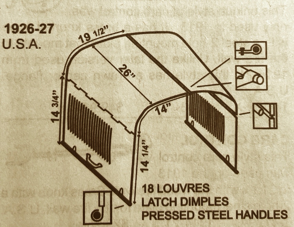

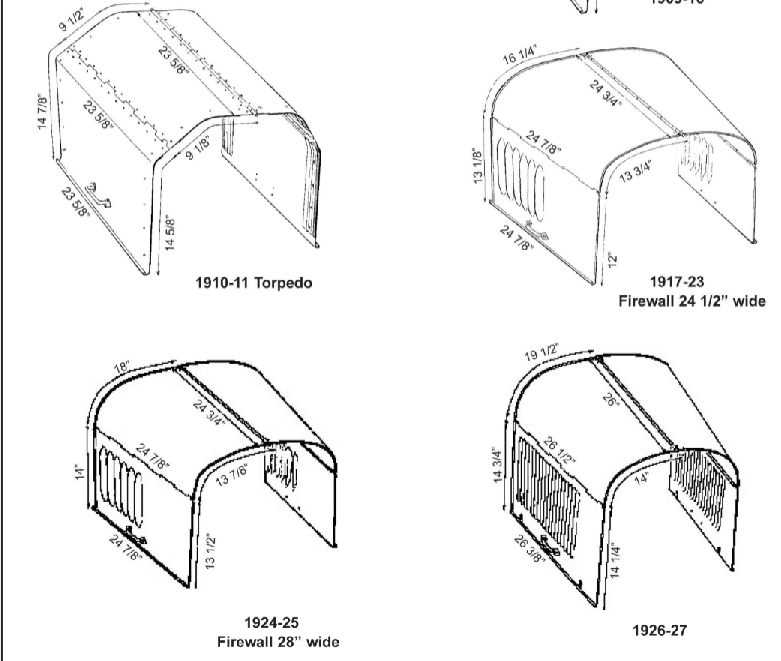

No easy way to match, get a high radiator and shell, and a '26-'27 hood which is wide at the cowl to fit your body, and '26-'27 front fenders too.
Here are the hood measures to see what year hood you have, and the '26-'27 hood dimensions that will fit your Improved Car coupe body.

The easy tell on the hood is the number of louvers on the side panels

You need a radiator anyway. '26 '27 parts are the easiest to find, although a decent radiator shell may take some looking.

Dan, have I missed something? How can the front fender irons and fenders mount on a 26-7 frame? It looks to me like a 26-7 body siting on an earlier rolling frame and wheels. We need more photos.

Well it might be a 26-27 frame, are those extended front frame ears? Better pictures would help. 26-27 motor mount with something odd going on with that front spring and mounting, clincher front wheels, earlier crank, earlier fenders, splash shields, and running boards, model A rear wheels, low radiator, who knows what this car started life as. Plenty of inexpensive T's out there that are not parts salads, not sure I would recommend going any further on this one, maybe look for a better one to put time and money into.

The front engine mount is the earlier mount not the one for the high cowl cars.
It sure seems like it has a low radiator. It’s a typical T that came with extra parts and seems to be put together that way on an earlier chassis.
That’s the thing about Model T’s.
You can build one from parts and it can run OK but as far as being a pretty much correct car it’s not.
What does the title say that it is.

When I blew up the photos I can now see the late engine mounting bracket, and possibly the extended front frame cross member of a 26-7 so the frame may well be true to the body. I still don't know how they cobbled the early fender mounts and fenders onto that frame.

When I bought this car it was not together I just bolted the fenders on and they fit mint I am just going to put it together the best I can with what I have and drive it. Where I live in Nova Scotia parts and cars are slim pickins I paid 2300$ for what you see in this picture plus some fenders and another engine. I am quite excited to drive it. It will never be a show winner unless worst in class is a trophy.
