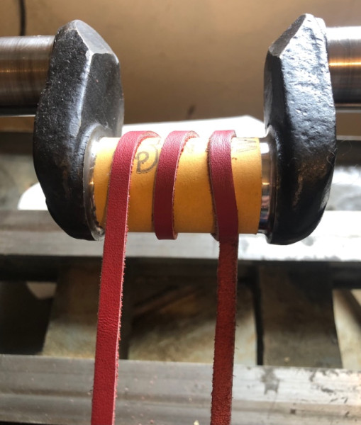

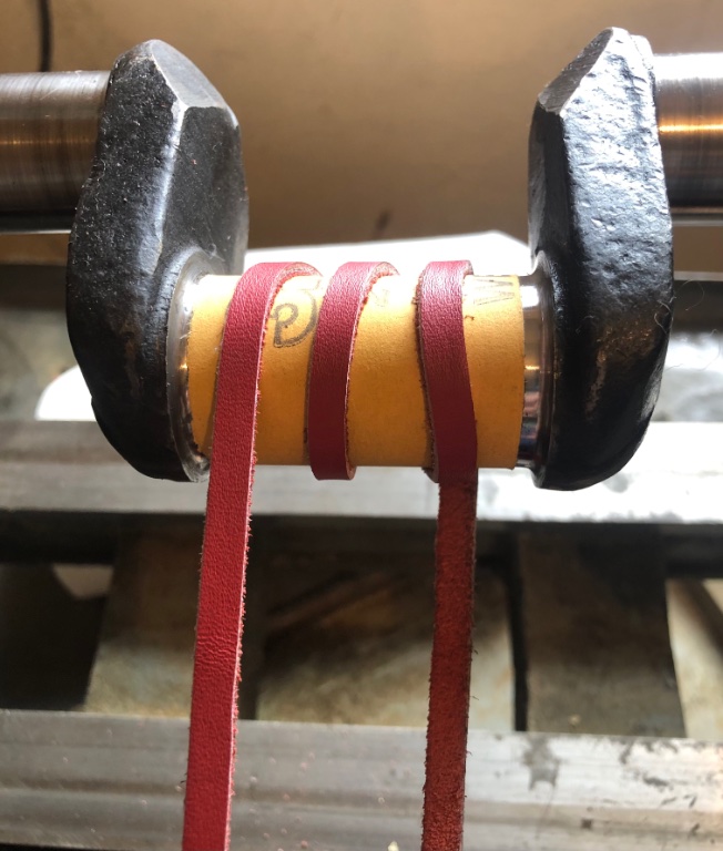

I believe this tip is in the model T "bible". Very nicely polishes crank journals. Light leather strap and 360 grit wet-or-dry sandpaper.
