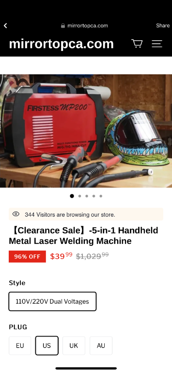

If it’s the ones in videos on Facebook one would think Mack is correct with the “think about welding”. I think they supposedly sell for under $100 but I don’t know anyone that has bought one. For the price I’d like to try one but am always skeptical if I’d ever get it actually shipped to me. The videos appear to be time lapsed coupled with someone demonstrating it that probably has very good skills in welding, making it look so simple. If anyone here has one as described and it works as well as demonstrated let us know & I’ll retract my post & apologize. I’ve just been taught if it looks to good to be true…. It is.
https://fb.watch/lQijOEkWXH/?mibextid=cr9u03
I hope I’m wrong! Best John

I think John is spot on these are a scam just like the laser rust remover from last year. They take your money, send you something
worthless that can be tracked then they have proof that you recieved it and refuse to give you a refund. Buyer be ware.

As for purchasing a $100 welder, anyone buying one will get exactly what they deserve: $100 poorer ;)

A new breed of snake oil salesman or anything else for that matter. True "Craftsmanship" is an on going learning with discipline in perfecting the "Craft". New methods are acceptable but only after they can "Prove" value.

For the moment; you get what you pay for, $200 will NOT buy you a good laser welder, it WILL buy you a lot of first class frustration, if that is your thing, go ahead ! :D
