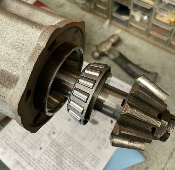

Post by DanTreace » Tue Jul 18, 2023 11:57 am
Got my enclosed spool with modern innards (no. T-2587-E1) , outright from, Birdhaven, (800-337-6977), can then send in a good core to reduce the price.
They know this stuff, on telephone order she asked if I wanted the raised bump style!
