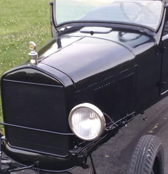

I use Rustoleum Gloss Black on everything. You will like it. You can use a spray can for the small stuff.

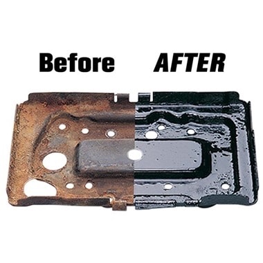

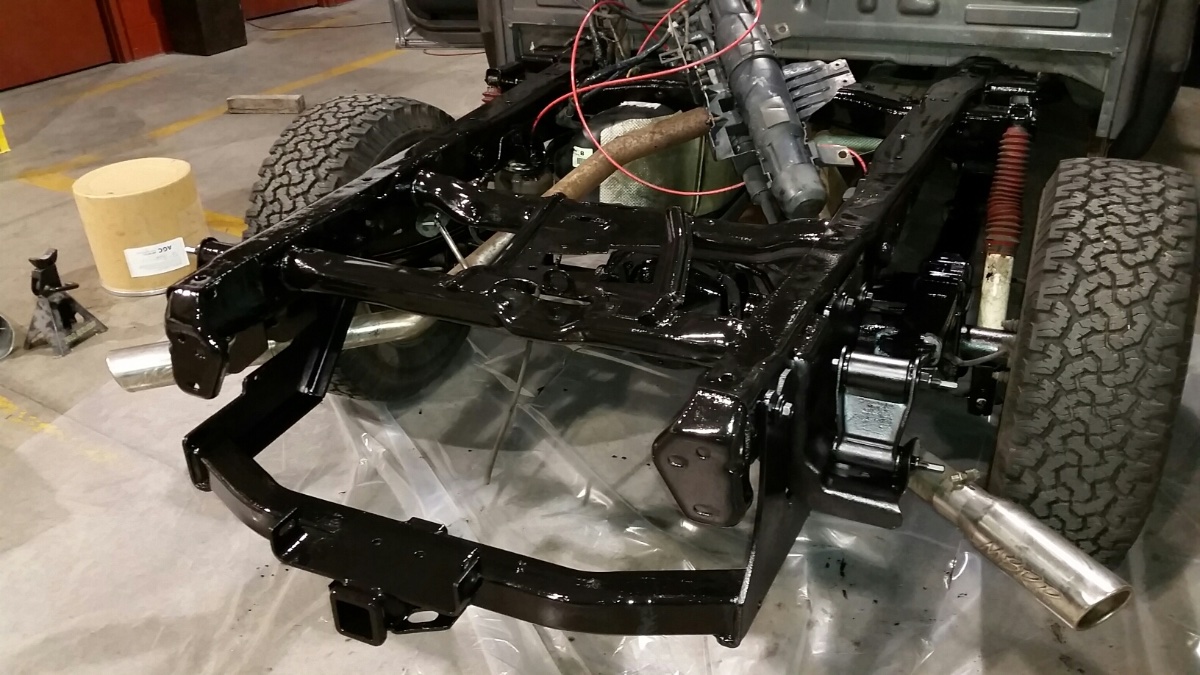

POR 15 coatings have been highly recommended on Model T’s for years. Go to www.por.com and check out the various types of coatings and I think you will be i pressed. They are durable, look great, apply well by brush and are virtually indestructible. I coated the inside of my gas tank with the silver POR gas tank coating kit in 2010 and it is still protecting the interior of the tank as well as when it was first applied. Jim Patrick.
PS. I have always preferred using gloss paint on the chassis, axles, springs and linkages under the car. Not only does it look better than flat paint, it is much better at shedding water, dirt, grease, oil and mud from the surfaces under the car.

I absolutely second this motion, Jim! I've painted quite a few cars and I've never come across another product like this before. It's tough as nails and sticks well. Spray OR brush on. You really can't go wrong with their specialized frame paint. I also paint all my engines with it and years later it still looks great.jiminbartow wrote: ↑Thu Jul 20, 2023 8:22 pmPOR 15 coatings have been highly recommended on Model T’s for years. Go to www.por.com and check out the various types of coatings and I think you will be i pressed. They are durable, look great, apply well by brush and are virtually indestructible. I coated the inside of my gas tank with the silver POR gas tank coating kit in 2010 and it is still protecting the interior of the tank as well as when it was first applied. Jim Patrick.

POR-15 is great, but if you use it you are committing yourself to use it forever. Nothing but POR-15 adheres well to it. If you ever want to recoat the frame with anything else, you will probably have to sandblast it off. I'm not being positive or negative on POR-15, it's just something that you should be aware of. I would not powdercoat the frame.

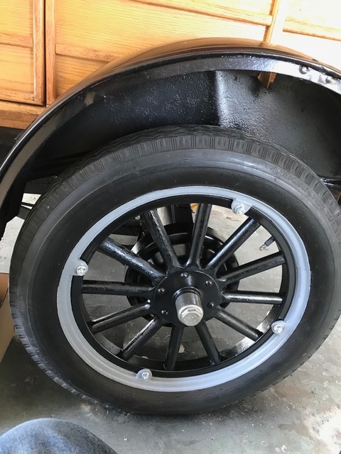

Most intermediate restorers up until the late 70's early 80's use to buy Clear Rustoleum Alkyd (don't think available anymore) and Semi-Gloss Rustoleum Alkyd mix them 50/50 and cut them to spray without runs. Old timers claimed it was pretty darned close, and, I'm pretty sure that when Richard Petty of Elgin was building Stynoski after Stynoski in the 70's this was in fact his secret formula. I learned it from him, did my first car over in it on the chassis and was happy.

This was all done in the rustoleuem except the inside of the fenders, I did them more flat. The drums, hubs, and fellows use to be cherry red.
