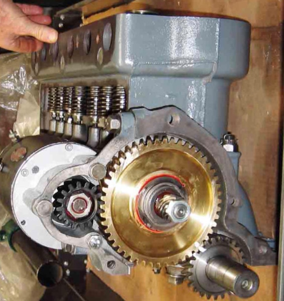

Standard Model T 3 gear set up, looking from the front, crankshaft gear goes clockwise, timing gear goes counter-clockwise and generator gear goes clockwise. Jim Patrick
