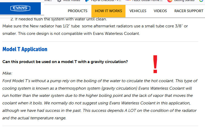

They don't recommend it unless the engine has a water pump https://www.evanscoolant.com/how-it-works/forum/Rod wrote: ↑Sat Jul 22, 2023 6:20 pmI just completed my first tour today using Evans Waterless Coolant in the radiator of my 1913 Touring T. It was an 80 plus degree day here in Indiana and we traveled well over 60 miles. The Moto Meter gauge never rose above the bottom of the circle. I believe this is due to several factors. First the boiling point of the Evans coolant is 375 degrees. Second the coolant doesn't expand with heat. The radiator fluid level is still at the top of the tank, unlike traditional coolants which expand and flow out the overflow tube. This means more coolant in the radiator and no steam or boiling coolant. I am very pleased with this product! https://www.evanscoolant.com/

So an expensive coolant has a higher boiling point than 50/50 does. So what? A Model T cooling system in good condition will stay well below the boiling point. I believe I have read that it's 180º - 200º. In my book 375º is high-priced overkill.
By the way, the Evans blurb's allegation that the thermosyphon system depends on boiling is bogus. The whole point of the system is to not boil.

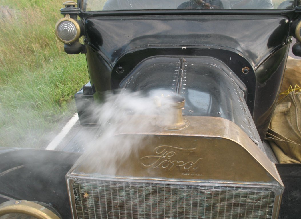

In my case, my car is 98 years old, and so is its radiator. Last year's MTFCI Int'l. Tour had days in the high 90's. Never boiled once.
Using coolant with a very high boiling point, and not having your car boil, does not mean that it's running cooler. The indication on your motometer* only means the COOLANT is running at a lower temperature, not necessarily the engine itself, escpecially in areas of high heat concentration, such as near the valve seats. Evans' decreased ability to absorb heat energy, (compared to water/antifreeze), means that the coolant itself will likley run cooler, while leaving the "heat" in the engine.
*The motometer indicates coolant temperature, NOT engine temperature.

A thermosyphon system will not function correctly with a coolant that does not expand.
Model Ts do not depend on boiling water, or boiling anything, to circulate coolant. They depend on thermal expansion of the coolant.

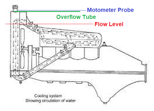

More specifically, thermosyphon depends upon variation in the density of the coolant, with less dense, (i.e. hotter), coolant rising to the top of the radiator, and more dense, (i.e. cooler), coolant dropping to the bottom of the radiator. Lack of coolant expansion suggests little to no change in density and therefore little to no thermosyphon. So, why does the OP see cooler motometer temps? Because the coolant is likley staying in the radiator longer, while the coolant in the engine is secretely getting very hot, (due to its very high boiling point which does not display the typical overheat symptoms).
The OP states in another forum thread that this is a "brand new engine"... Not a great way to break in a new engine. I hope he hasn't spent $250 to ruin a new motor.
As Pat and others state, it has nothing ot do with boiling.

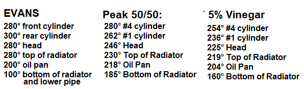

I appreciate all of the input regarding Waterless Coolant.
Upon your suggestion, I ran the car for several hours today. Here is what I found.
280° front cylinder
300° rear cylinder
280° head
280° top of radiator
200° oil pan
100° bottom of radiator and lower pipe
These temps are with the timer set in the middle of the quadrant running on Mag. Moto meter shows at the bottom of the circle.
If I fully advance the timer, the Moto meter shoots to the top of the scale.
I also discovered that the Evans coolant does expand with heat. The fluid settled at about 1" below the top of the radiator.
280° front cylinder
300° rear cylinder
280° head
200° oil pan
- Posts: 6586
Re: Waterless Radiator Coolant
One needs to consider the principles used in the design of an existing system before applying new technology to it.
In the case of a Model T engine cooling there are several considerations of how things were done in that time:
-What is the suggested operating temperature range of the engine & how was it measured?
-What "system" was used maintain this operating temperature range?
The popular method of measuring engine operating temperature range back then was with a Motometer. But Motometer's did not measure engine or water temperature directly since their temperature stem never was lower than the top of the radiator tank. So it basically it was measuring water vapor temperature. Having said that, there are some references indication that the desired range was between 190-220 °F. Anything over 220°F was boil over. Again this is an inference that the engine was okay when the measurement was within the temperature range. So what advantage is there to have a coolant that prevents boil over past 250°F? And is a steaming radiator a warning sign of a potential failure and time to pull over.
The "system" used in the Model T engine was thermosiphoning. Thermosiphoning relies on the coolant circulation being driven by coolant in the water jacket becoming hotter and hence less dense then the coolant in the radiator. So as the less dense coolant (vapor too) rises the cooler coolant in the radiator and rest of the system seeks to level itself continuously.
Can flow occur without the coolant becoming less dense (expanding) in the system? Can it be assumed that if the coolant is above the flow level the principal of hot air rising and cool air falling cause flow? Secondly, if such coolant is below the flow level can flow occur at all. That is the question

yes, at about 66% the efficiency of water or 80% of the efficiency of 50/50. Science is a tough mother.As long as the coolant is in liquid form and in complete contact with the water passages in the engine, it will do its job to take the heat away from the engine block
From a customer to the Manufacturer:
Reply from the Manufacturer:Can this product be used on a model T with a gravity circulation?
Advice on the Forum:We normally do not suggest using Evans Waterless Coolant in this application, although we have had success in the past. This success depends A LOT on the condition of the radiator and the actual temperature range
so you've successfully used a product that is not advised by the manufacturer for that application; at $50 per gallon costs 4 or 5 times the price for a typical coolant; have chosen a coolant with the worst possible specific heat value on the market, but based on your fortunate (but not typical) experience, you highly recommend its use.I've used Evans for a little over 20 years and I am satisfied
Questions I would ask if I were contemplating its use:
as a coolant, does it cool well in a non-pumped, non-pressurized system? No, based on its specific heat, it is the least efficient coolant available on the market
as a coolant, is it a good dollar value? No, it is the most expensive product on the market
if there is a failure in the cooling system, will there be any indication of trouble from the coolant before the engine seizes? No, since the coolant does not boil until 375F, by the time trouble will show at the radiator, if it ever shows at the radiator, the engine will have already been seriously damaged or ruined
It is not hard to find advice on the Forum.
The difficult part is deciding which advice is safe to follow.

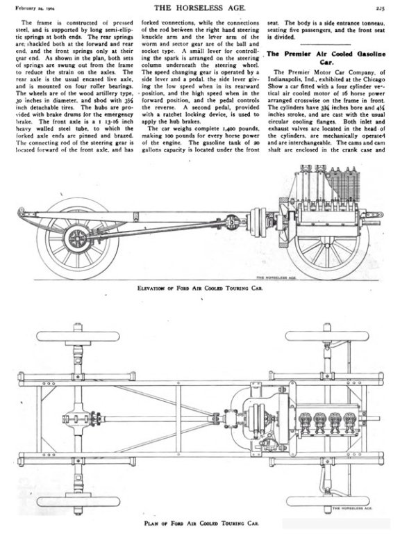

Well the horse was dead in 1904. The company offered a "water-less cooled engine." But it didn't sell well.
https://www.mtfca.com/discus/messages/3 ... 1380300717

I thought about starting another thread, but I will continue this one instead.
I drained the Waterless Coolant yesterday and filled the radiator with 5% Distilled Vinegar. Let it sit for several hours and then ran the engine for over an hour with the vinegar in it.
Temps with 5% Vinegar:
254° #4 cylinder
236° #1 cylinder
225° Head
219° Top of Radiator
160° Bottom of Radiator
204° Oil Pan
This morning I ran the car again to bring it up to temperature and then drained the Vinegar. Filled the system with distilled water and ran it for an hour. Drained the water and filled the system with Peak 50/50 green antifreeze. It says it has a boiling point of 265°, but I doubt it.
Here are the temps with Peak 50/50:
280° #4 cylinder
262° #1 cylinder
246° Head
230° Top of Radiator
185° Bottom of Radiator
218° Oil Pan
It should be noted that the 5% Vinegar did flush a bunch of rust out of the system. It also cleaned my brass radiator like new. I am also using Rotella oil because it has a JASCO rating which is required for Wet Clutches in motorcycles. As the Model T has a Wet Clutch it only makes since to use an oil with this JASCO rating.
254° #4 cylinder
236° #1 cylinder
225° Head
204° Oil Pan
280° #4 cylinder
262° #1 cylinder
246° Head
218° Oil Pan
- Posts: 6586
Some specific definitions should be noted. "Anti-freeze" is mainly made up of ethylene glycol or propylene glycol & lowers the freezing point, while "Coolant" is made up of a 50-50 mixture of water and antifreeze and is intended to raise the boiling point of the fluid in the cooling system.
NOTE: "Coolants" have a higher heat capacity than water. Which means they will require more heat energy to reach the same temperature which water can reach with much lesser energy. Components in the coolant also raise its boiling point making it safer for operation in the engine.
So why does the 5% Vinegar mix look better than the Peal 50/50? This was not a controlled scientific test and many variables could affect the results. Having said that: It would have been good to have noted the time the measurements started from engine start. The results look consistent (except Evans) in that the order of highest to lowest readings match the same reference points.
The problem in referencing Antifreeze/Coolant data is that they are in reference to pressurized systems which by themselves raise the boiling point of the fluid. So while atmospheric pressure affects the boiling point a cooling system, a pressurized system removes that effect. A 15 psi radiator cap (spring in cap regulates pressure) will add 45 degrees to the boiling point for a final boiling point. None the less, the stated boiling point is the boiling point, the cap just makes it harder to get there.

because it is essentially waterSo why does the 5% Vinegar mix look better than the Peal 50/50?
the list of temps shows:
very little flow through the radiator with Evans (lack of density gradation)
50/50 better at heat transfer than Evans
"water" better at heat transfer than 50/50
radiator is probably not as good as a new one but still cooling marginally adequately with standard coolant(s). It certainly is not up to the task of being one of the FEW that the manufacturer stated have used the stuff successfully
every bit of data is directly traceable back to the specific heat values of each of the 3 coolants and is as surprising as day following night.
