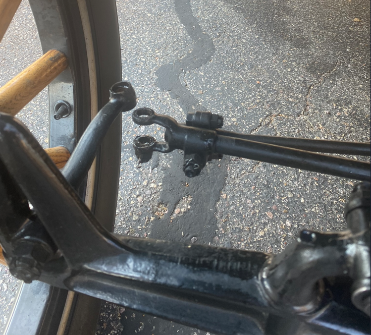

I ran into a guy at the gas station during the MTFCI Tour in Baraboo, WI. He was looking at the front end of his car and looking perplexed. I walked over and saw this. Gave me chills! He said it began to steer kind of funny and he thought he'd better pull into the gas station to check it out. It was a new tie rod bolt, recently installed. Notice, the nut & cotter pin are still there! The threaded end of the bolt remained in place, while the rest of the bolt broke off and fell out. He actually found the broken off end a 1/2 mile back! It tracked well enough to get him to the gas station. As I stated in the subject line, a very lucky guy!
I've told you all I know. I don't know who the owner was, or what supplier he purchased the tie rod bolt from. I can tell you however, the bolt was brand new. The crack occurred just below the edge of the shoulder, at the very first thread. Would love to be able to take a hardness reading!

that is usually due to excessive wear in the top hole. With the threads socked down hard, it's free to wobble, placing strain right at the termination of the thread. With a very close fit as designed even the worst part would be expected to survive. Lucky guy!

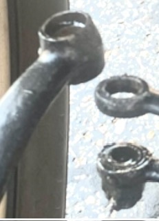

Close-up of that photo shows well worn spindle arm too. Do I see daylight at the rim
And the spindle arm should have a bushing to the top of that arm, all that gap would have fractured any tie rod bolt!

I don't think that's daylight, just a glint of light reflecting off oil/grease sitting on top of the bushing (which appears to be short). It is hard to judge wear based on that photo, but I would be more comfortable if I saw more wear on the top of the yoke. Scary.

Looks like wear pattern of one of those spring things for worn out front ends.

Correct. It's just a reflected light, as you say. Yes, the bushing was short. Don't know why. If it were short on the bottom end, I'd say that may have been a factor. In this case, I'm not so sure about that.robert daniello wrote: ↑Mon Jul 24, 2023 2:52 pmI don't think that's daylight, just a glint of light reflecting off oil/grease sitting on top of the bushing (which appears to be short). It is hard to judge wear based on that photo, but I would be more comfortable if I saw more wear on the top of the yoke. Scary.
While not in a position to closely inspect anything, I will say that the tie rod yoke did not have any wear that was so apparent that I could see it, and I'm usually pretty good spotting stuff like that. Honestly, to my thinking, whatever other wear may have been involved, this bolt should still not have failed as it did. Maybe whoever installed it tightened the living hell out of the lock nut and brought it to within a hare's breath of its yield point???

I wonder what that spindle arm bushing looked like before he put the reproduction tie rod bolt in? In addition, it doesn't hurt to oil them before you go on a tour.

I wish I could see that better. Every part of that spindle arm and cleaves that I am looking at appears to be worn to a unsafe level. If any of that is worn to a point the bolt was wiggling around,it would be easy to see how it would break.
