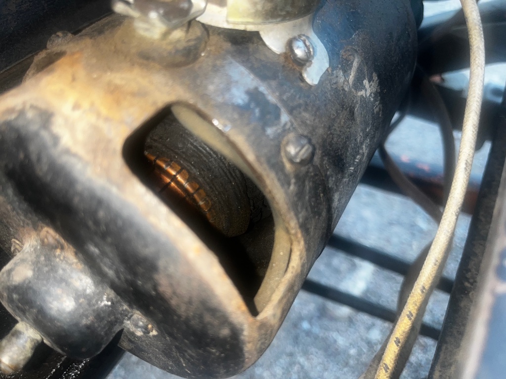

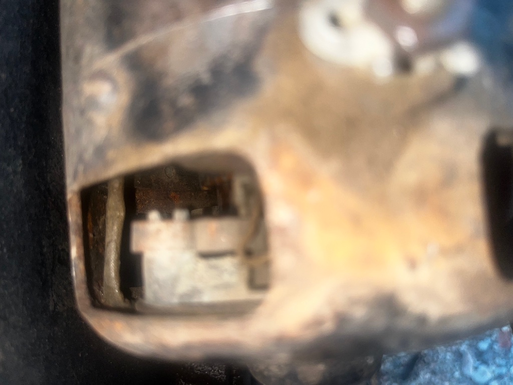

Thank you Jeff. I haven’t had much time to look at the generator this week but last night I pulled off the brush cover and then looked at the brushes and commutator and they look decent. It looks like they both could use a cleaning so I will do that today. Another thing I would like to point out is that the post that connects to the generator is kind of wobbly. Is that an issue?
Thanks, Jacob Mangold

The first thing I would is to clean up the armature. Besides that it’s time to rebuild your generator going by the looks of it. The loose post can’t be good in the long run. Do the simple things first and cleaning up the armature is one of them. It can look like it’s clean but a clean up with fine sandpaper will do wonders.

That rubber insulator at the generator post is probably just as old as the car, where it's dried out and is crumbly. You don't want to have that post ground out on the generator casing. Thinking that the post and the metal washers and the terminal nuts can be cleaned up and reused you can get the rubber insulator, along with the insulating gasket for the post, from Gaslight Auto parts in Ohio. ..... They also have replacement front and rear ball bearing assemblies that are lubricated for life...... .......... If you do change your mind about replacing parts in your generator be sure for total satisfaction if you do purchase a generator make sure it's a total rebuilt generator with new field coils, rewound armature assembly, rebuilt brush holder assembly, permanently lubricated ball bearings, .... Not just something that's been repainted and called rebuilt.

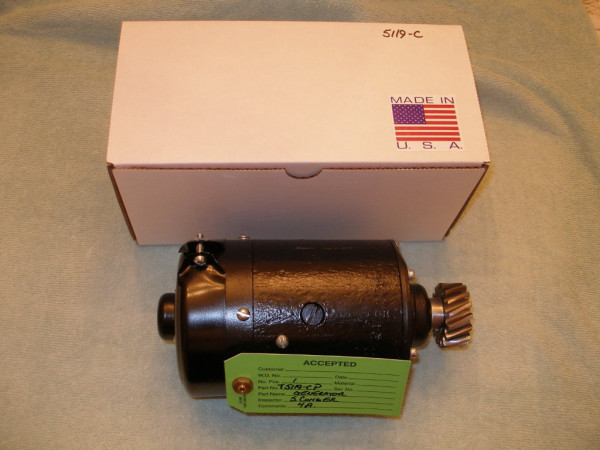

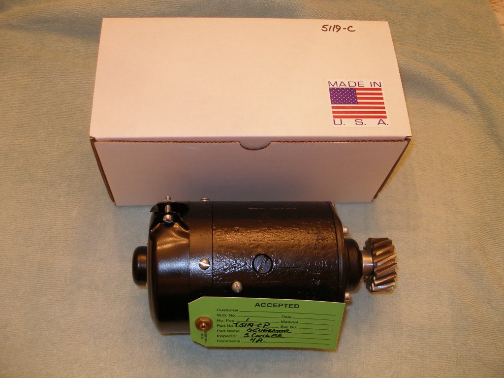

Post by Scott_Conger » Sat Jul 29, 2023 12:23 pm
I hear how horrible they are to rebuild and how temperamental they are, but honestly for the 2 years or so that I was remanufacturing them, there didn't seem to be any mystery or difficulty. If you know how to do the work, you know how to do the work. I don't know air conditioning very well and suppose I'd struggle with fixing one, but for the guy who does it, it's no big deal. Neither are generators, if you know what you're doing. About the only really big "gotcha" is the first time you buy a field coil which was formed backwards and will only operate correctly if you do not have the wires crossed. That will stump you for a good while until you realize it.
I won't do them anymore because not enough folks care enough to keep the car original or seek out people who are competent and can fix what everyone now believes is "unfixable". Spend enough money often enough on Mitsubishi crap, and there in fact won't be anyone left who can or will fix them correctly.
it can be done
but not by me anymore
If Jeff can make it worth his time, then good deal. Spend your money with him and keep the knowledge and the hobby alive.

Post by Scott_Conger » Sat Jul 29, 2023 2:41 pm
Thank you Ed
to get them sold, they had to be priced to the market...I found that I was either too slow or thought too highly of my hourly worth, one or the other, and just couldn't keep doing them. That was early in my "gee, I want to be a supplier to the hobby" phase. I've since realized that to make it worth while, there was no point doing something lots of people could do (at least at that time), and focused on things that almost no one else could or wanted to do.
Since you can't really tell what's inside of one of these things, I always felt that attention to detail was one visible clue to quality - I never wanted a customer to wonder what exactly it was that they were buying
My hat is off to folks who can grind this stuff out day after day - I'm just not wired like that
