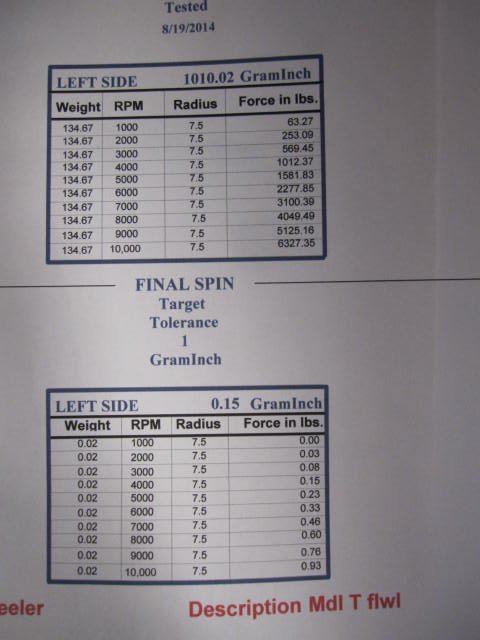

J and M Machine
Posts: 22
Joined: Wed Jan 09, 2019 6:46 pm
Last Name: Gulbankian
Location: Massachusetts
Re: High rpm vibration
Post by J and M Machine » Fri May 17, 2019 6:17 pm
What you are explaining is typical of old engines not being balanced.
We're so used to modern cars and forget what original cars are like.
It can be corrected by balancing the internal engine parts. Rods,pistons crank, flywheel.
Most often when the magnets come off others of random weights are re installed. For example the exchange magnet recharging service offered by some dealers.
They're not weight matching them and even still they would have to be weight matched to the flywheel.
Seeing the orginal commentor's post reminds me of a 1914 engine we rebuilt which I'm sure had been rebuilt numerous times prior to landing here.
Flywheel was so far off, I had to do some heavy metal removal to make it balance.
This particular flywheel assembly was off a total of 1000 grams. Which left unchecked would of done some damage.
If you'll notice two drilled holes removing weight which I've balanced flywheel assembly to tenth of a gram. Making it a smooth running engine.
