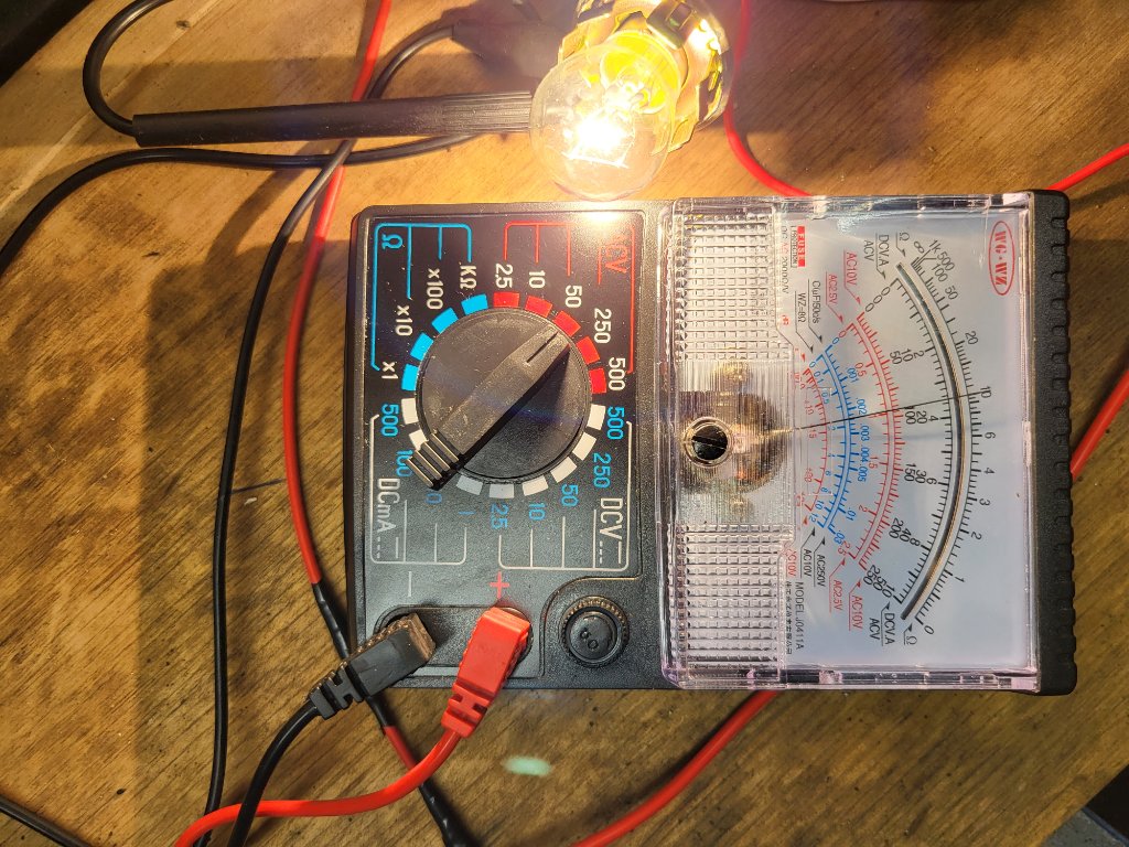

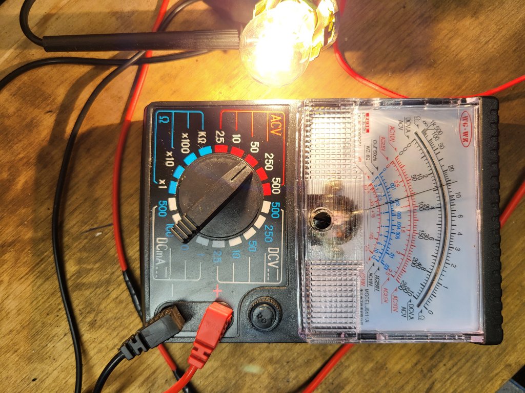

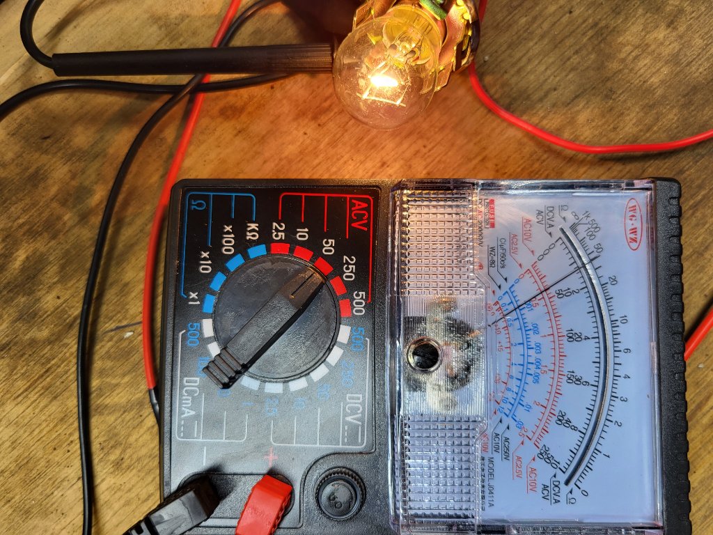

Following all the instructions with the light bulb and analog meter etc. but not comfortable with this meter yet so not sure if I'm reading it correctly.
Please help.
I think I'm seeing 8v @ idle, 16v moderate rpm, 19 fastest rpm.
Sorry about the orientation but it's the only way they would load.
Please help.
- Posts: 6800
Re: Magneto Test
pretty much, yep.

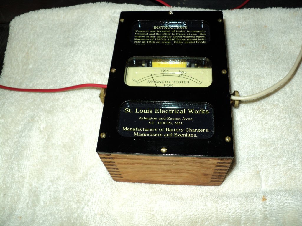

Your 1156 bulb/AC voltmeter Model T magneto test results reflect a puny magneto output.
When I see this type results where the output voltage does not meet or exceed 30 volts at higher RPM I know you need a more comprehensive check
The "Gold Standard" for comprehensive magneto testing that requires no interpretation to determine the "Health" of your magneto is the St Louis Magneto Tesster. It evaluates the magneto results in a different manner and is a go/no go magneto health test.
I suggest find someone who has a St Louis tester, take the readings again and report back as shown in the attyached photo. That wasy we will lnow for sure the health of your Model T magneto.
Ron Patterson
