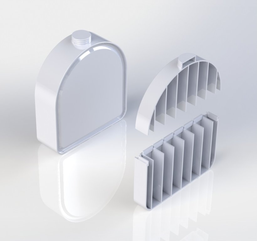

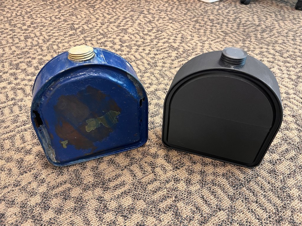

Hello everyone,
I decided to repaint some Boyco cans that I have, and once getting into them found that they were in pretty terrible shape (completely rusted through on one side). Since finding a replacement proved both difficult and prohibitively expensive and I do not have the skill to fix them properly yet, a friend and I made 3D-printed replicas. If anyone is interested in the STL and STEP files, I have them on Google drive here (https://drive.google.com/drive/folders/ ... drive_link). They print in two separate pieces and can be super glued together. They don't work as functioning cans, but they but they should look pretty good once painted and finished. If anyone wanted the accessory just for looks and hasn't found any at a reasonable price, this could be a good alternative.

What do/did you do for a cap? Is it a separate piece, or is it a non-removable/non-functional part of the two sides?

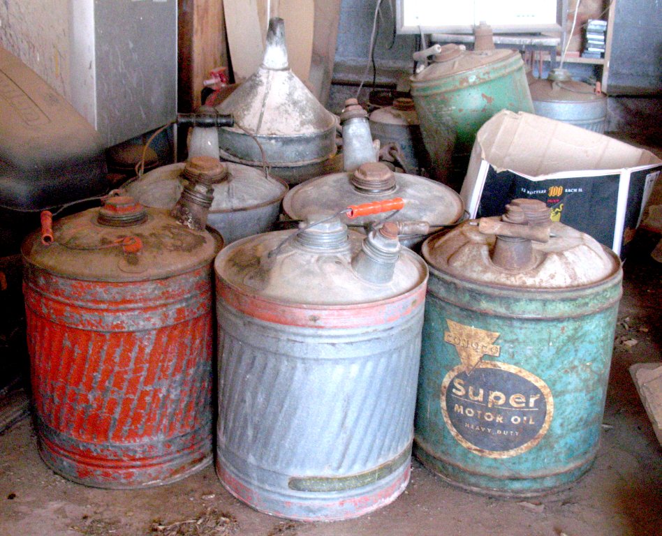

Just for appearance, a repo like this is great. If you do much driving, especially on trips, you want a functioning can or cans. But as most of us have found, original cans are scarce and expensive. I was extremely lucky to find three original Boyco cans at auction for $2 to $3 each. They are a little oversized for a Model T, but making a carrier to keep them on the running board was pretty easy. But I don't expect to ever find a deal like that again, and you're not likely to either. So what is a good alternative?
I see these five gallon cans turn up at estate sales and farm auctions quite often. They frequently sell for $5 or less. The ones with plastic handles and post-1930 brands are not appropriate but I think the generic ones with wooden handles would fit the bill nicely. I often see kerosene cans (similar but two or three gallons) also at auctions.

Terry:
There is no removable cap, it's a solid piece that attempts to look like one (from a few feet away, at least). The modeled picture is just showing a cross section of the internal structure. The model actually prints as a single bottom half and a single top half that fit together; much easier to align and assemble than gluing two vertical halves together.
I may consider fixing them some day to have functional cans, but for now my T has an enormous storage compartment that I can already fit extra gas/water in, if needed. Perhaps making reproduction Boyco cans will be my contribution to the collective hobby one day, but as I have a long way to go in life before I can invest that kind of free time, I'm afraid that day may come when the demand for cans has become zero (or close to it).
Terry:

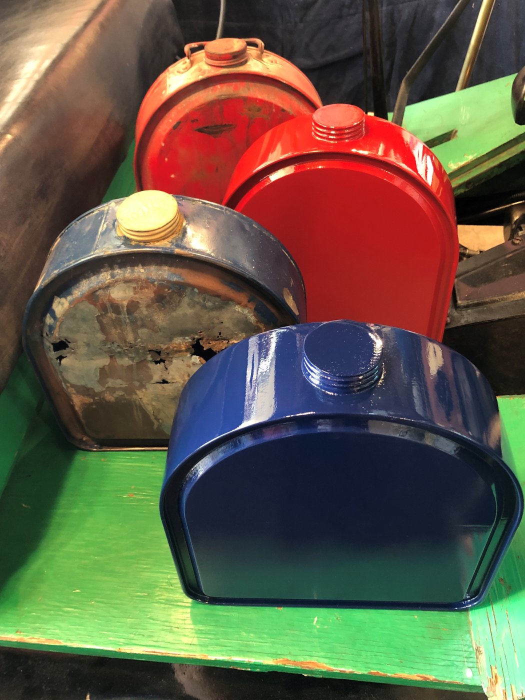

Re: Boyco Running Board Can Replica
Finished "cans," complete with 5 foot paint job.
- Posts: 7401
Those look great. I hope eventually you or somebody will be able to produce functional metal reproductions. I expect the main obstacle there would be tooling to press the parts that need pressing, and necks and lids of the right size. If they could be produced and sold for significantly less than the going price of originals, I think there would be a market for them for a long, long time.
