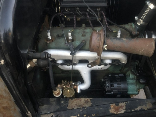

We, as in Australia do have a con, it is just wide enough that it has to be removed to get the generator out with the RHD steering in the way. :x

Only slight con.....at least on my install of the hi-vol intake. The intake flange rim is a bit larger than Ford intake, and with a repro exhaust manifold the hi-vol intake impinged on the underside of the exhaust manifold.
Had to grind off a flat on the top side of the alum hi-vol intake flange rim to nest up, otherwise the intake won't seat on its gaskets squarely.
(New intake powder-coated, and new exhaust manifolds)

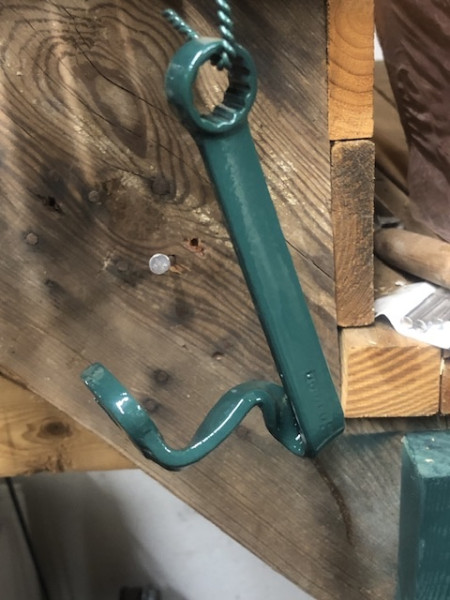

I added one when I swapped my vaporizer for a stromberg. The only fit and finish problem I had was the throat casting width at the bottom flange was a little too wide to clear a socket on the mounting bolts. One side cleared the bolt but the bolt on the other side scrubbed the side of the casting. On the plus side, I made a neat wrench with literally only one use! Between the new high compression head, carb and manifold, my coupe runs like a scalded cat.

Nice wrench!
