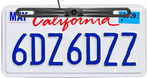

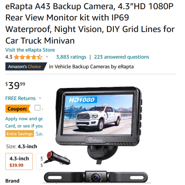

This one had a good review above and the price is a no brainer https://www.amazon.com/gp/product/B07ZW ... s_li_ss_tl
Also be aware that covering up information (state, expiration date) on the license plate will get you pulled over. Not necessarily to get a ticket.
