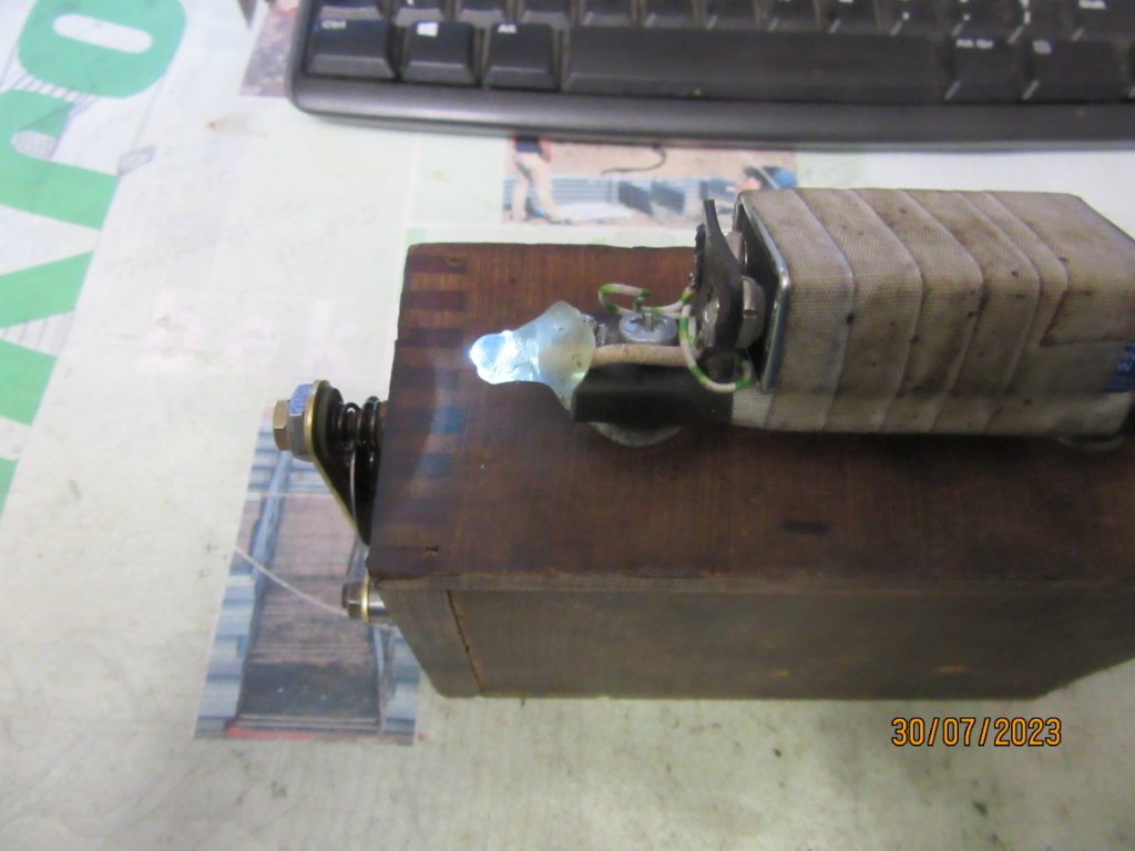

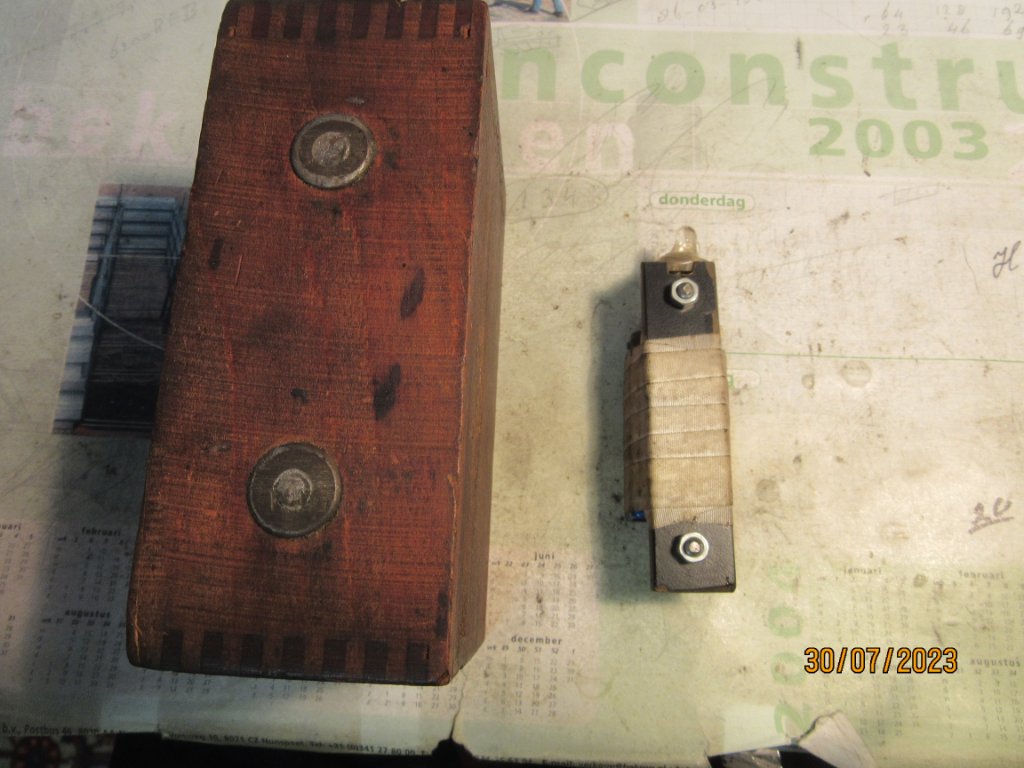

Glay ,I got this from a club member .
When the lamp goes on , then I know that the sec . winding is OK .
Toon
Toon

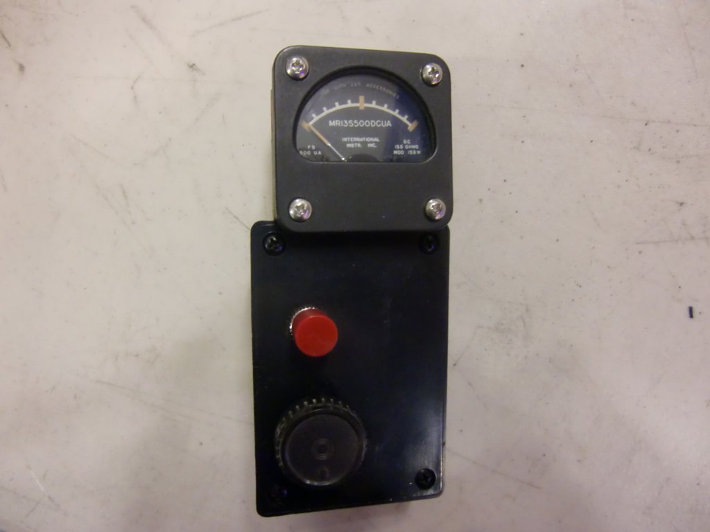

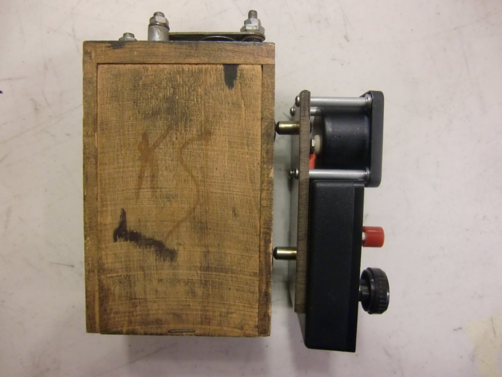

Here is my version of a coil tester.
It is calibrated to read 1/2 of full scale when it sees 3500 Ohms in the secondary.
I take it to all swap meets.
