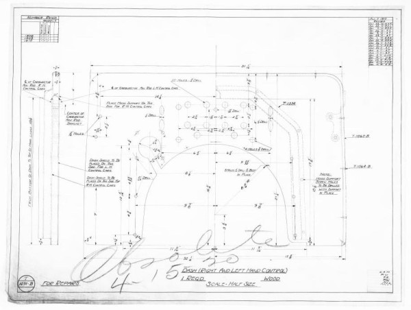

I have a drawing for an earlier firewall that id like to use to make my 1914 touring conversion from.
My (pickup's) firewall is square but I'm wondering if it should be slightly tapered toward the top as the 1911 print shows? there is no telling what replacement/repairs have been made on this beauty.
I plan on using the print dimensions where I can while checking them with what is currently on the "T"
Just a little disappointed that the archived technical information isn't free to access
My first post so sorry and thanks
Vincent
Vincent

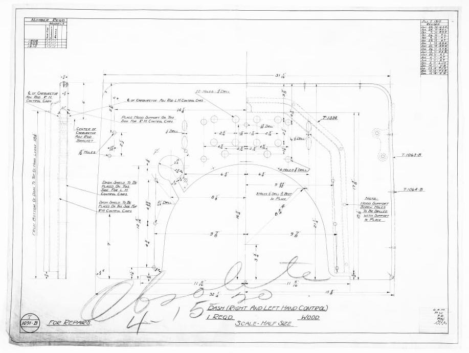

Re: Firewall
so I want to make this but with the top corners squared off, I think Im going to add the slight taper to the sides just because I like it. I will have to review the other features as this thing progresses. The trim is missing on one side so I will have to fab that then its going to get blacked
- Posts: 6790
Re: Firewall
go slow
that is for a different car - an earlier 1915
knowing that, just be sure of what you want before you cut - and yes, as a minimum you want square corners on top to look close to a correct '14
and among other things be sure to understand what the drawing is showing for carb controls...there is actually but one slot, not two
also, study your body carefully - the firewall you posted fits INSIDE the body/trim covering and a '14 goes OUTSIDE the body, so whether or not you want a taper, a taper may not in fact work with the body - just saying - and remember, you have a windshield to fit on top and even if you are able to taper AND fit the body, it may look quite odd with the windshield installed. Baltic birch is pretty spendy these days and not always easily available...I'd be tempted to cut and fit a cheap template before I committed to making sawdust.

Great advice Scott,Scott_Conger wrote: ↑Mon Jul 31, 2023 5:27 pmgo slow
I just picked up the lumber, true 3/4 ply and 12 board feet of
white oak $182 not cheap but not thousands either

There is another aspect to this I found out the hard way...
Different body manufacturers used different parts - not HUGELY different, but enough to where some will not work on others without some hand fitting.
Ny '15 Fisher body had this issue - someone put the right rear door off a Beaudette - same year, same body style, and by all rights you would hink i would match, right? I fought it for years as it wasn't close. The door barely closed, there was a huge oblong gap between the lower front corner and the body, the top of the door was flush with the top of the body, and the latch locked but that was about it. I took the cover off the inside of the door - all the wood was good and tight and snug,
What made it worse I thought the "F" in the body number stood for "Ford", so I couldn't find any info on it, not knowing Fisher was making a LOT of the bodies for Ford at that point. Add to this - by 1915, Ford was putting out (compared to everything produced before) a formerly unseen (and insane) amount of cars, so bodies were coming from all over to go on all these shiny new Ford chassis... half a million cars in a year. That's a LOT!!!!
Just be aware of it going in. IF you have an original to the cowling etc (even if it's bad) it is well worth making a cardboard or cheapy plywood or hardboard pattern of the original, so when you get your new one (or the blank to make your own) you can make the small corrections so it actually FITS your cowling.
- Posts: 4407
Re: Firewall
The 1911, 1914, and 1915 firewalls are all very different from each other!
A major change was made in early to mid 1912 model year (beginning of 1912 calendar year!). While the 1911 and 1914 firewalls will more or less interchange and function, they are quite different for aesthetic and cost reasons. Model Ts of that era are to a great extent identified by that firewall difference.
It would help us to know what sort of a model T pickup you have in mind. A "cutdown" factory body would almost always have used an original type firewall on the car as a pickup. Many after-market bodied pickups also used the factory firewall appropriate for its year of manufacture. However Some after-market bodied pickups did have special firewalls incorporated into the body for a variety of reasons.
The 1915 firewall is an entirely different design, and much smaller than all that came before it. That smaller firewall was fit into a pressed steel cowling/hood former piece which in turn attached to the cowling of the standard For body of those years.
Sometimes, 1915 commercial chassis were sold with the earlier 1913/'14 firewall installed. Sometimes they were sold with the standard smaller 1915 firewall and hood former, and then attached to whatever style front panel desired by the body builder or buyer.
The thickness of the 1915 firewall changed midyear 1915, it was made thinner by a small amount.
Good luck with your project!
