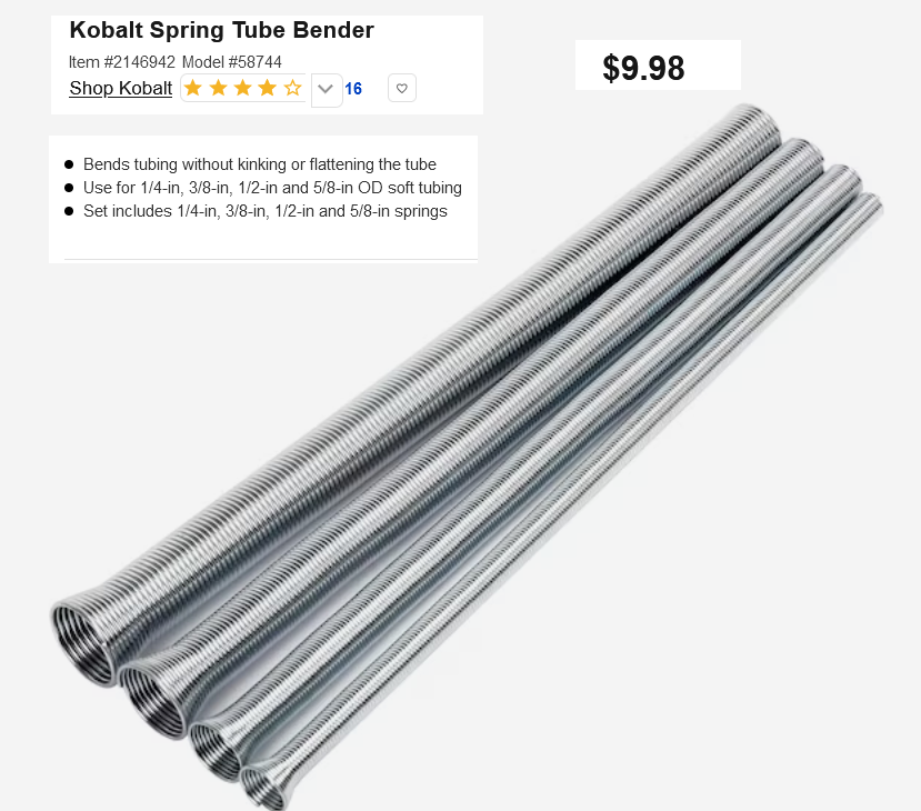

These make tube bending easier and prevent kinking the tube. Not as popular as they used to be to bend the supply lines to sink faucets.
slip on - slip off
slip on - slip off
