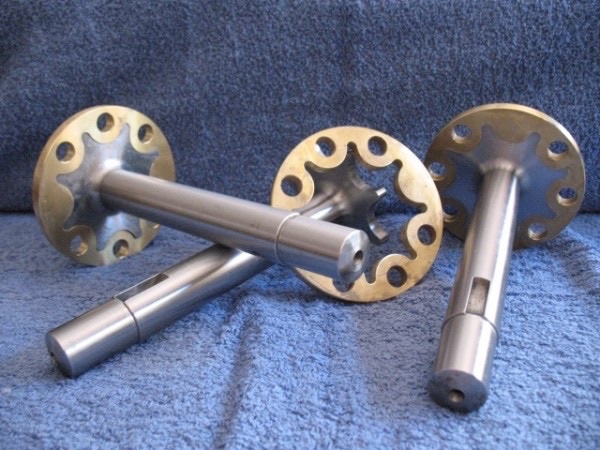

At one time there was a solution available to ease the concerns about the 4 dip pan flex and those people who have installed it have had great success. Unfortunately it is no longer available. I’m referring to the “floating transmission shaft”. It removed the strain load from the crankshaft. But hey cranks are cheap.
- Posts: 5544
- Last Name: Hatch
- Location: Alabama
Re: 23 tranny on a 26 block?
Floating transmission shaft
Paperman
- Posts: 48
- Joined: Fri Jan 27, 2023 2:17 pm
- First Name: Robert
- Last Name: Kesling
- * REQUIRED* Type and Year of Model Ts owned: 1927 Tudor
- Location: Michigan
Is there a reason the floating shaft went away? Was it simply a cost issue?

Thanks, Dan... I remember these floating shafts, and I've never heard of anyone who used one complaining.
