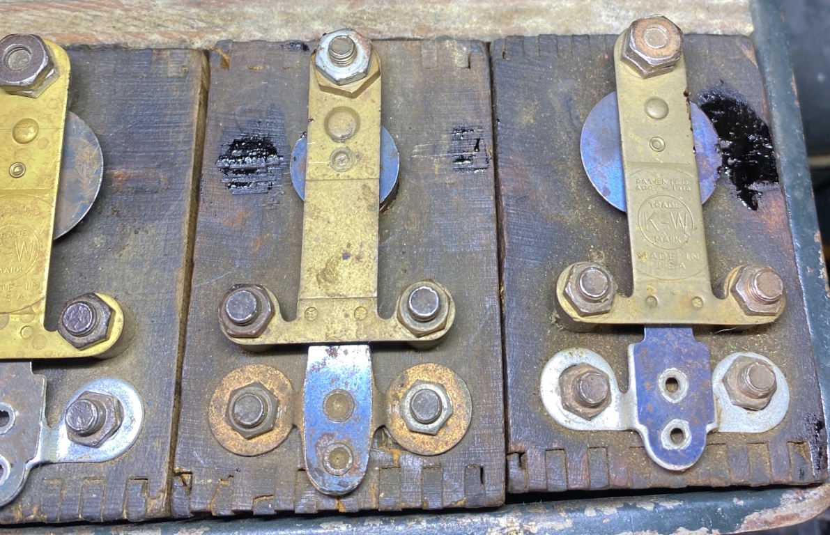

New to model T’s and have noticed some tar spots on top of 2 coils in my T. Is this something I should be concerned about?
- Posts: 8658
Re: Tar on top of coil question
Maybe.
It could indicate that the coils are overheating due to poor adjustment, sticking points, or being allowed to buzz for extended periods of time. A shorted capacitor might also cause overheating. (?) A few other, less likely conditions could cause overheating.
If your engine runs really well and your coil points and timer don't give trouble, the coils are probably OK.
Coils work best when run on the magneto.

Thanks. My magneto isn’t working. I run on 12 volts. Will get my coils serviced so I know they are good to go.
Moxie26
- Posts: 2068
- First Name: Robert
- Last Name: Jablonski
- Location: New Jersey
Jim ... Locally, is there someone in your Long Island chapter that could help you with your coils ? .... Overheated coil tar usually expands out the top opening of the primary coil under the vibrator. The glossy tar like smudges on top coil wood seem to be applied, not originating from internal Hot tar. Whoever you send, will check secondary coil electrical integrity around 3,200 ohms making that unit eligible for rebuilding...... Your magneto can be recharged to provide power to your ignition system as Ford intended separate from the battery powered source.

Thanks Robert. I agree in looking at them it does not seem to be coming out of the coil box. I did run them on a friends ECCT tester today. Caps were good but other tests were poor or good. I have ordered an etimer so I don’t think the coils will need rebuilding as long as the windings are working. In the meantime I developed a carburetor issue with leaking fuel. Float bubbled in the hot water test. Will be installing a new float and needle valve and seat. My friend lent me 4 good coils to get it running in the meantime. Once I get it running again I will install the etimer and try my coils with the resistor shunts installed and see how it runs.Moxie26 wrote: ↑Tue Aug 08, 2023 7:36 amJim ... Locally, is there someone in your Long Island chapter that could help you with your coils ? .... Overheated coil tar usually expands out the top opening of the primary coil under the vibrator. The glossy tar like smudges on top coil wood seem to be applied, not originating from internal Hot tar. Whoever you send, will check secondary coil electrical integrity around 3,200 ohms making that unit eligible for rebuilding...... Your magneto can be recharged to provide power to your ignition system as Ford intended separate from the battery powered source.

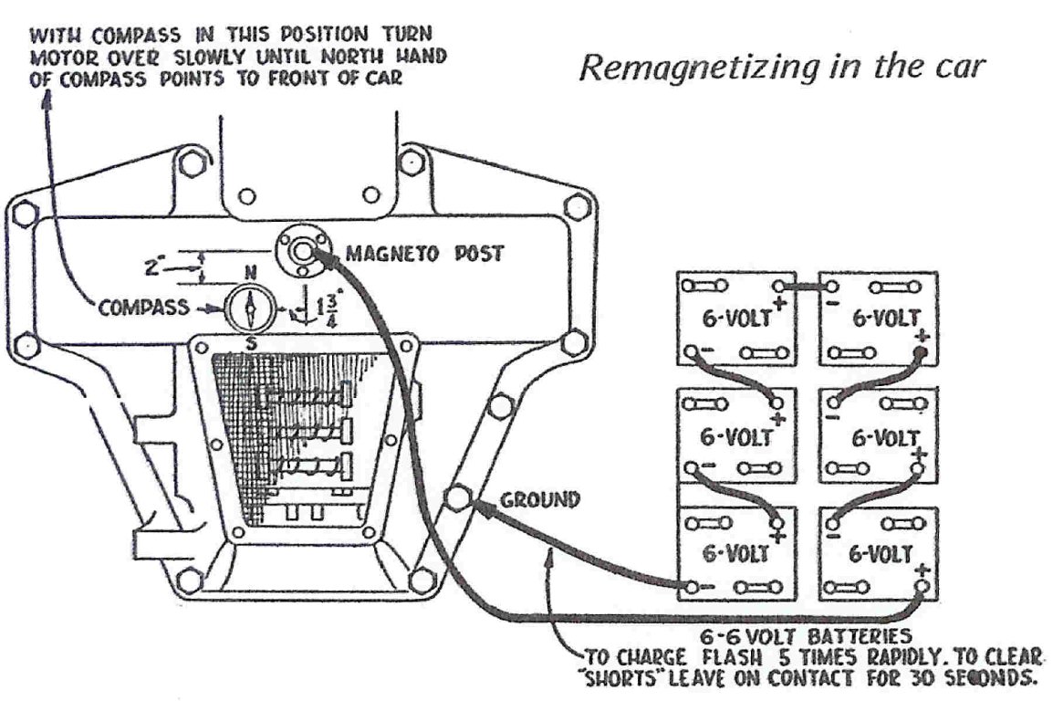

Jim, if you decide to do an in-car magneto re-magnetizing, the drawing that Robert posted is very helpful. But search the forum posts for the specific procedure to ensure success. Just connecting wires as shown will not work. Also, that drawing is old and deceiving. The centerline of the compass should be 1 ¾” to the left of the post, not the edge of the compass.
I’m hoping that you discover a simpler reason for a non-functioning magneto. I went through the same problem in my Runabout. I eventually used a borescope to see that my magneto ring has no coils on it. In fact, the top of my magneto ring is missing! Good luck.

Mark;.. check the picture for dimensions again please.... . The pointer of the compass is positioned over the south magnet pole when the magnet pole is in the center of the oval coil winding on the magneto frame..., All in reference to the position of the magneto terminal that Ford installed. ... ... Three 12 volt batteries can be connected instead of six 6 volt batteries using 2/0 size short battery jumpers, along with corresponding size jumper cable to the magneto post while flashing to the frame with the negative.
Mark Nunn
- Posts: 1290
- Last Name: Nunn
- Location: Bennington, NE
I understand the concept, Robert. I don't have first-hand experience with this process. I only know what I've read on this forum. My comment about the 1 3/4" dimension was also mentioned by others in the past. If I have a 3/4" diameter compass and you have a 2" diameter compass, our pointer positions will differ by 5/8". Which is right? I don't know, maybe neither. I must defer to others who have done the procedure. I apologize if my comments have added unnecessary confusion.

Ron Patterson's response from the Carnegie magneto charging posting ..... "The purpose of the "compass thing" is to ensure you are recharging the magnets in the same magnetic orientation as they were originally charged.
Certainly the in car recharge will work, but recharging the magnets in the opposite direction from original with a less than optimum ampere turn source/distance is not a wise thing to do.
Ron the Coilman "
Ron the Coilman "
