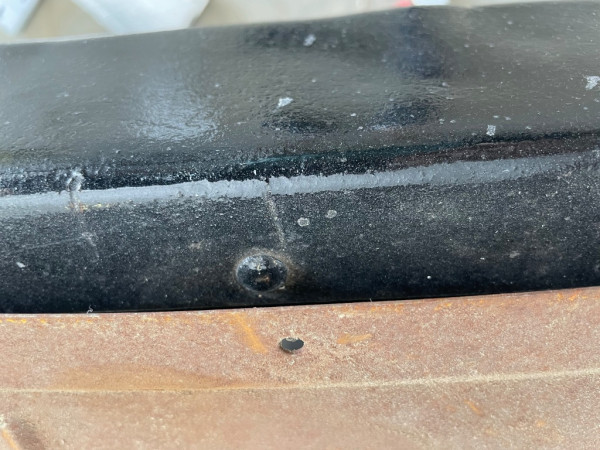

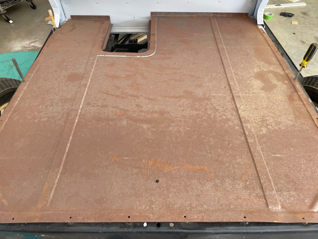

Converting a 26-27 roadster over to a pickup. I got a bunch of free Howells sheet metal panels early on in the restoration and have used most of them up patch paneling and such, but I noticed the other day I still have the trunk floor sitting out in the storage shed. Is there some advantage/disadvantage to putting the floor in even though there’ll be truck bed wood there? Keeps road stuff from slopping up on the bottom of the bed boards? Keeps muffler heat off them? Just another thing to rust when water sits on it with the wood bed boards above it? Makes it any easier to fit the boards and/or battery box top on? I reckon all the frame rivets have to be removed and then redone to fasten the floor to the body subframe…at least they all line up fairly well. Also, what thread pitch/bolt size goes in the radiator apron below the crank hole?

So ya reckon Henry saved a buck by not putting them in at assembly like it was going to be a roadster and didn’t just slap beds on completed roadster frames? I’ve got a spring hump for this floor. I guess all those folks who had roadsters and converted them in the late 20’s took out their floors? Seems like it would make things a little more rigid back there too. Not arguing, just thinking out loud!

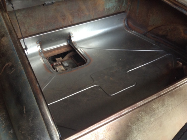

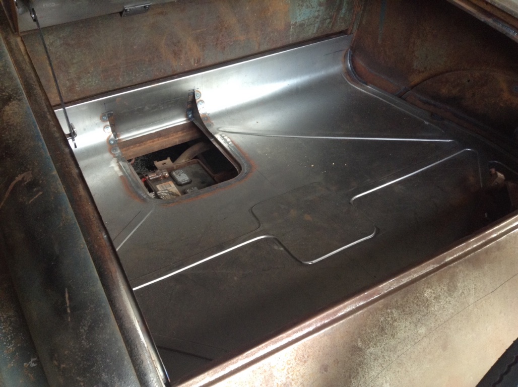

The trunk floor was attached to the trunk only in later ‘27. The ‘26 and early ‘27 floor as seen above was attached to the sub rails. Here is a shot of the late ‘27 trunk floor. Certainly would make swapping the trunk for the pickup bed far more streamline…?

Is this for me and the flat floor pictured? I’d hate to think what shipping would be on a piece this big in order to get it somewhere not all bent up! I guess UPS would wrap it successfully….

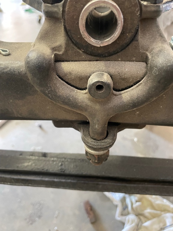

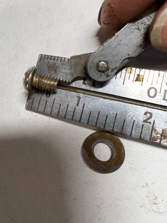

Any opinions on the size/thread pitch on the radiator apron screw on the front spring perch?

Post by KBurket » Tue Aug 08, 2023 10:48 pm
Radiator apron screw. Flat head, 20 TPI, 1/4” dia, mines only 1/2” long. Flat washer.
Langs sells them for a quarter (plus shipping). https://www.modeltford.com/item/3977EMB.aspx
