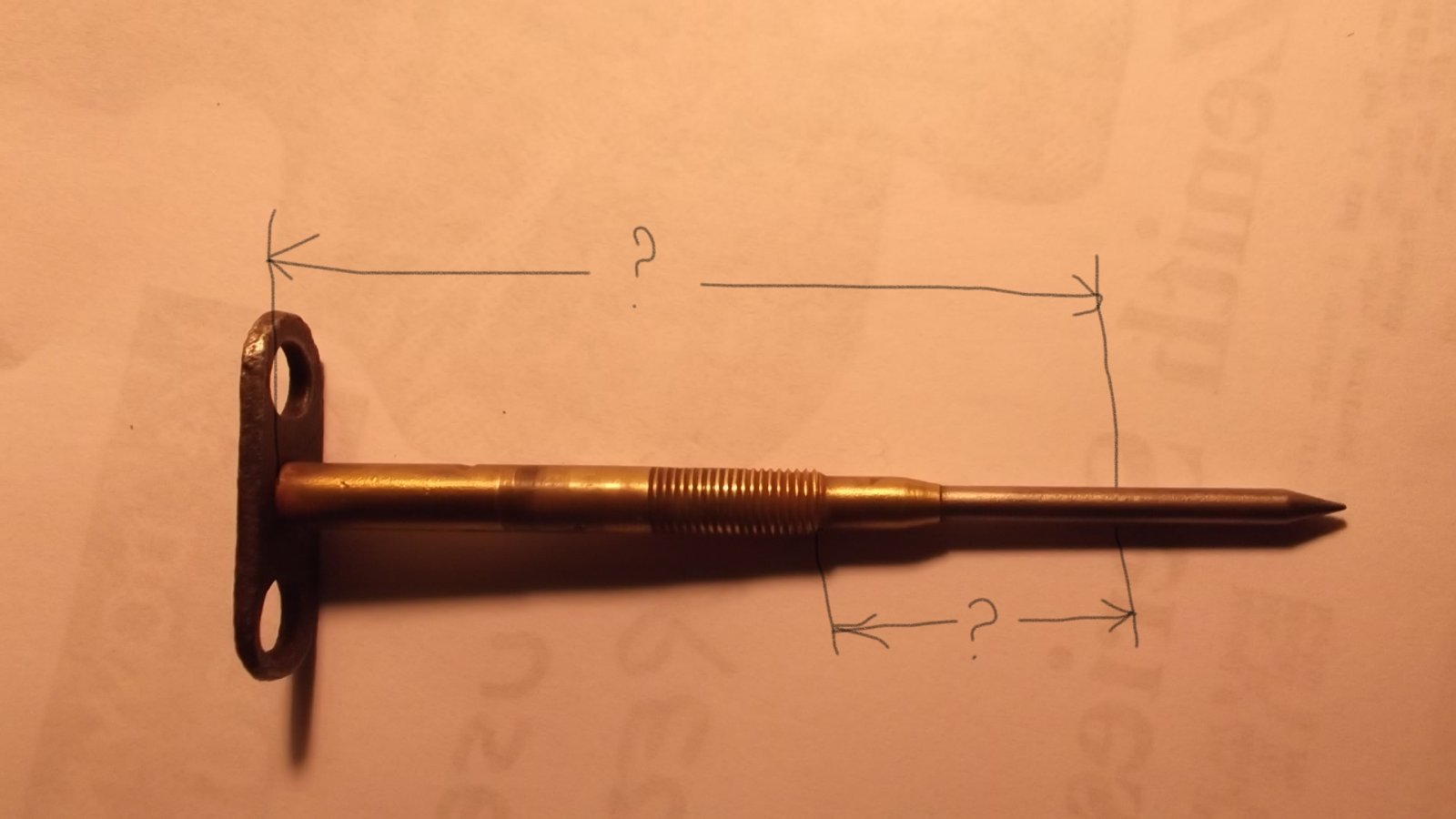

Anyone know the correct length of the spray needle valve for the Simmons type carburetor? Need to trim back a NH needle to use.

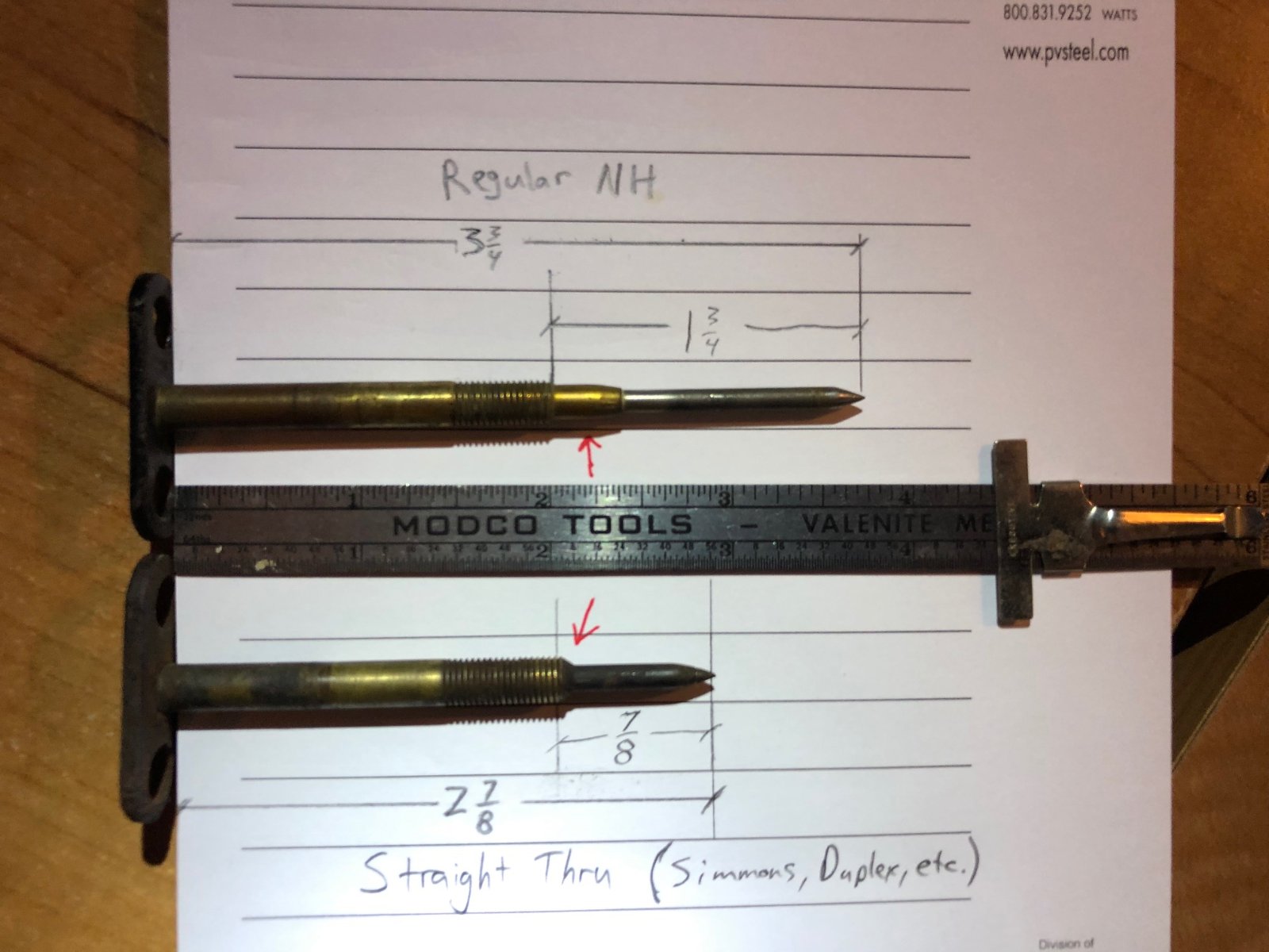

Re: Length Simmons spray needle valve
Also notice the small difference in the brass rod below the threads.
It probably doesn't matter much, but something to keep in mind.
Topic author - Posts: 5480
Thank you! Don't know if the little bit of brass will be an issue, but as it is part of the crimp that keep the parts together I think I will leave it.
