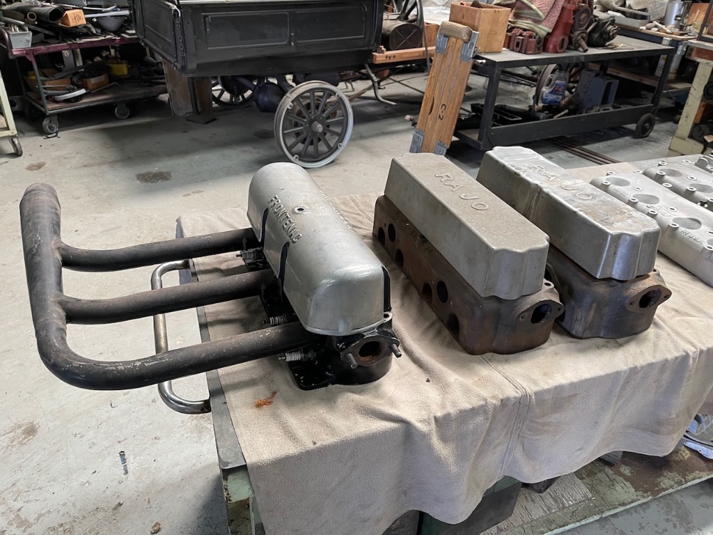

The valve action is mesmerizing and it sounds great. Donnie, if I recall, did you install some kind of fancy tail pipe system on your speedster? If so, how does that sound?
I am also very jealous. I need an excellent fast T engine builder in Northern California or the West Coast to help me make MY own YouTube video. Here is what I have to work with.
Tom

Post by RajoRacer » Wed Aug 09, 2023 8:30 pm
Erik Barrett in Auburn should be able to assist - he likes "go fast" stuff !!!

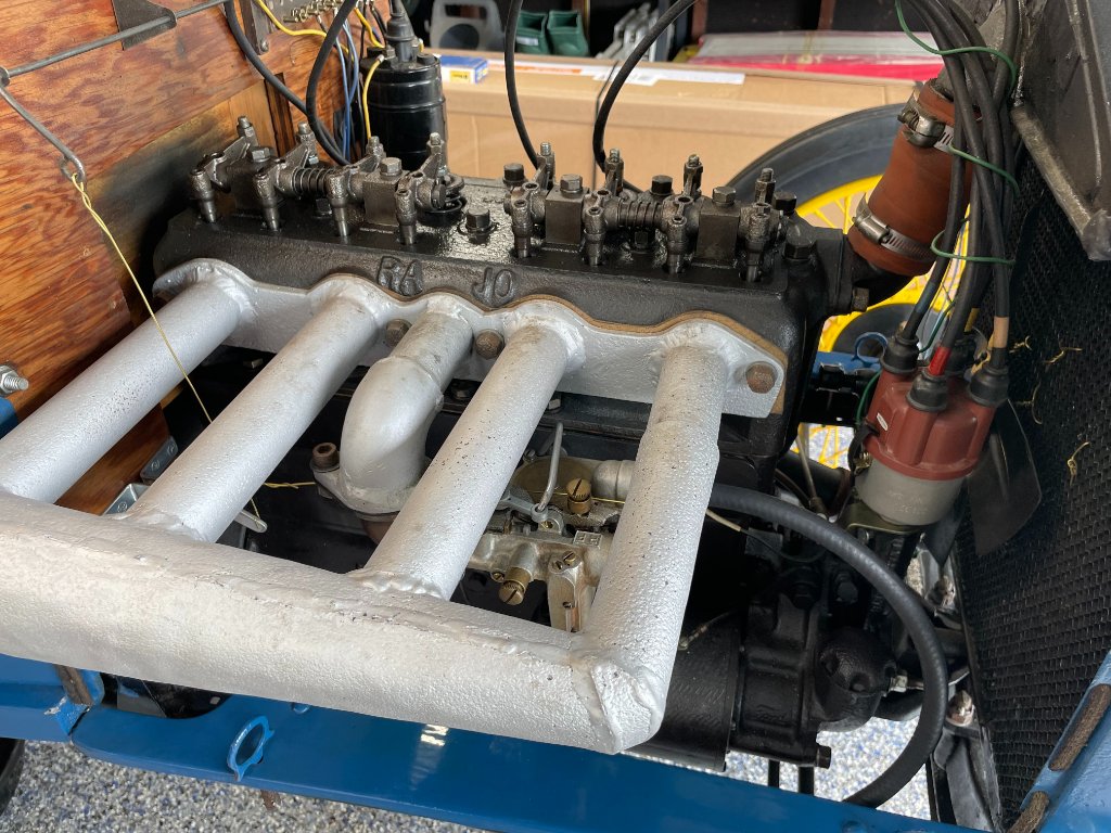

Regarding your crankshaft; did you install a new/upgraded crank, of is it an original? I've always been a tad concerned about adding horsepower to my engine (have a Rajo Model 30 with a Stromberg RF) with the original crank. Don't want to push it too much and join the "broken crank club".

Post by dobro1956 » Wed Aug 09, 2023 9:17 pm
My engine had an EE crank in it. It was in good shape with fairly fresh babbitt. So I left it. I was trying to stay with a period correct, as could have been built back then, type of build. I also tried to use used parts from my stash of parts to build the engine. I think it will hold up well as long as I try and keep the RPMs down.

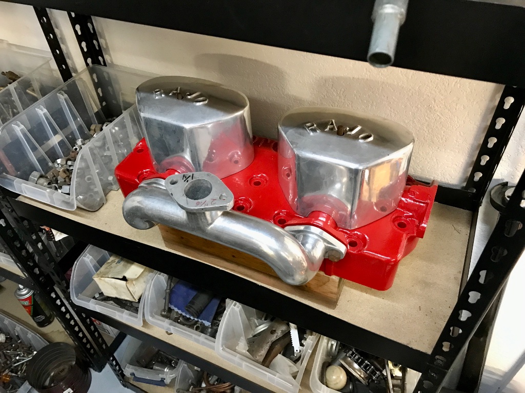

Nice. I have a Rajo 4 Valve sitting on my shelf.

Post by dobro1956 » Wed Aug 09, 2023 9:29 pm
Three pedal. Very Nice. If you use it I highly suggest to change the two separate rocker shafts to a single rocker shaft. I switched to an original rocker cover. Originally they had the one piece rocker shaft. The two separate shafts are for use with the two separate rocker covers instead of the one piece cover. With the two shafts the rocker towers wiggle and will eventually will fail.
