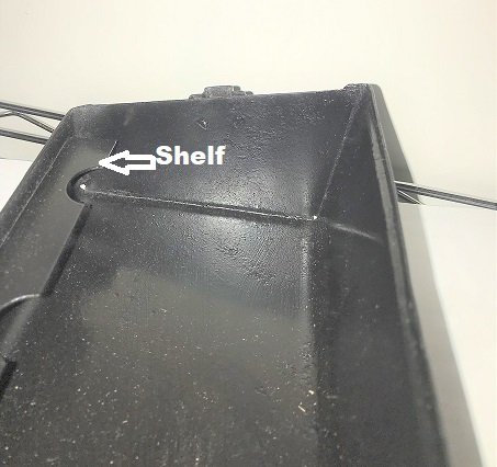

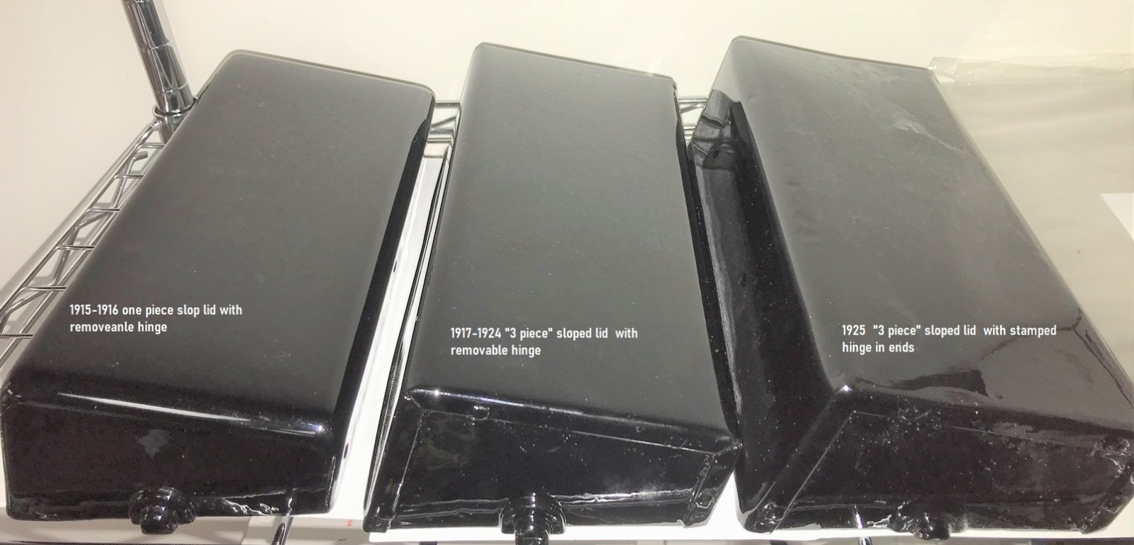

The differences in construction also allude to price the early one piece version is quite expensive ($122.95) but the best repro. There were issues with the 1925 style reproductions with spot welded ends that caused the lid to have a warp. I don't think these are offered anymore. Also make sure the lid you get has the shelf as it secures the coil units from moving and losing contactsFlyingpiper59 wrote: ↑Mon Aug 14, 2023 6:39 pmAsking for a friend, does anyone know if you can get an aftermarket top for a 25 coil box…..or used?
Many thanks in advance
Click on pictures to enlarge
Left: 1915-16 One piece lid with removable hinge
Middle: 1917-1924 "3 piece" lid with removable hinge
Right : 1925 "3 piece" lid with stamped hinge --

The 25 lid is identified by the upper latches that are formed into the side panels, as opposed to the earlier latches that are tabbed into slots cut into the side panels. Those tabs are bent in to attach the latch to the side panel. (see the picture of the 3 different slanted coil box lids)TRDxB2 wrote: ↑Wed Aug 16, 2023 1:23 pmCan you please tell me where the part number was stamped on the lid (top , back, shelf) & Ford script which sid panel was stamped with it (left or right facing the front), I'll update some pictures I have and add to this discussion. Maybe too the Vowell Art image can be updated too. thanksOriginal Smith wrote: ↑Tue Aug 15, 2023 12:47 pm1925 Coil box lids differ from the earlier ones in that the catch for the snap is not separate any more. That part was stamped into the lid prior to the assembly of the lid.
