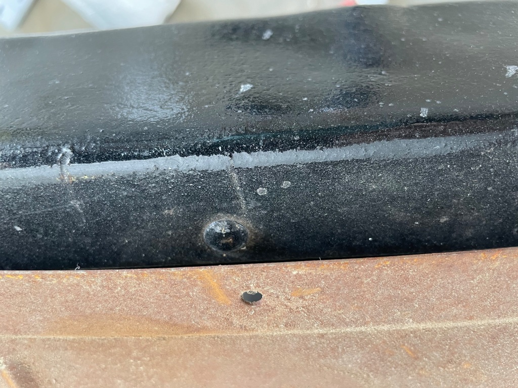

The trunk floor was attached to the trunk only in later ‘27. The ‘26 and early ‘27 floor as seen above was attached to the sub rails. Here is a shot of the late ‘27 trunk floor. Certainly would make swapping the trunk for the pickup bed far more streamline…?
