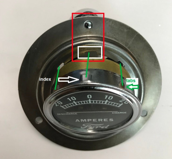

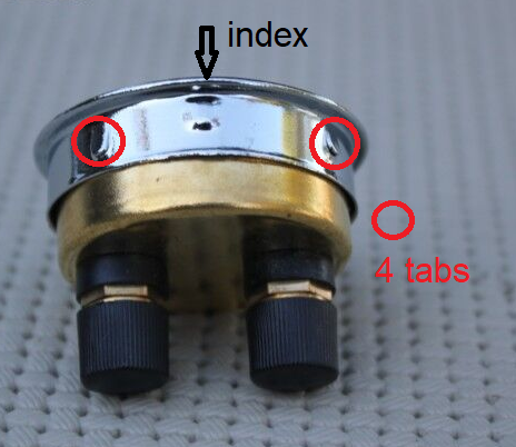

The "improved model" ammeter has dog ears around the bezel that allow you to press it into the front of the adapter ring (same as you would for the oval ignition switch) and then tabs are bent to hold it into position. An then place the adapter into the switch plate. What you may have overlooked is how things are indexed to be up right when done.
Small ammeter
small bezel tabs.png (234.04 KiB) Viewed 818 times
Align the ammeter back with the adapter plate front. Note the top hole is the only one with a slot (for the index on the amp) directly below it, Then secure the tabs to hold the ammeter in place by bending. Suggest about 45 degrees so you don't break them off

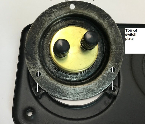

Now position the adapter plate 3 holes with the back of the switch plate. The hols are offset so there is only one way to do this. Be careful when tightening the screws to hold the adapter plate. If to long they will dent the front of the switch plate

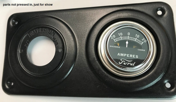

Finish... just have every thing loose in the photo

Thank you, I found the tabs! They were nearly flush with the case, so I didn't notice them before. :)
