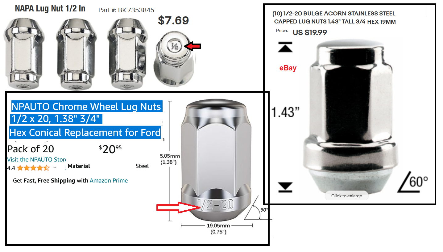

- Posts: 6581
Re: Repro LUG NUTS
There was an issue reported on repro lug nuts that the thread depth wasn't deep enough for proper tightening
I don't have the dimensions (length) of an original lug nut but the round flat cap was barely protruding above the hex portion of the nut
original nut --
repro choices NOTE: some repro's have the size engraved on the nut side, top or rim so check it out
original nut --

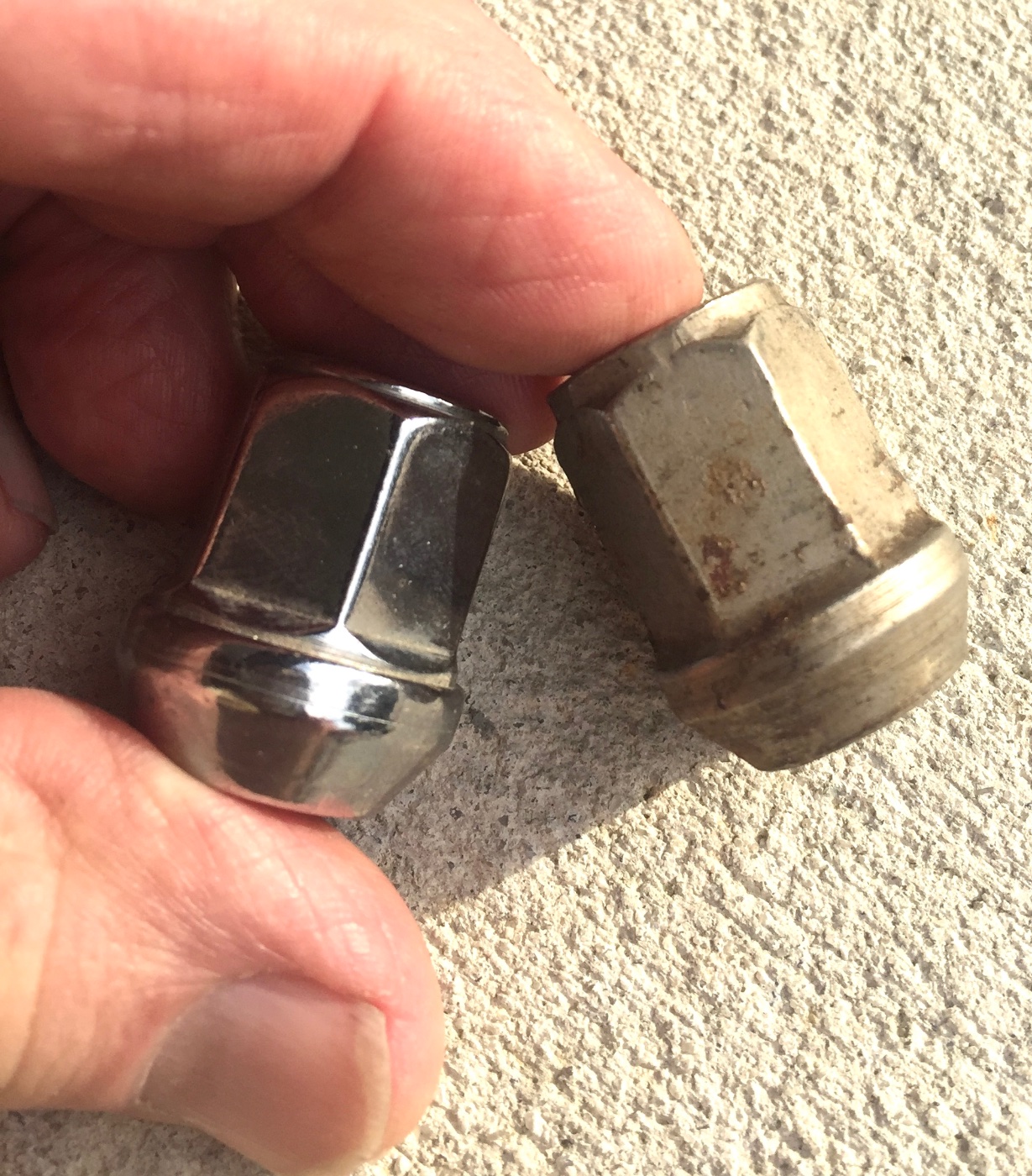

- Posts: 4084
Re: Repro LUG NUTS
Original on right, repro on left.

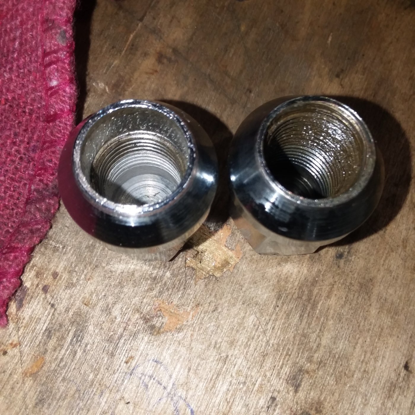

Professor Fate
Topic author - Posts: 773
- Last Name: S
- Location: Taxachusetts
Re: Repro LUG NUTS
Both repro. Both failed to torque down.
________________
**FATE**
**FATE**
- Posts: 6581
Re: Repro LUG NUTS
Looks like the repro threads were expecting a longer stud bolt. The threads on the original look suspect. They don't look stripped just not able to do the job based on their conditionProfessor Fate wrote: ↑Sun Aug 13, 2023 10:36 pmBoth repro. Both failed to torque down.20230813_200213.jpg
Professor Fate
- Last Name: S
Re: Repro LUG NUTS
You wrote...
".....The threads on the original look suspect."
Both lug nuts in the pic i posted are aftermarket reproduction. No original pictured. Pic shows
Inconsistent manufacturing and quality control on inferior product.

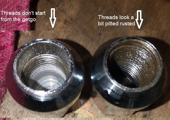

- Posts: 5545
Re: Repro LUG NUTS
The Model A lug nut, the threaded area didn't start at the get-go. The opening at the bottom was little larger and clear of thread so it could clear the swedging where the lug bolt came through the drum/hub, but not as deep as shown in the first sample in photo directly above. The original Model T might have that same clear area.
What was found is some reproductions with thread the full length were fowling on the swedged area before fully seating so were not correctly holding the wheel.
Professor Fate
- Last Name: S
Re: Repro LUG NUTS
I cleaned a lot of debris from the lug nut off the threads of the stud.
