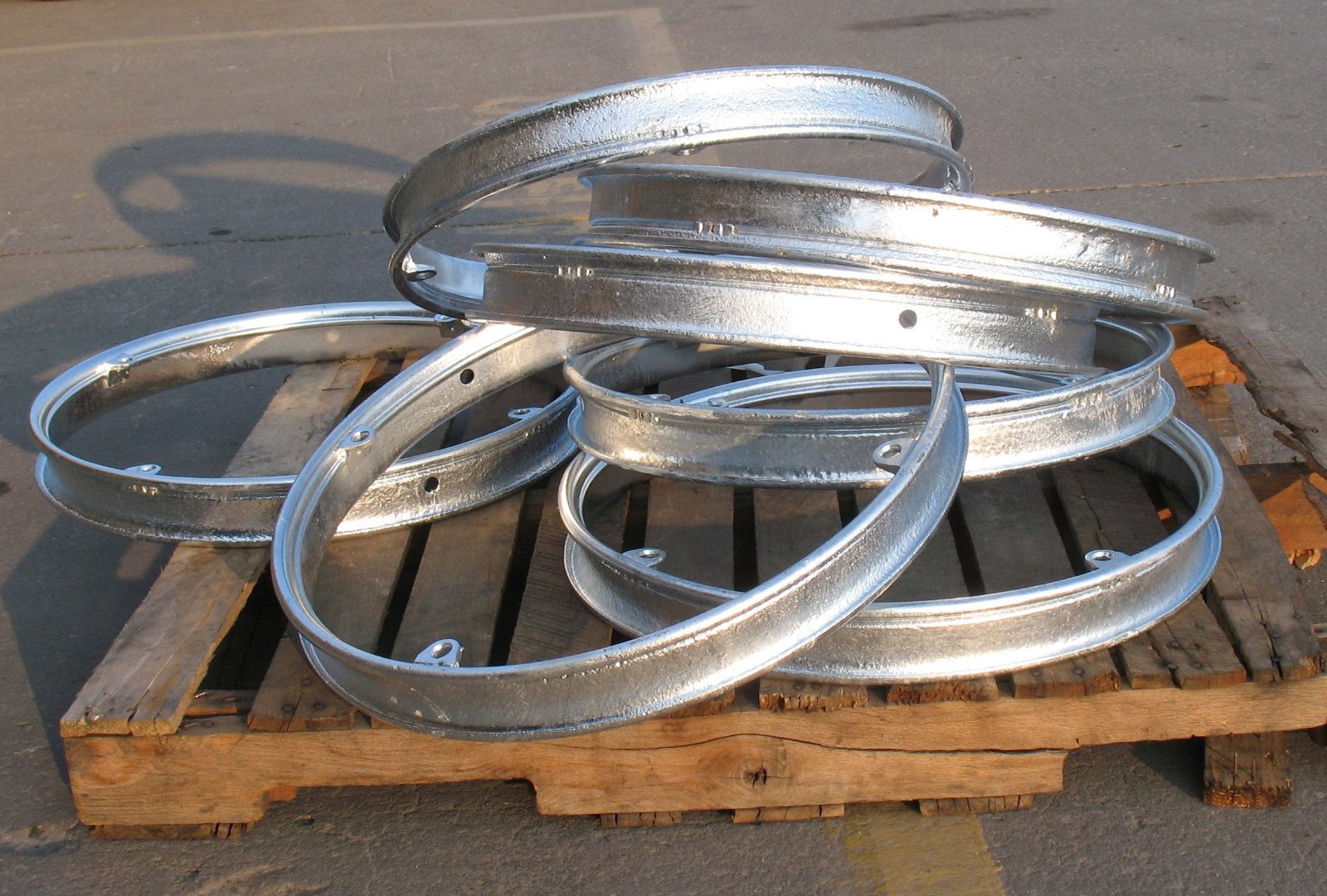

My only experience with galvanizing was as a customer. In 2012 I had seven Hayes rims and their hardware hot dipped at the Valmont plant in Catoosa, near Tulsa. I believe at that time the minimum charge was $235, and I could have had up to sixty rims done for that if I'd had them. A few years ago one of our members was trying to get some Texas guys together to have a batch of rims done and share the cost. I don't recall how that worked out. I'm having a geriatric brain freeze and can't come up with his name right now, but I'll remember it later.

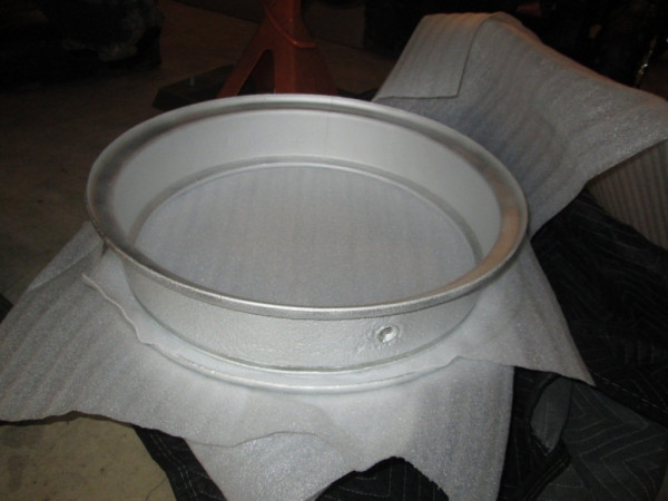

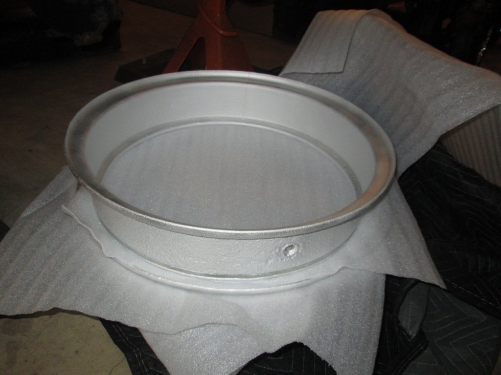

I recently had these TT rims "cadmium" plated - looks similar to Steve's rims ?

Whether you call electroplating with zinc galvanizing or not, it is inferior to hot dip galvanizing. That's why I have bought cans of old roofing nails at auctions. Modern ones are thinly electroplated and turn to rust spots in a few years. In rebuilding my house I have reused hot dipped shingle nails 80 to 100+ years old. One online source claims that hot dip is good for 50-100 years. My shingle nail experience agrees.
That "cadmium" looks a lot like Oklahoma chrome.
