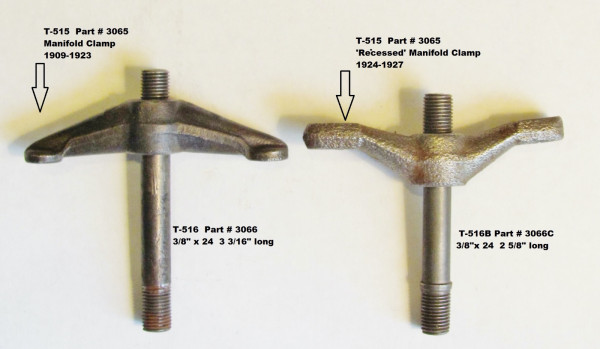

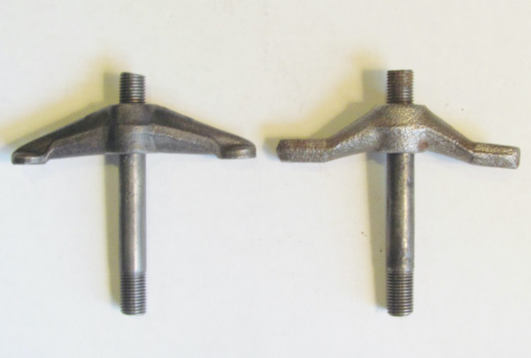

Here is ref. of usage dates from my research means.
The neat thing about the later clamps is they can be used with the early long studs by just reversing the clamp. So this late design meets Henry's criteria for new parts, since the part numbers didn't change.....they can retrofit earlier T's
