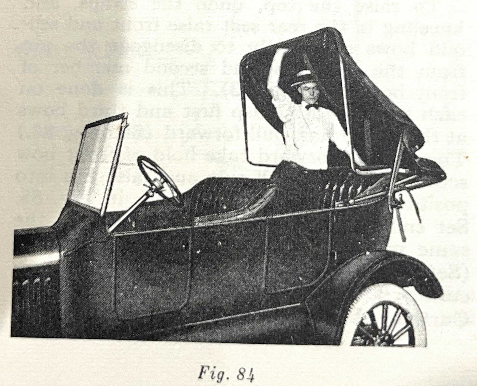

Loosen the top clamps on the stanchions, un-snap the rear gypsy curtains on each side of the rear irons,, so the snaps don't tear the top material, then climb in the rear, and lift and fold down the irons. Be sure to place the top bow saddles first, as the lowered top will rest on them.

Thank you, glad I asked. I will have to pull the car out of the garage which at the moment is a problem because I'm replacing a brake hose on my truck which is blocking the garage door. There is not enough clearance inside to lift the top and pull it back. I'll take it slow. Thanks again.DanTreace wrote: ↑Tue Aug 22, 2023 7:45 pmOne man top showing top straps.jpg

The entire lowering and raising procedure for the touring one man top is in the Ford Service Bulletins August 1922, Vol 3, No 8, pgs 62-63 Figs 78-85. Figure 84 posted by Dan is of the top going back up.

… That 2nd bow from the front has 2 ‘nubs’ at the lower end. They’ll need to be removed from the ‘cradles’ high up on the 3rd bow from the front and inserted into the fixture lower down on the 3rd bow. Don’t pinch the top fabric between the 4 folded bows. YMMV
