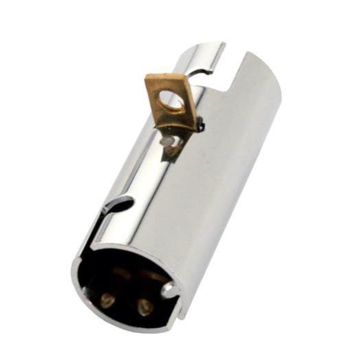

does anyone know where I could get some headlight sockets high low the part where the bulb goes into

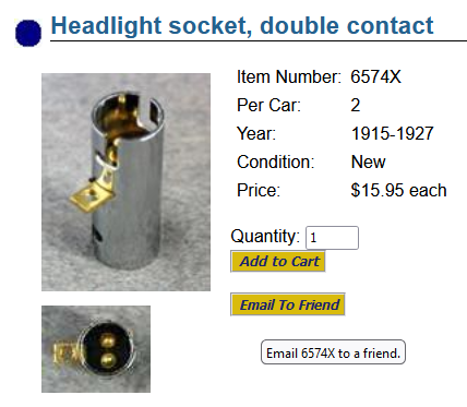

Do you mean these? Snyder’s should have them, part#T-6574-X

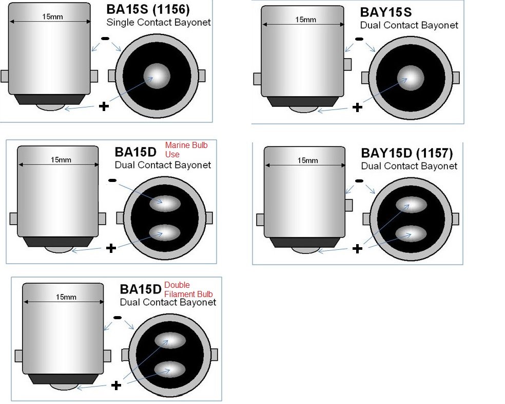

Are referring to the socket to fit bulbs with offset pins?
The normal setup was weither a BA15S (single contact) or BA15D for (Double Contact). Sockets for bulbs with offset pins are BAY15S or BAY15D.
Since BAY15 style bulbs are normally brighter & perhaps the source of the question. But I am unaware of Model T sockets with off set pins. Most users simple break off the high pin without issue. Other use LED bulbs. Trying to fit a BAY15 socket will require a tab to allow for adjusting the bulb to meet the focal point of the reflector

A couple of weeks ago double pin light sockets were out of stock at Langs, Snyders, MACs, and Smith & Jones. Chaffin's had them but they confirmed that they are struggling to order more. You may want to pick them up from Chaffin's while you can. Chaffins: (951) 226-7331
