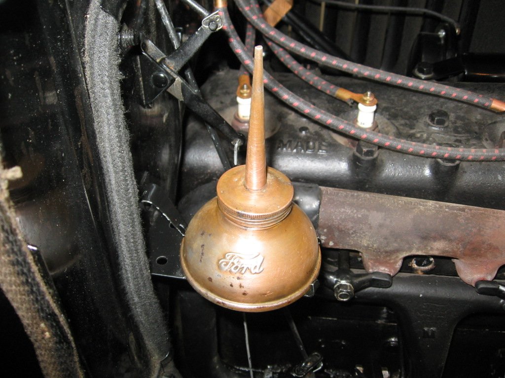

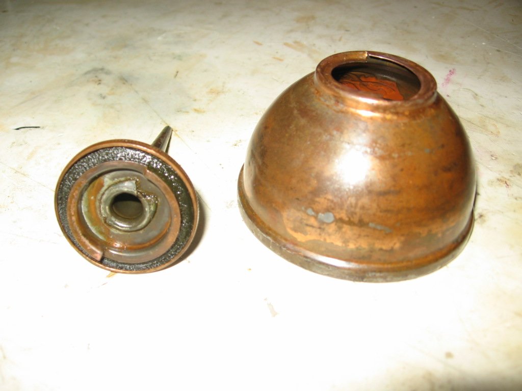

The bayonet spout has two tangs that fit into slots in the base. Then 1/4 turn or so of the spout moves the tangs so that they are retained by the base.

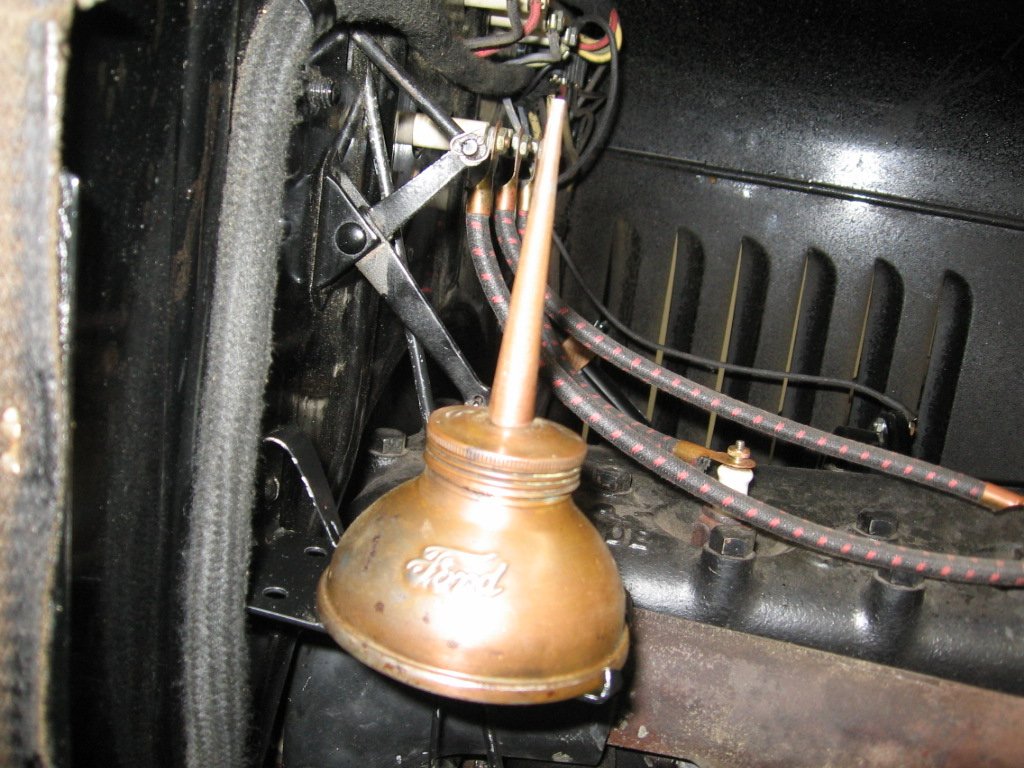

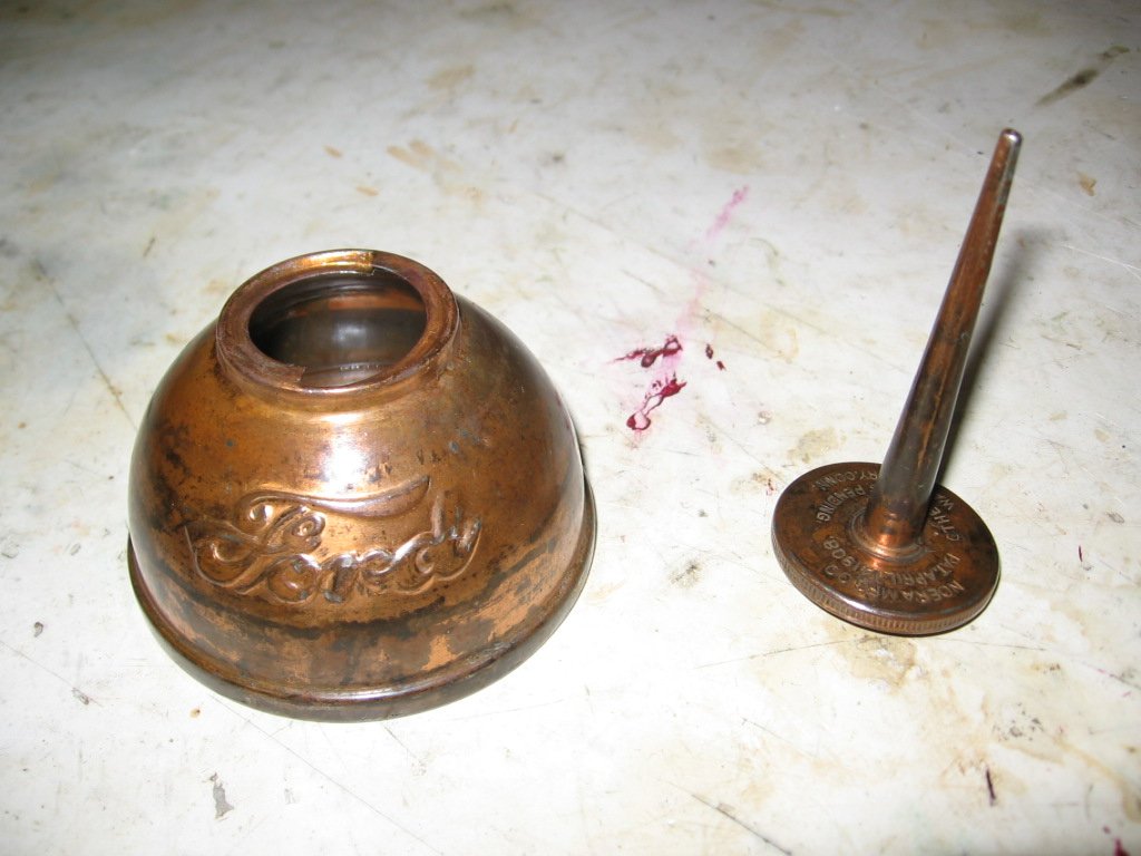

Some threaded spouts have internal threads, others have external threads, the arrangement varied by year.
The latest update to the MTFCI judging guidelines spells out which configuration is correct for which years. There is not a lot of definitive discussion regarding base diameters and overall heights. The last of the three links below has the latest updates on oil cans. The other two links are provided for completeness.
https://www.modelt.org/judging-guidelines-updates.html
https://nebula.wsimg.com/150b3d9f3d6092 ... oworigin=1
https://nebula.wsimg.com/a81fc3dc5bc18b ... oworigin=1
Examples of threaded and bayonet spouts are shown below. I do not have any oil cans for sale at this time.
