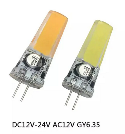

That was very useful, thanks. I was able to swing around in my chair and closely inspect the almost identical emitter units that I have in a drawer here.
The ones I have are GY6.35 style with a shorter pointy end enclosed in a clear flexible type material, they cost around USD $1.50 at the time but are now up to $2 each. I had a bad batch of them around four or five years ago, but prior to that they'd been great and I still have some in operation that are ~8 years old and get used every day.
I expect the higher price of yours reflects the special base and the longer emitter 'wand' at the tip, along with the retailers margin. If it were me I'd simply replace the emitting unit(s) with the GY6.35 style that I have (you may even find the base is in fact already made up for them?).
Actually, I've now done a little more research. It turns out you can get what looks to be the identical unit (sans base) for circa $2.20 with the longer wand:
If you want try this it would first pay to see if you can fit these to your existing base, and if you'd like a link to where they come from I'm happy to provide that in a PM.

I agree - it looks like the units luke referred to plug into the brass base that Snyder added.
It would be interesting to find out if the GY6.35 will fit into the brass base.
If they do, you've got a cheap way of replacing the ineffective bulb. Let us know what you find out.

Do you think the units you are showing have a greater lumen output than the new units that I posted a link to?
Brent,
There are several different units available with the same base configuration. They appear to range between 250 - 900 lumens, and 3W - 10W.
I have two types here, one was rated at 3W, the other at 5W, I don't recall now what their lm rating was. Subjectively they are quite good as a reading light and I find them adequate to light up a room (I run pretty much everything off low-voltage solar here), in my view they'd be fine as a carbide light replacement but YMMV!
I hesitate to make any useful comment as to whether they would have a higher luminous flux than the ones you reference, it's been my experience that the specification of these things can be a bit 'loose', but on the face of it I suspect you could get units that would be just the same, or brighter (or dimmer) as you wish. Note that you can also get them as 'dimmable' units, should that be useful.
What I tend to do is get more than I need, from multiple vendors, and evaluate them from there to determine what I'd get in future should I need more. This is what I did for the headlamp units now residing in my Model A. I now have several sets that are just 'ok' and one set that is perfect and I know what to get if I want more. For the units you're wanting I'd expect less variation and more certainty that pretty much whatever you got is likely to be fine - perhaps get two or more each of 5W 8W and 10W units to see what you think?
