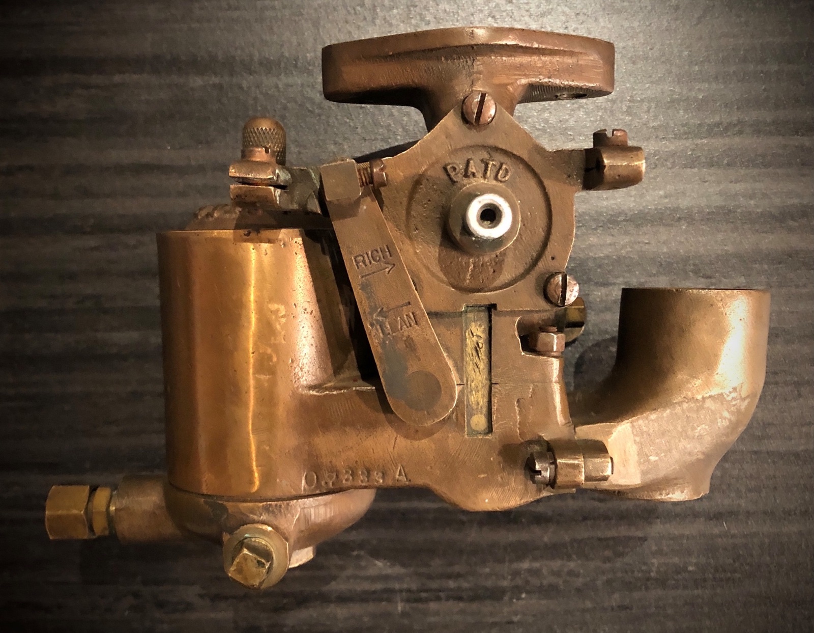

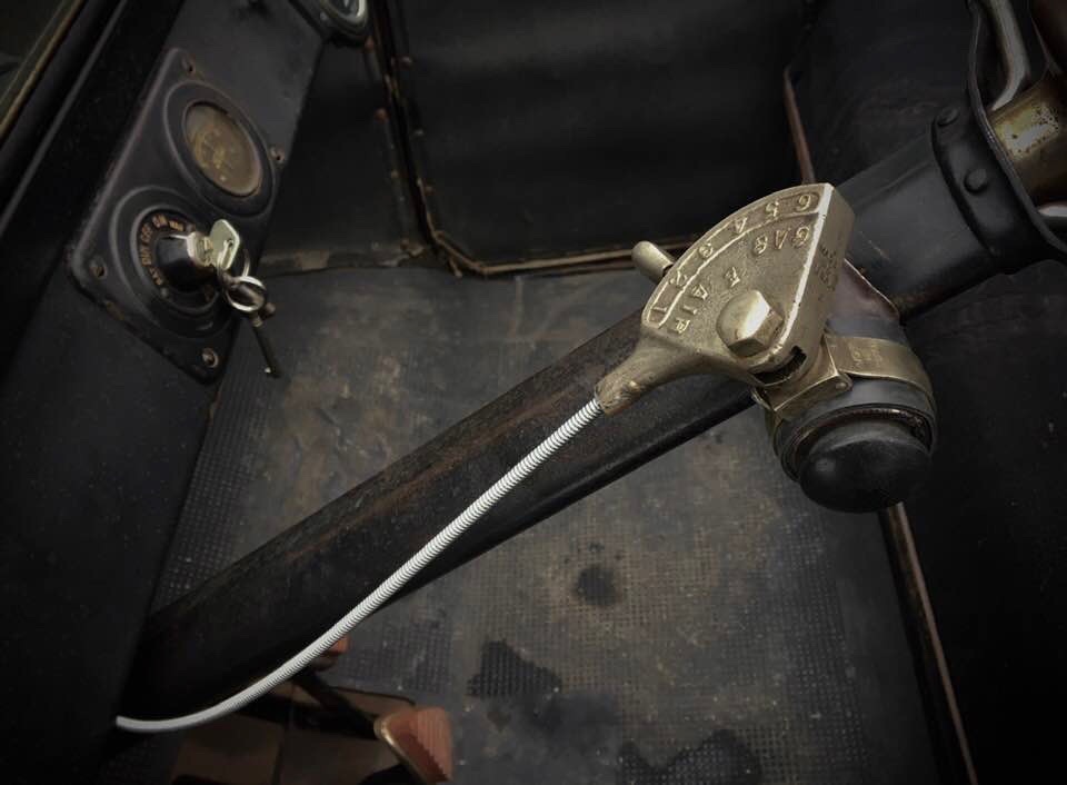

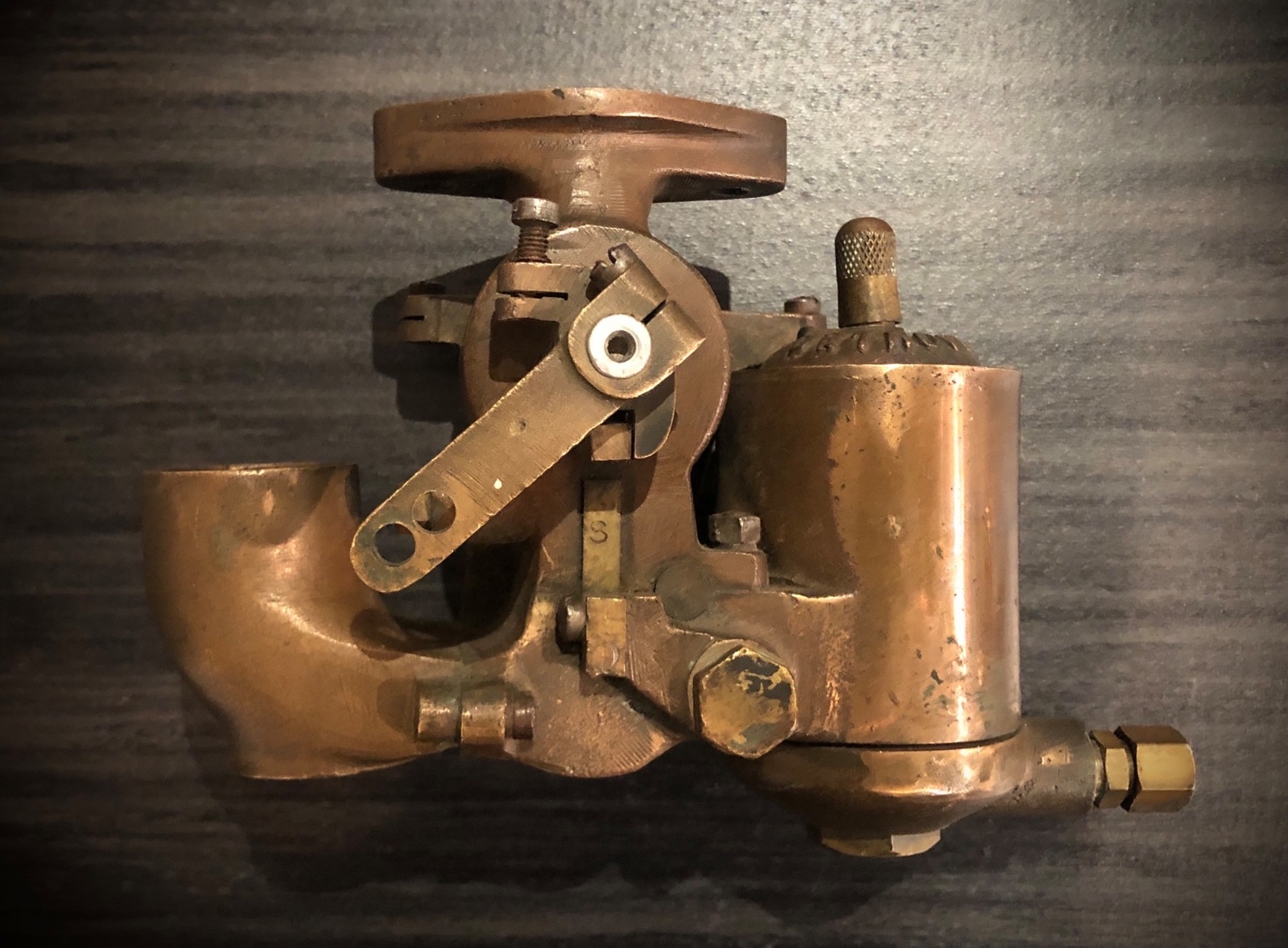

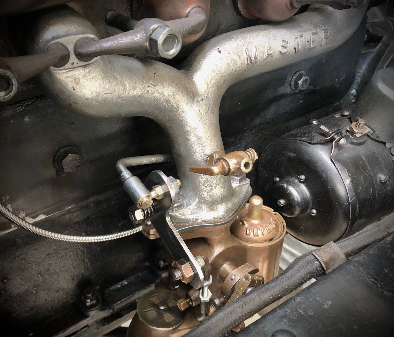

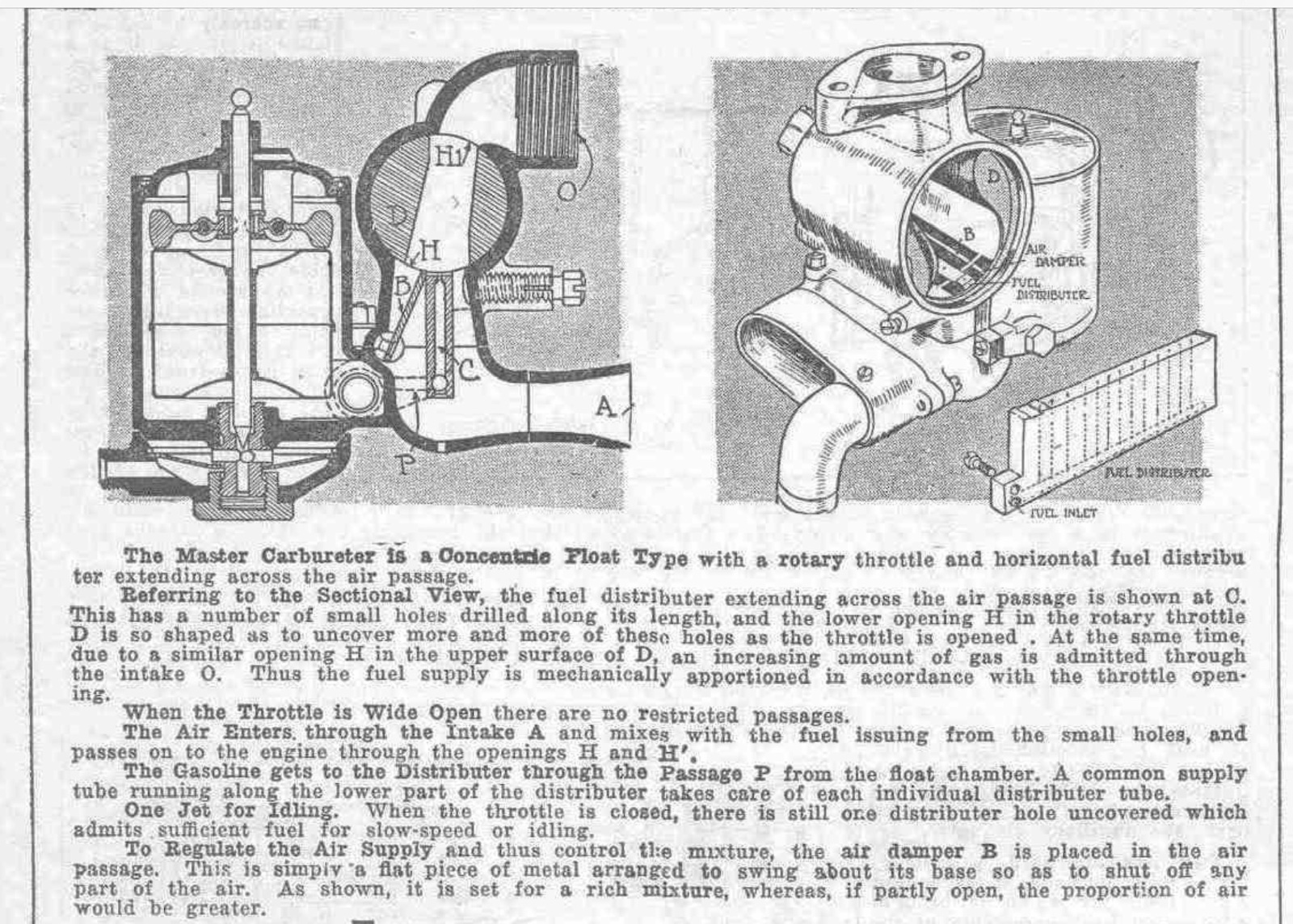

Those who follow my personal facebook page know that I was was struggling to get a Miller Master Carburetor to run correctly a year ago. I had found it at Hershey and really wanted to see what it would do. They don’t work like other carburetors with a rotating drum for the throttle and a hollow brass piece with thirteen tiny pinhole jets called a fuel distributer. I discovered that four of the jets were clogged with solder so I disassembled it to open those jets. The second time I tried it I found it would only idle because there was a gasket leak I couldn’t see. With the kind assistance of Royce, who wrote a great article on his own experience with restoring a Master, he was able to confirm that my rebuilt fuel distributer was working as designed. I reinstalled the Master Carburetor several days ago and it is everything it’s designed to be. Amazingly slow idle and yet incredible acceleration with amazing hill climbing strength. I only know two people who have a Master carburetor in their cars. I would appreciate hearing from others. Here is a youtube video of the carburetor running at a fast idle. https://www.youtube.com/watch?v=4LDYKbrK2Vo
