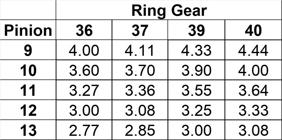

Here are the potential possibilities of gear ratios.
[/size][/b]

Which one is 'standard'?BE_ZERO_BE wrote: ↑Mon Aug 28, 2023 11:03 pm
- Posts: 2548
- Last Name: Strange
- Location: Hillsboro, MO
- Board Member Since: 2013
Re: Pinion and ring gear ratios
40/11, 3.64.
