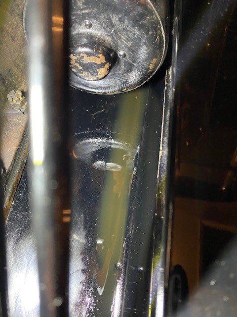

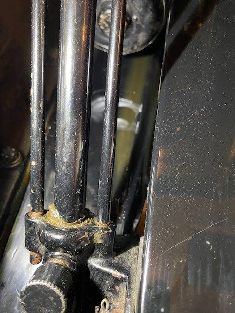

Hi all, my T consistently develops a puddle of oil (?) below the starter after taking it for even short drives (2+ miles). I'm thinking I need to change out the gaskets or, worst case replace the starter. What do you think?

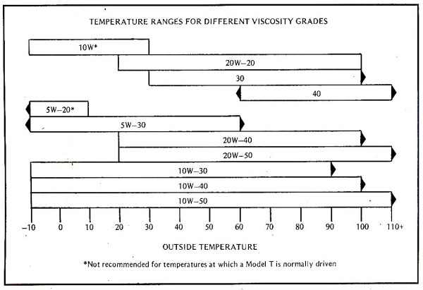

As mentioned above, too much oil in the crankcase will assure leaks. Ford recommended keeping the oil level halfway between the upper and lower petcocks "for best results".
You might think a heaver, thicker oil would reduce leakage, but with a Model T, the opposite is usually the case.
Model Ts were designed to use a quality, "medium" grade motor oil with a low (temperature) pour point, or cold test. That's about 20W.
A good 10W30 motor oil is a good choice today for most conditions.
In cold weather, 5W20 will do fine.
I use 5W30 or 10W30 synthetic oil with excellent results in very hot weather and in cool weather.

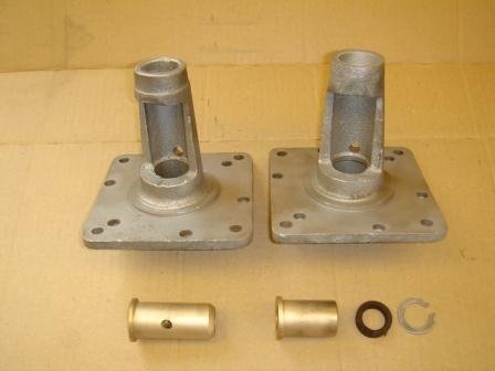

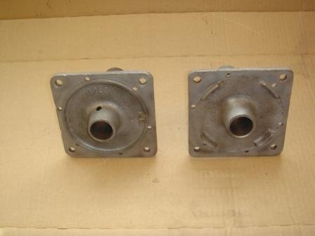

Early Model T starters were equipped with a felt seal for the Mounting Bracket/armature shaft seal. See attachd photo on Right.
Not sure how long this was done, but you don't see them very often. Those units did not have a drip hole drilled in the bottom of the starter case..
I rebuilt over 500 Model T starters and I only saw three with early units this type factory installed oil seal.
Apparantly Fords solution to this problem was to drill a hole in the bottom of the starter case to allow the oil that had flowed into the case via the armature shaft/mainbracket bushing.
