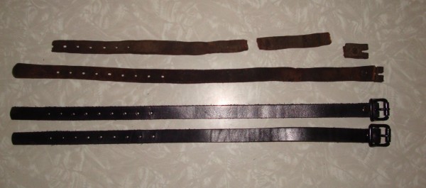

I was lucky enough to have a brittle old pad for a sample. I took it to the local saddle shop and had a pair of new ones made. I was able to borrow an original strap I could copy.
This was a couple of years ago, and I have no recollection of where I got the buckles.

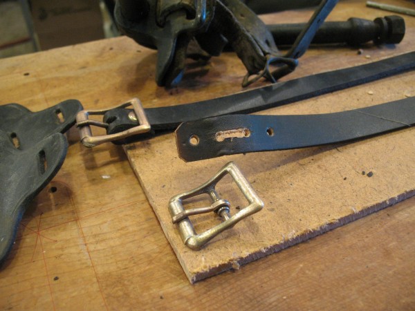

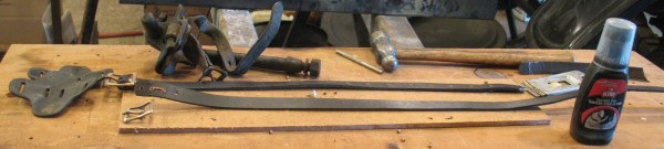

A few years ago, my dad made a set of pads and straps for my 1917 roadster using the originals as patterns. There is a saddle shop here in Minneapolis that was established in 1907 and has a fully equipped shop with 100+ year old machinery.
My dad had the shop shave a piece of leather to the correct thickness. He did the rest of the labor himself: cutting correct length and width straps from the leather, putting a radius a one of end of each strap, punching the holes, dying the leather and riveting the loop around the original buckles from my roadster. See attached for the completed straps shown with the originals.

Note: if you a stickler, the straps sold by vendors such as Lang's are not correct. They are substantially thicker than the originals, they have two decorative grooves in them which the originals did not have and the buckles are completely incorrect. They are functional but I would consider them to be after-market and not a good facsimile of factory issue.
