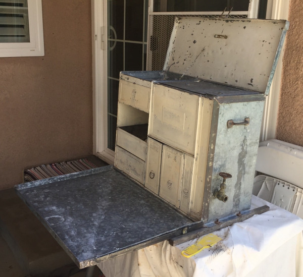

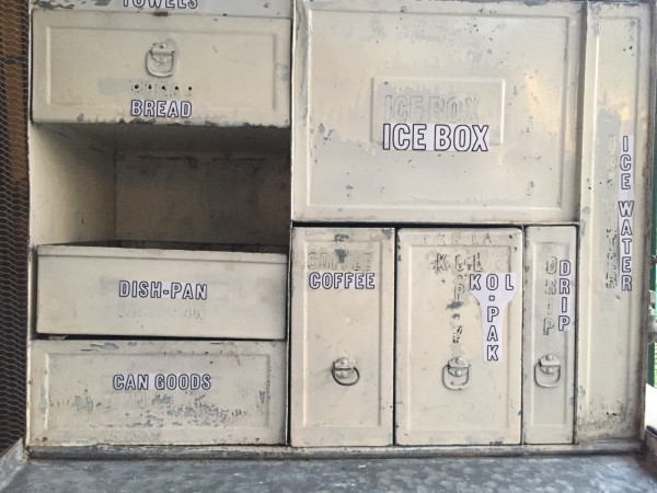

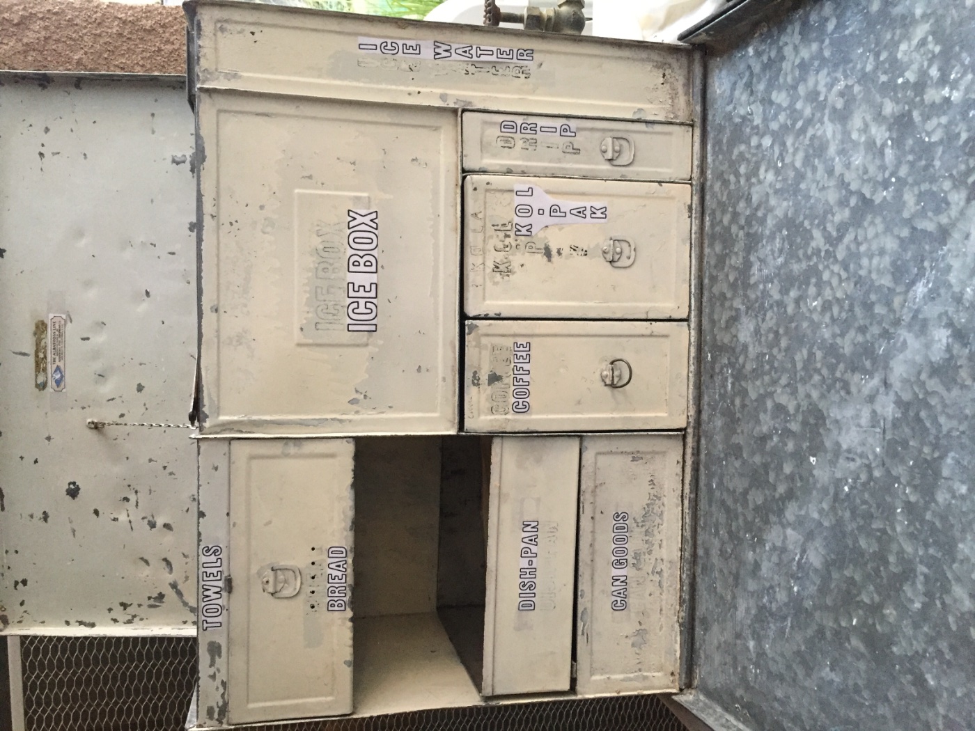

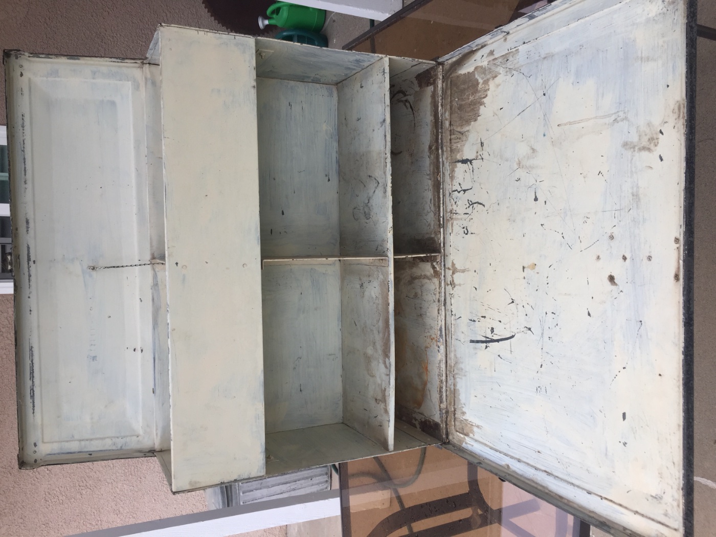

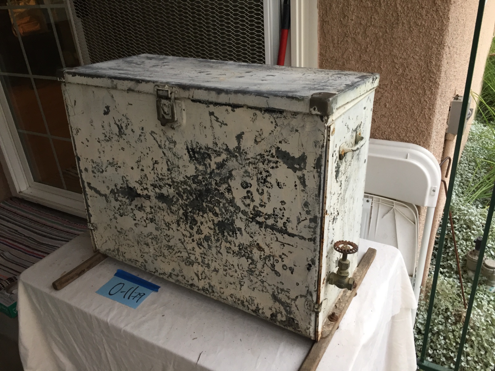

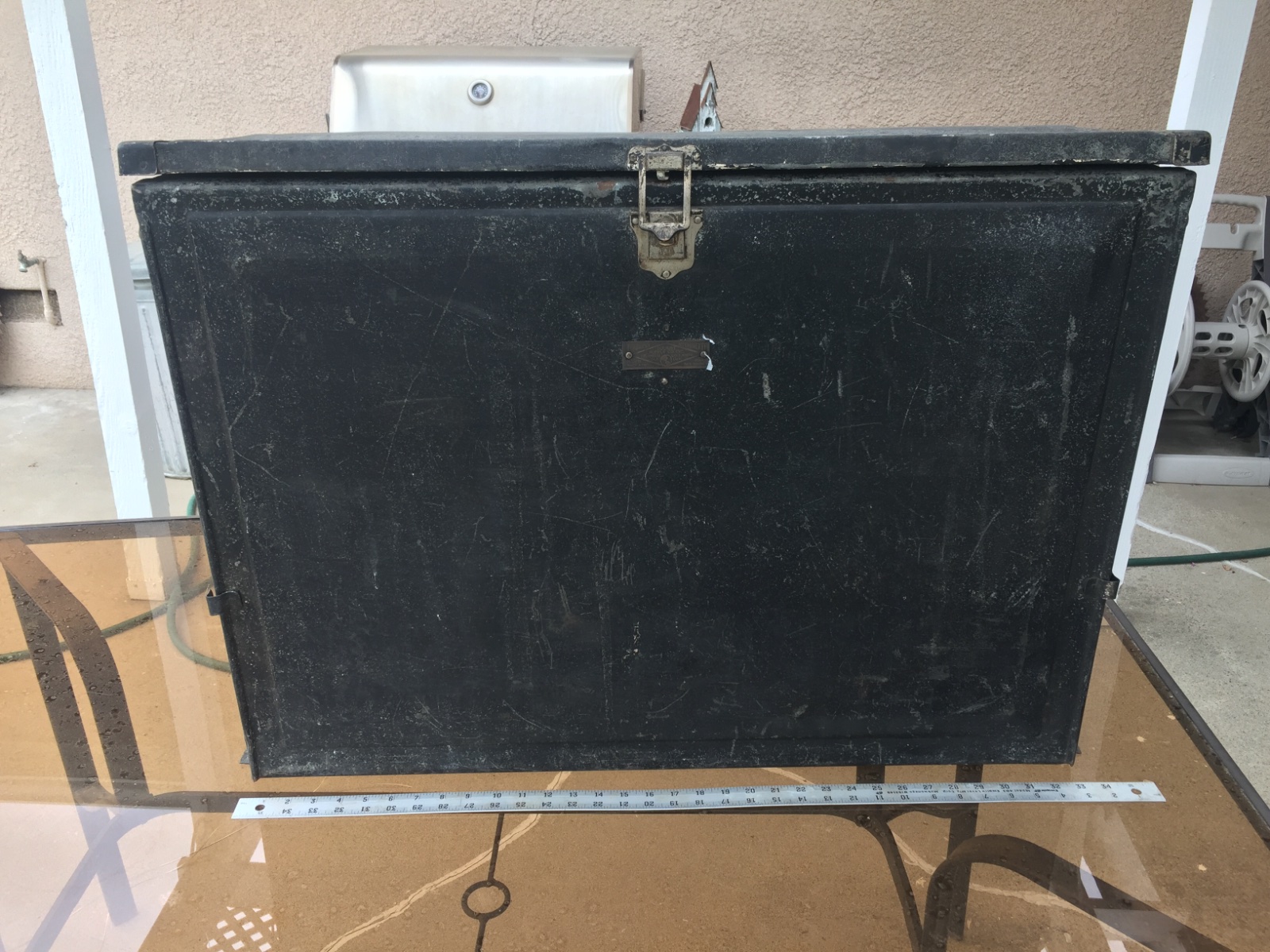

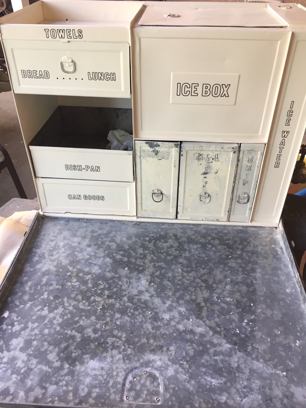

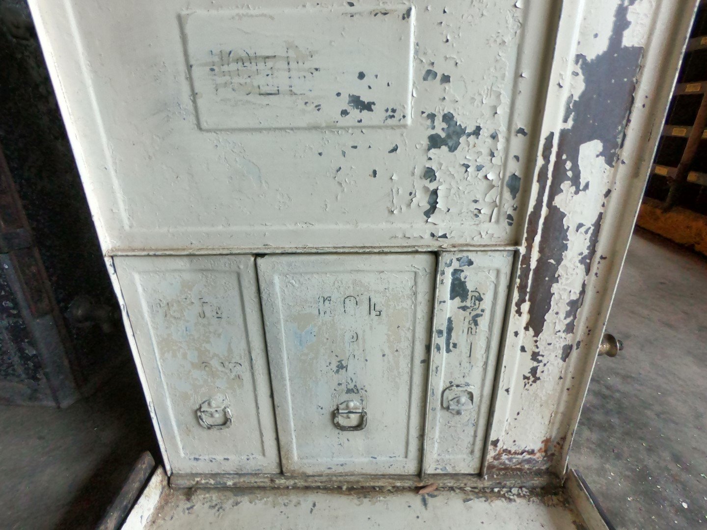

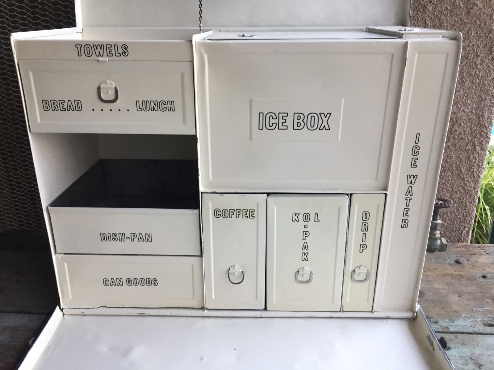

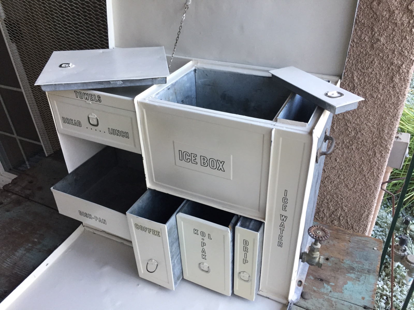

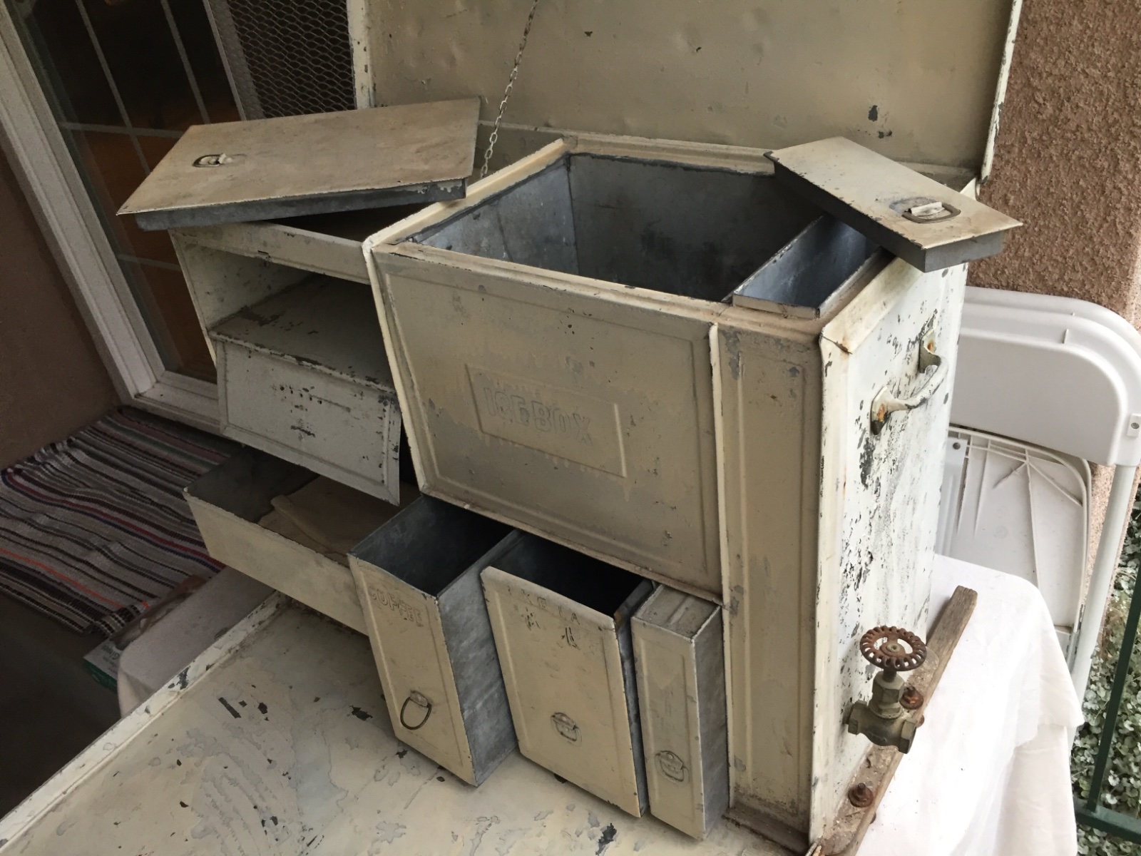

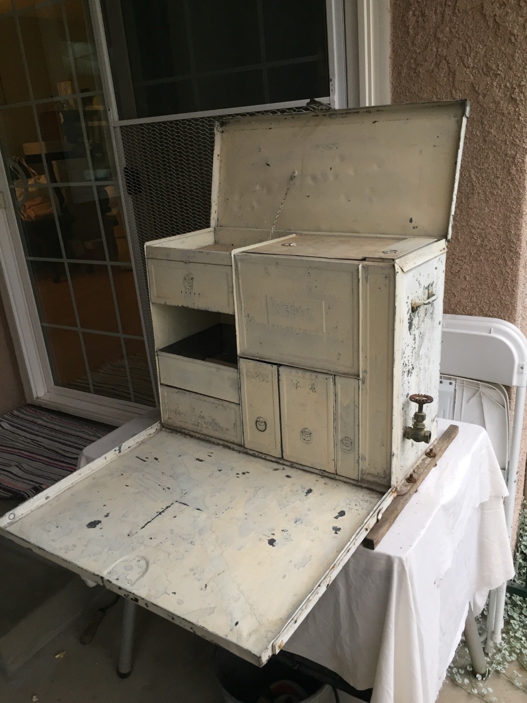

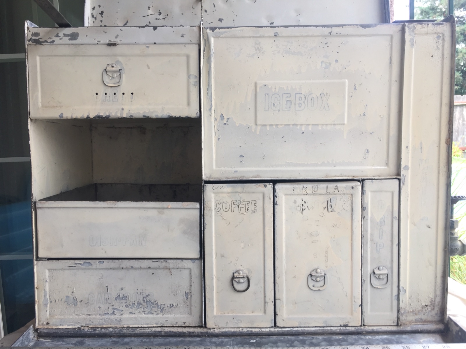

I picked this up at an auction last weekend.
Unfortunately someone took the time to paint over the decal lettering. I plan to strip the paint off and either leave the galvanized steel or paint it. Either way I would like to add decal lettering.
Any suggestions?
Any suggestions?

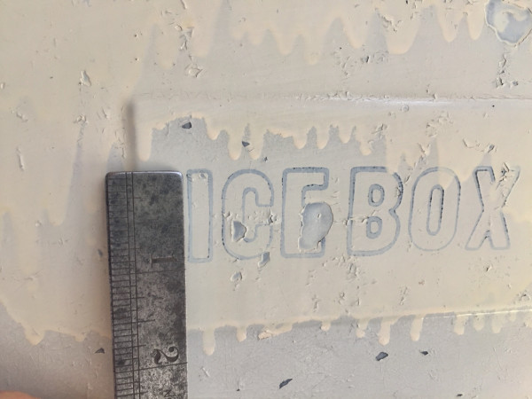

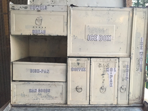

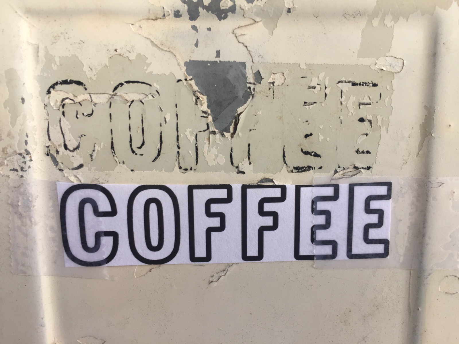

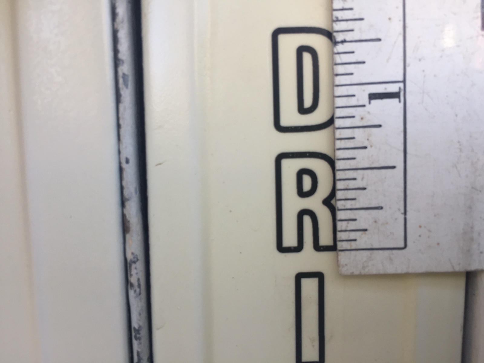

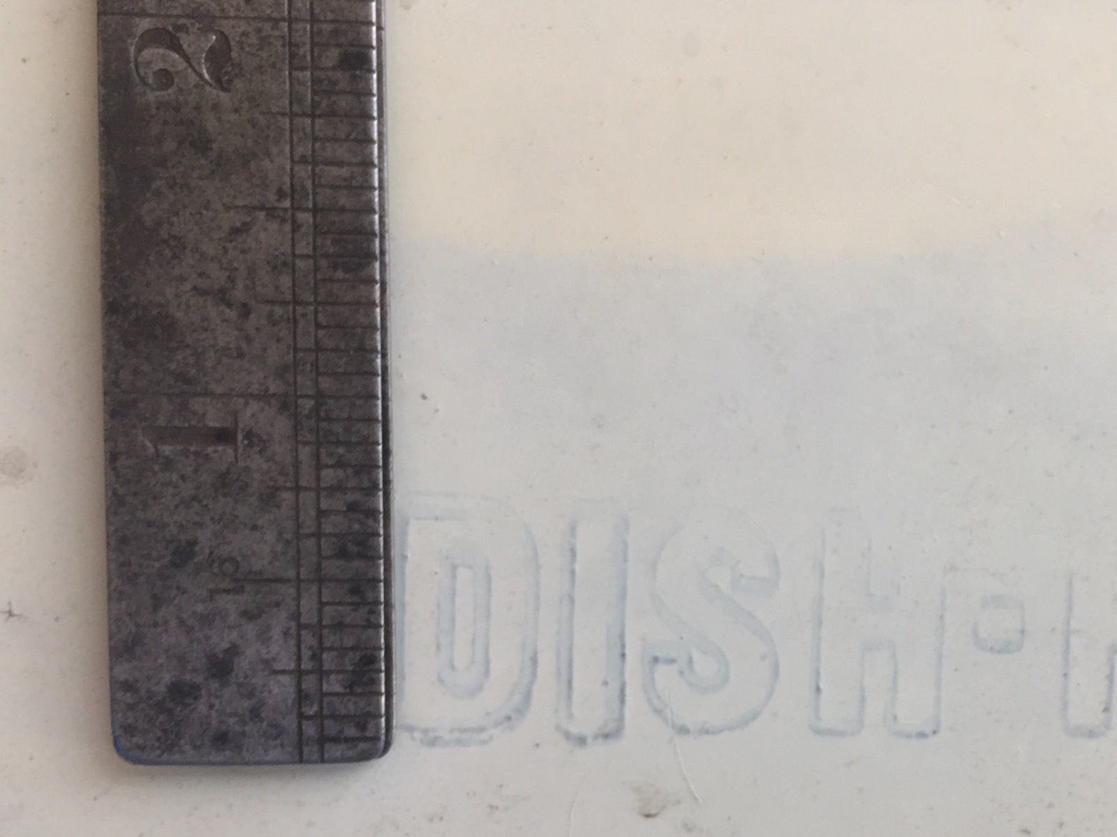

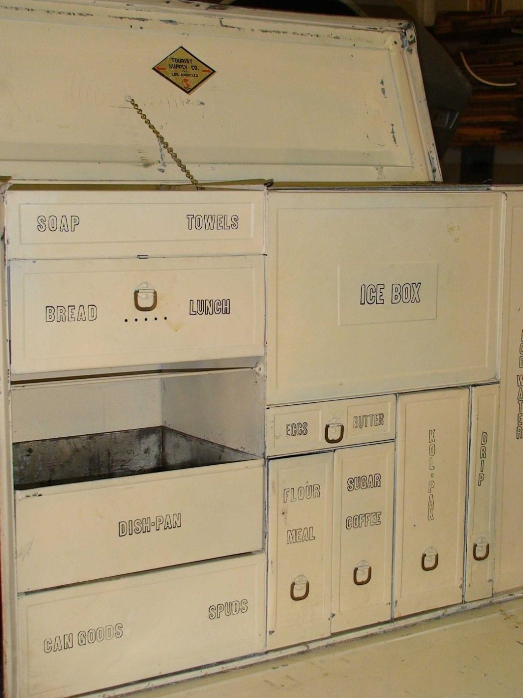

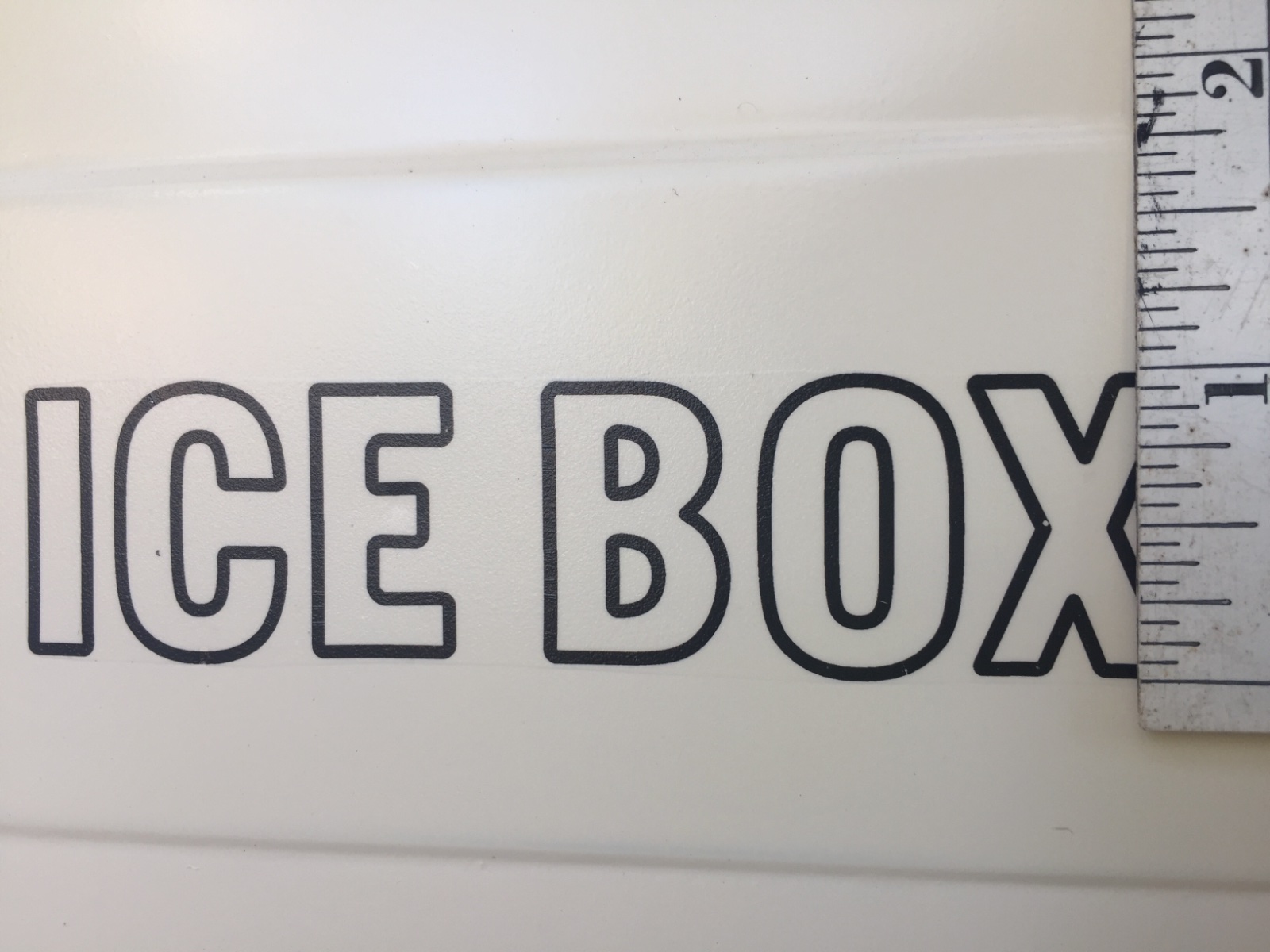

“ICE BOX” Seems to be written and 1 inch lettering.
Everything else seems to be written with three-quarter inch lettering.
I am not sure on the exact font but this appears to be a block lettering with black outlines. I’m not sure if it was a decal or some sort of lettering that was stamped on with paint.

Most any print shop can do vinyl letters.

Very cool! Great find, love to have one!

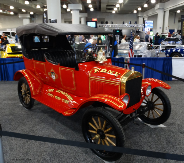

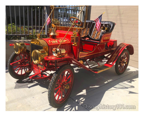

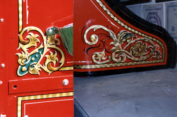

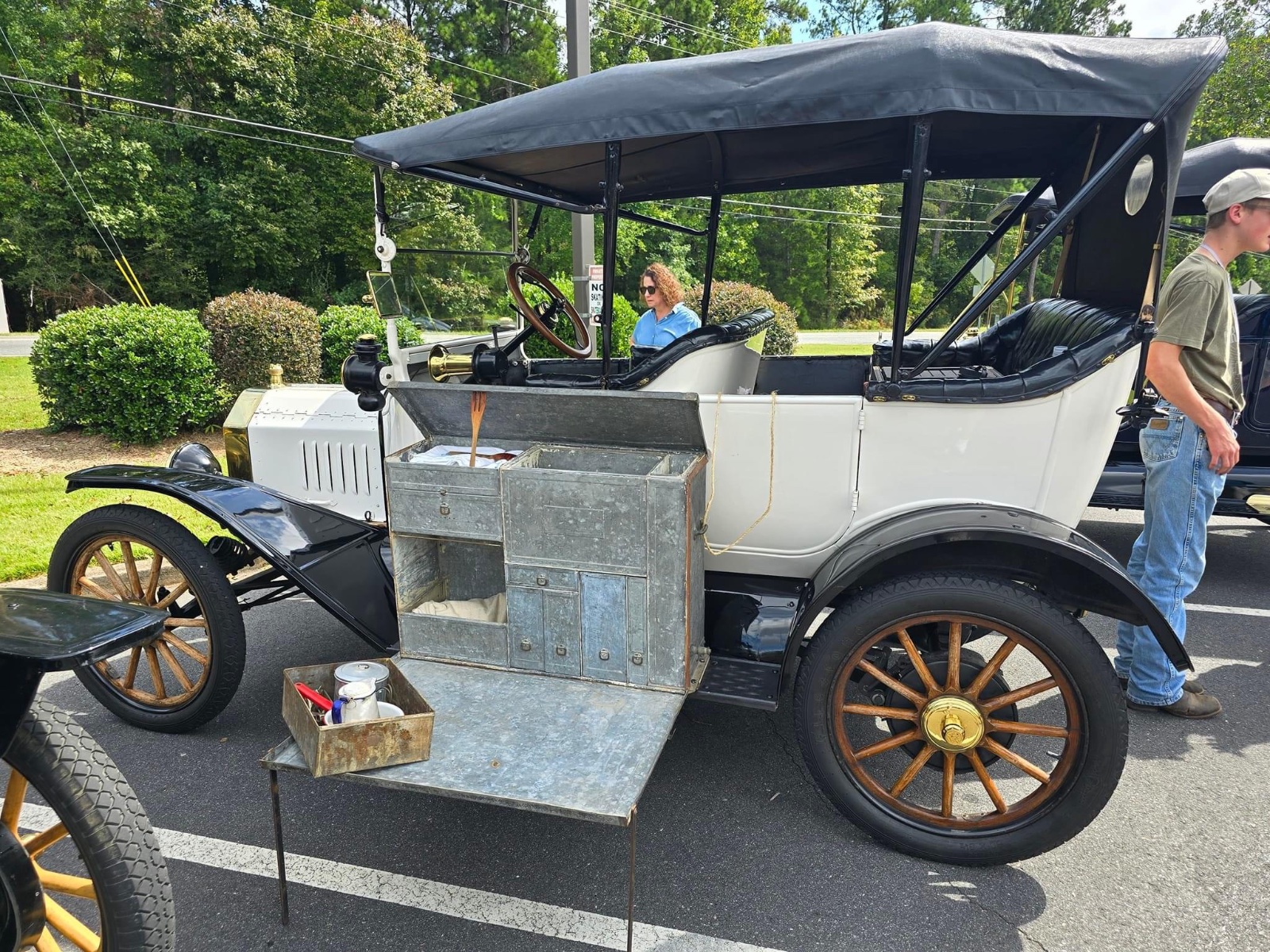

I have always liked the gold leaf Wild West font with ornate pin-striping like the lettering on Fire Engines. You can look up examples online and where to get such lettering. Jim Patrick

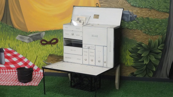

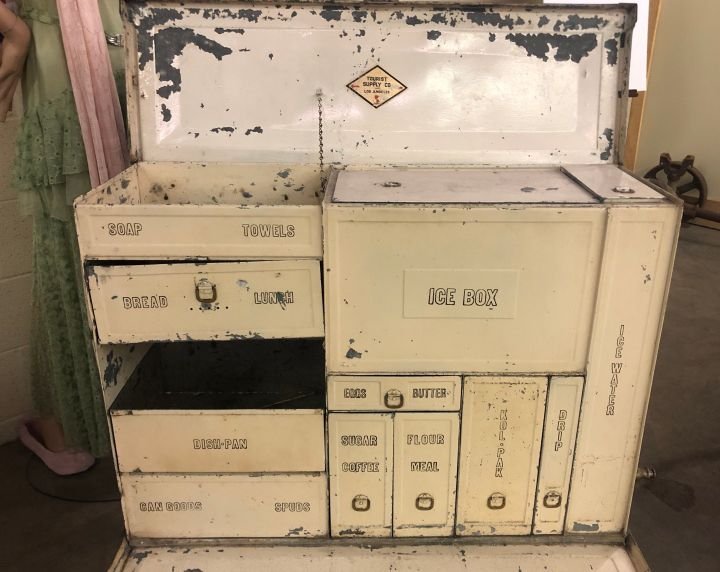

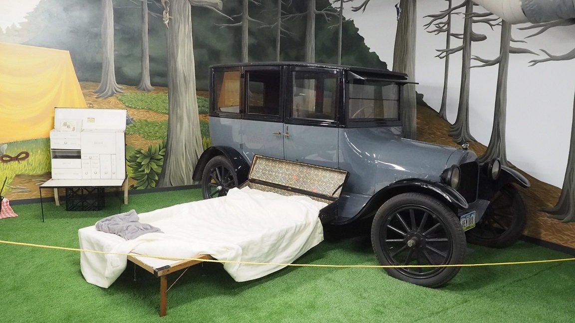

They have one of those on display at the Antique Car Museum of Iowa.
Looks like fun.

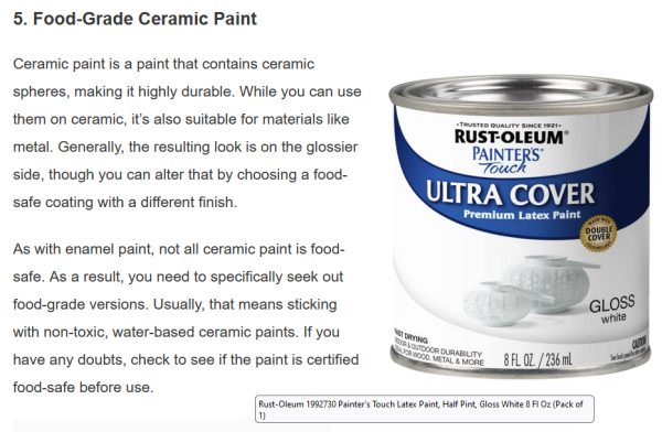

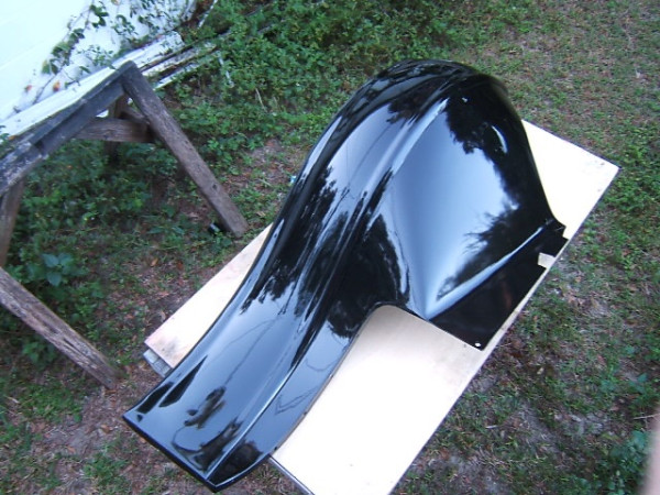

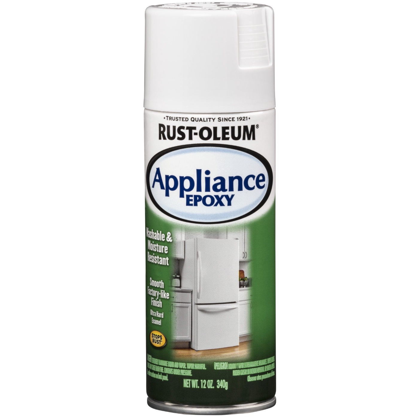

If you want to keep it white, Rustoleum Gloss White Appliance Epoxy spray paint is the best I have found. Sand off all the high points and runs with wet/dry sand paper to get it as smooth as possible then spray. If you are good, you can get a professional looking paint job. This is a fender I did with the Rustoleum Gloss Black Epoxy. Pictures were taken after the paint was dry and before polishing with Meguiar’s rubbing compound. You can get an even better shine if you polish it with rubbing compound but the finish looked so good, I did not feel the need to compound it. The same results can be achieved with the white. Jim Patrick

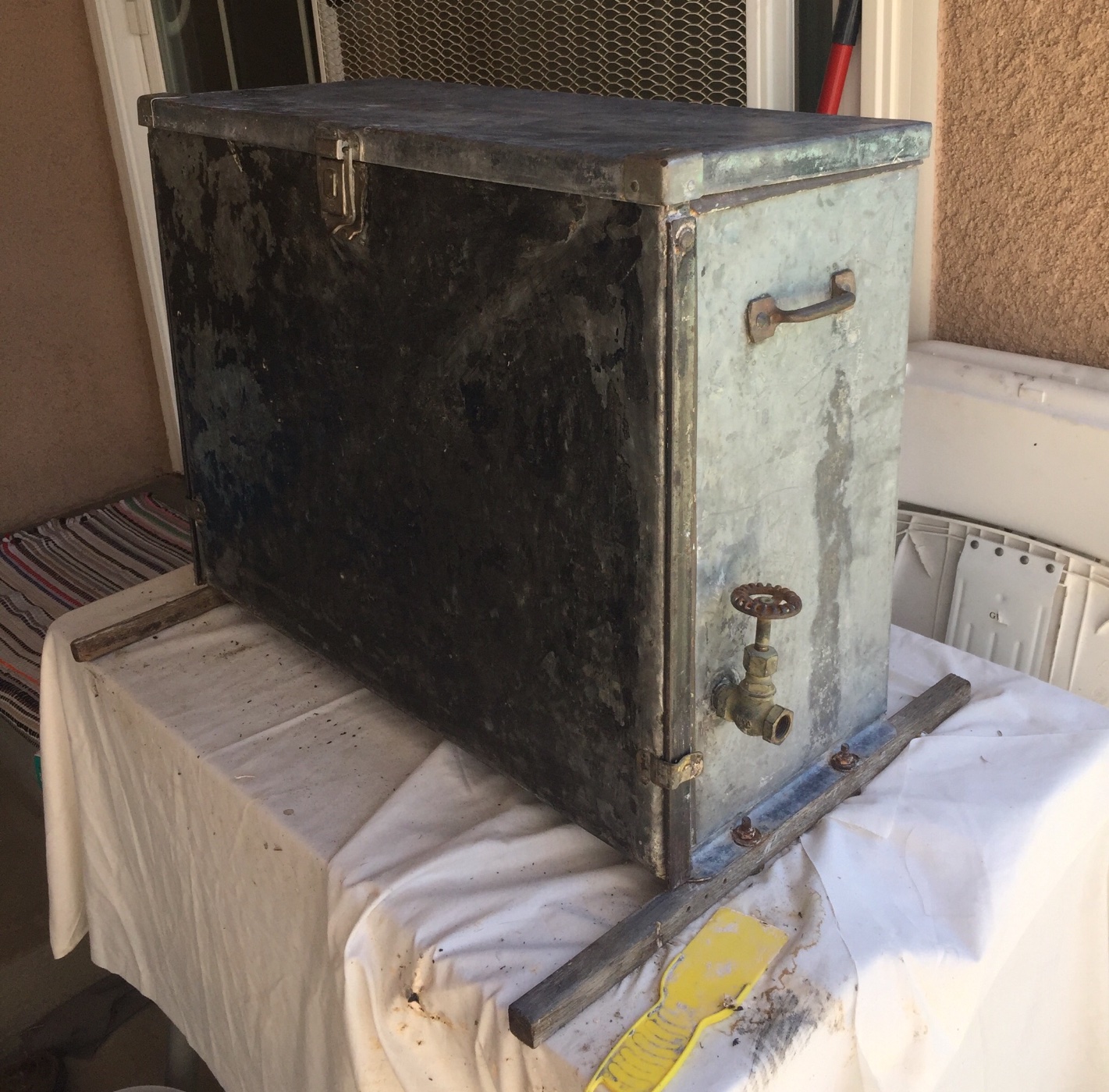

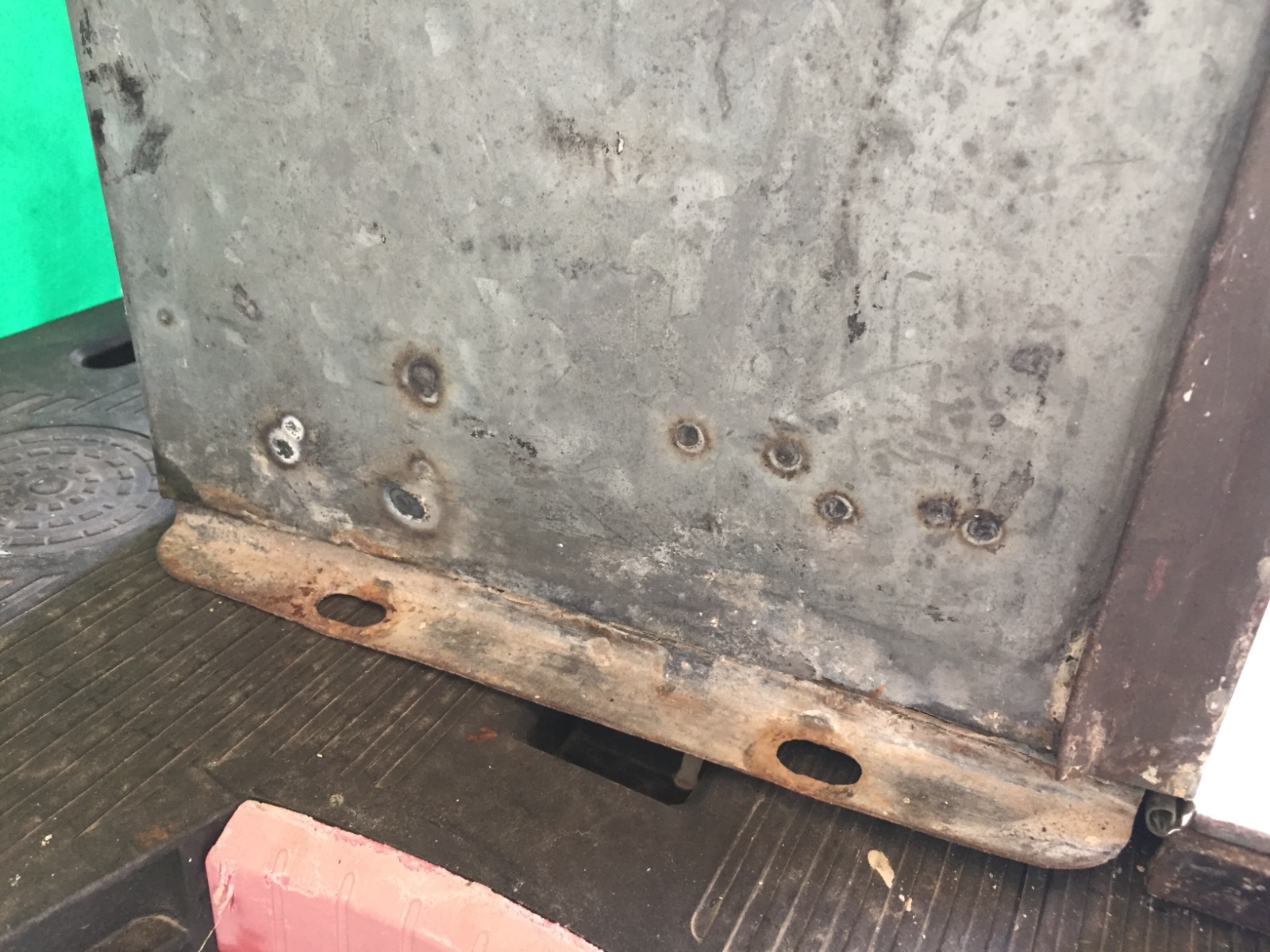

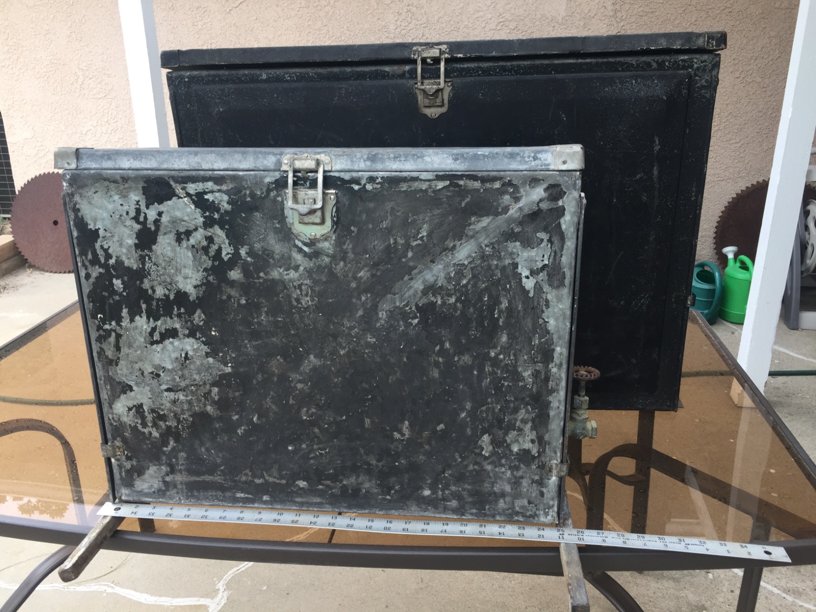

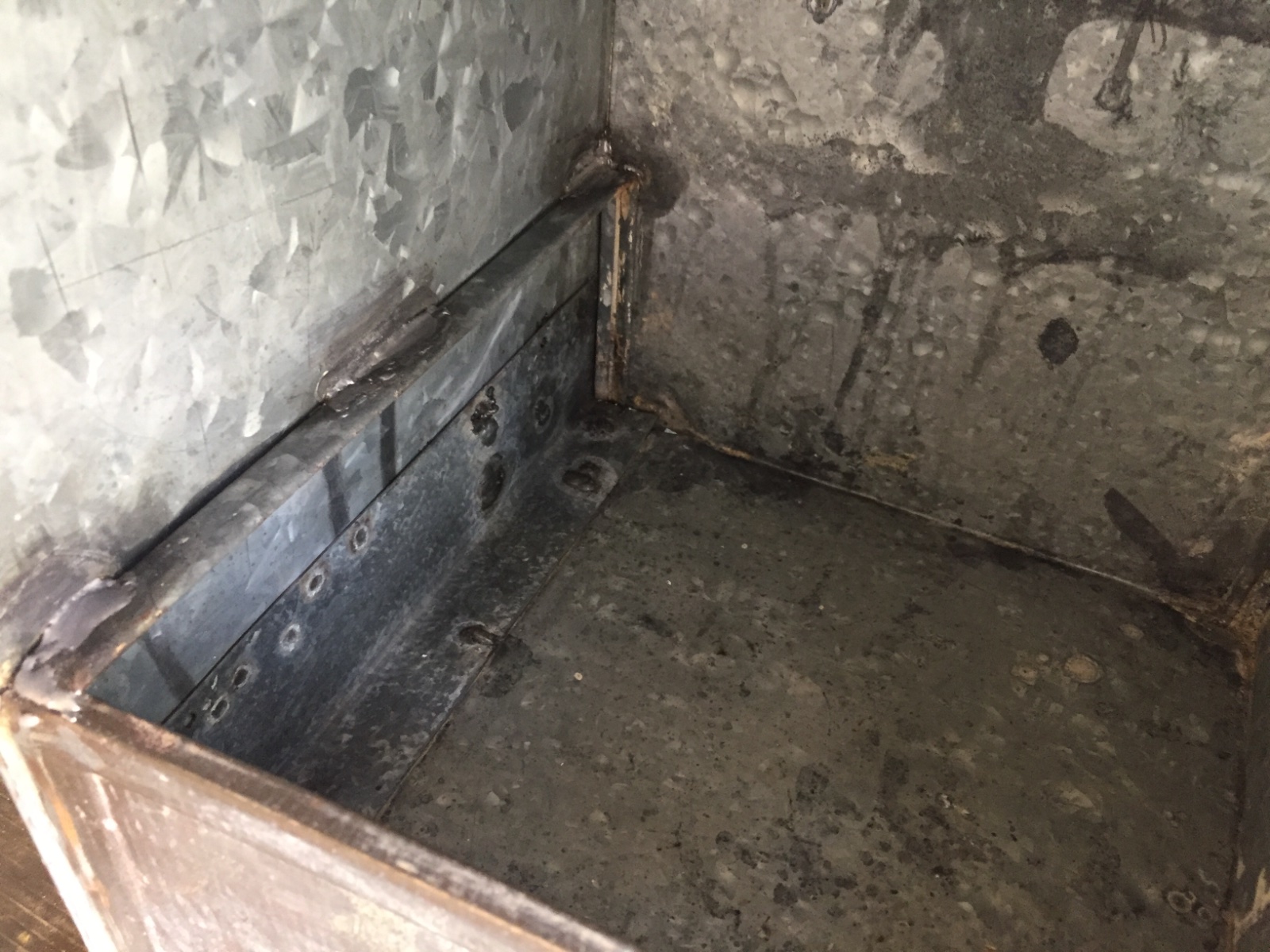

Jim Patrick, Thanks for the advice on the painting. I’ve been working on stripping it down to the galvanized sheet metal. In someways I like the galvanized look. But I might want to paint at least the inside.
Jiminbartow, I love those gold leaf decals!!! Even though it is not original the gold and black letters could look amazing. Any suggestions on where to find online.
I will have to see if a hobby craft store has the labels I could use.
I also see that there are laser water slip decals. Anyone try those?

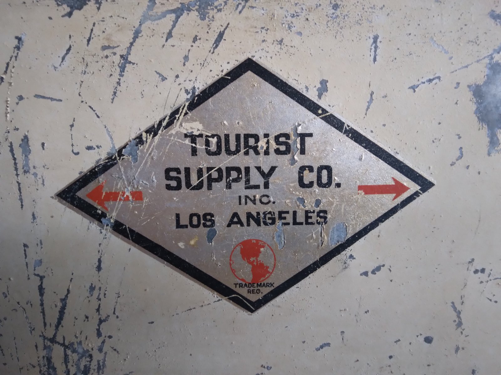

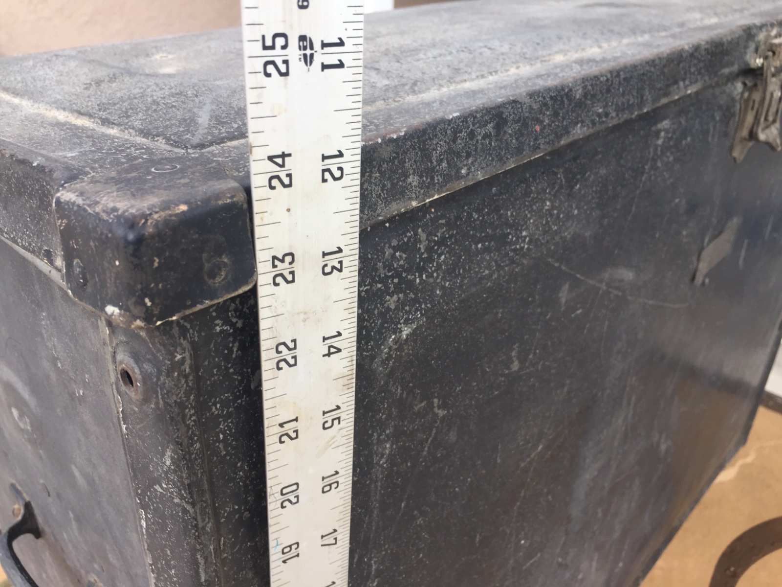

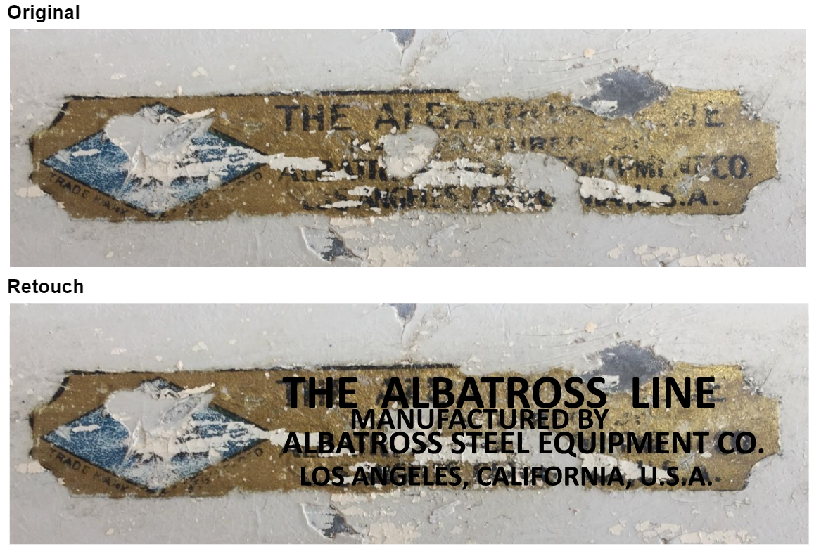

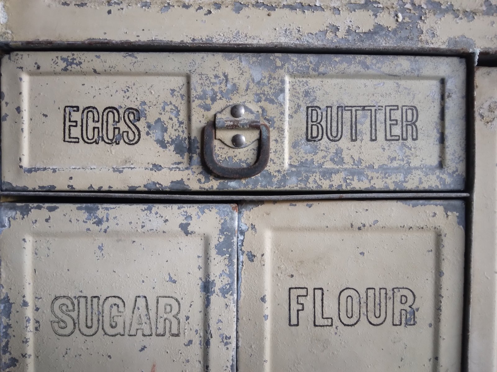

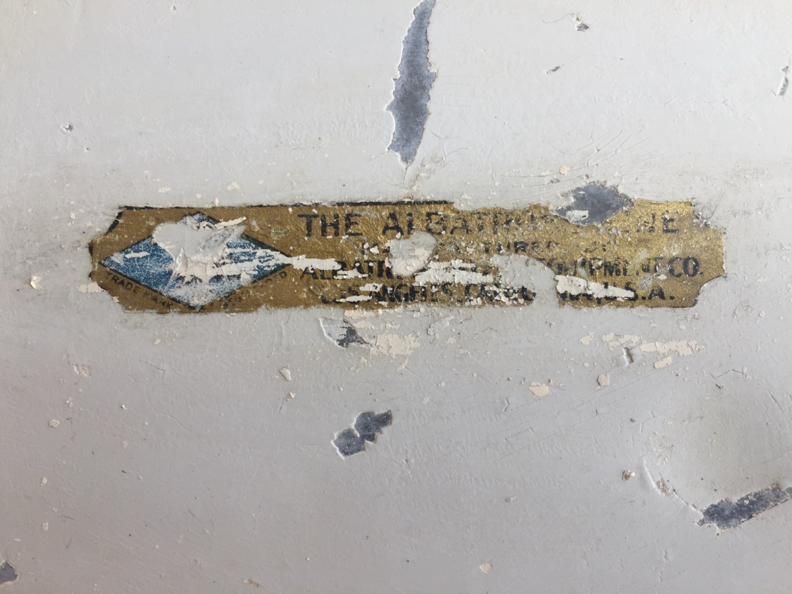

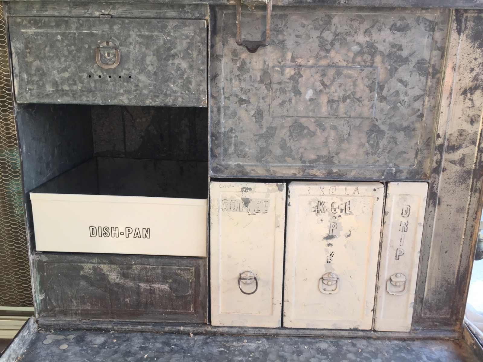

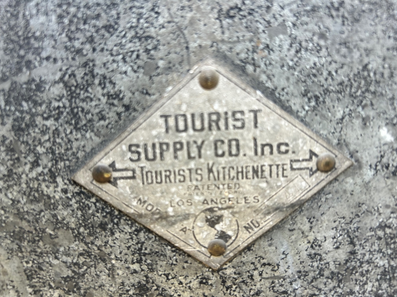

Are they as simple as they seem. This would be black only, but how is color? I imagine color over white should come out okay. I might want to reproduce the manufactures decal.
This is what is left of that decal: It is different than other ones that I find online.
Matt
- Posts: 4688
Re: Decal block letter suggestions for my running board Tourists Kitchenette
It’s amazing it lasted as long as it did over the years. There are people that reproduce these types of emblems. If you send a really clear picture to them and the size they can fill in the missing lettering and etc. Or you can do it yourself and then glue on the reproduced emblem.
Check out Radiodaze. They deal with old and antique radios and parts and reproduce similar emblems on antique dials , lettering and etc. There are other sources besides this company that may do it too.

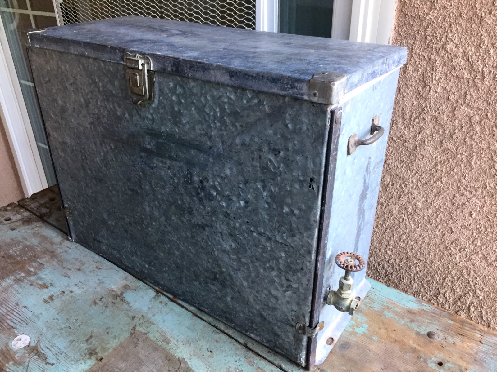

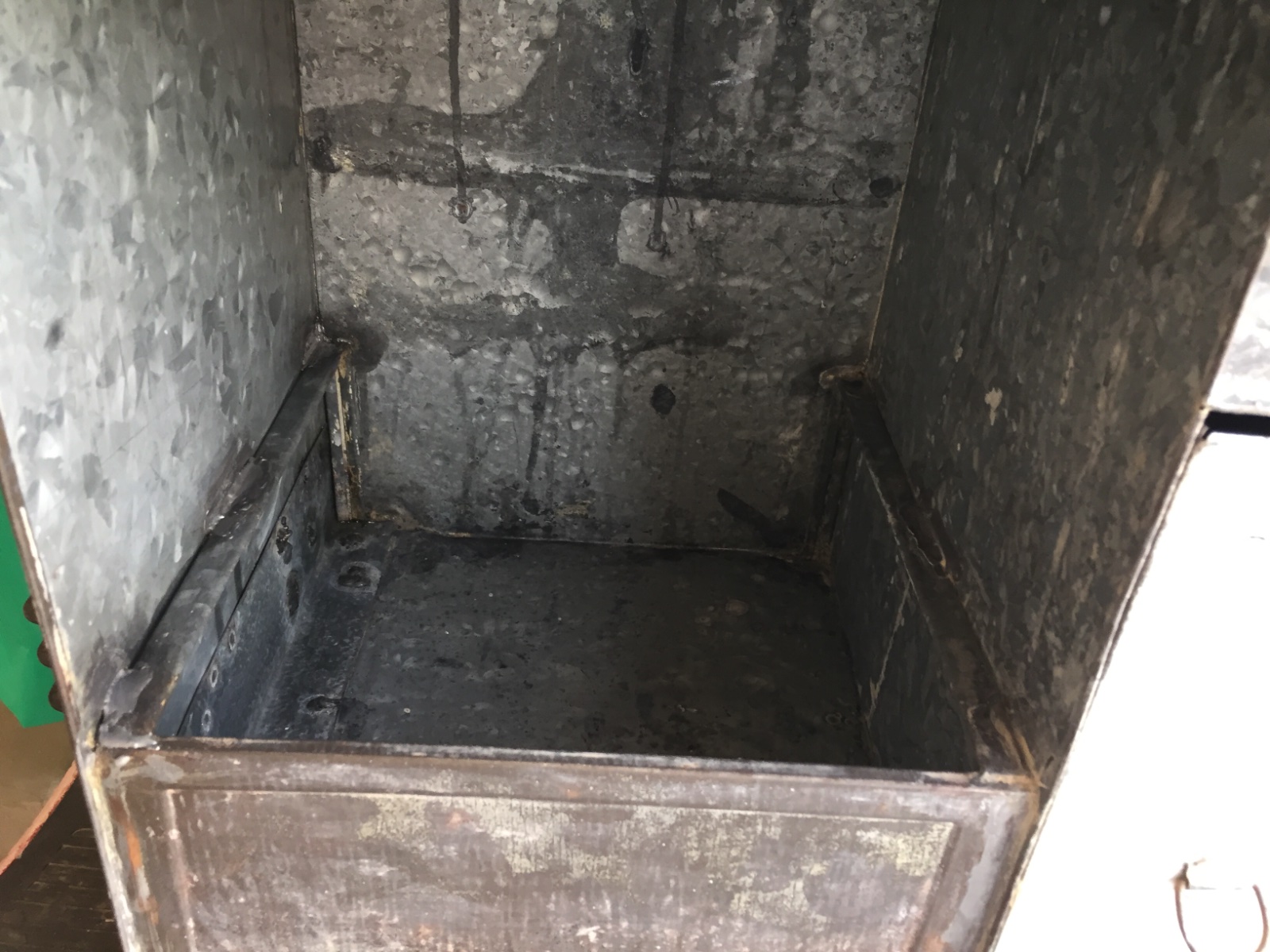

Matt
You likely already know but just in case painting over galvanized metal takes some special steps
https://home.howstuffworks.com/home-imp ... -metal.htm
Primers
https://www.rustoleum.com/pages/search- ... l%20primer
Also do the inside & seal it to make it safe
Is Galvanized Metal Safe for Food?
Our galvanized steel buckets and tubs are popular for keeping drinks in their containers cold. However, galvanized steel does not meet USDA food safe serving standards for acidic foods; like tomatoes, pickles, fish and fruit juices. Galvanized metal is not safe for cooking or storing food. Foods with low acidity do not react with the galvanized steel and, according to the USDA, are safe to serve on galvanized steel.
We recommend when serving food from galvanized containers, line your galvanized tray, bucket, or tub with wax paper, parchment paper or plastic wrap. This way you do not have to worry about properly identifying your food as a high-acid or low-acid food.
The acid in some foods will react with the zinc coating to form salts. An excesses consumption of these salts could cause a mild sickness. Although these salts are readily absorbed by the body, we recommend getting your daily dose of zinc directly from the foods you eat: try pumpkin seeds, garlic, dark chocolate, sesame seeds, or chickpeas.
Zinc toxicity symptoms begin 3 to 12 hours after ingestion and include: diarrhea, vomiting, fever. Milk should be given immediately to an individual with zinc toxicity and professional medical help should be sought. Milk helps neutralize the digestive tract with too much zinc.
If your heart is set serving food from a metal bucket, try our food-safe easy to clean 13 quart stainless steel water bucket is rust and scratch proof, odor-free, hygienic and dishwasher safe.
Is It Safe To Cook With Galvanized Metal
Cooking vessels, utensils and food storage containers are generally not made out of galvanized steel. There are, however, the infrequent accounts of galvanized containers like trash cans and tubs being used for big cookouts or parties. People do it. But is it safe?
Zinc fumes are set free when galvanised steel is heated. These fumes are very toxic to breathe. Deposits of zinc from the fumes accumulate in the food. Utensils like ladles and galvanized-surfaced pails should not be used for food cooking. There are no USDA certified-safe galvanized metal cooking surfaces or containers.

You can do an online image search using any number of search phrases such as:
Gold leaf fire engine lettering.
Ornate gold leaf fire engine pinstriping.
Old West gold leaf letters (Lettering).
Wild West gold leaf lettering.
Fire engine lettering applicators.
Note: For different images and results you can substitute fire truck for fire engine.
If you do an image search and click onto an image you like, it will usually have details about the photo such as where the letters can be obtained or who did the application. I did an online search for “Fire Truck Gold Leaf” and found a guy name Bob Bond who has a website showing all the fire engines he has done. I got the below picture from his website. See: www.bobbondart.com. Perhaps if you contact him he can point you in the right direction on how to get started and where to obtain the lettering supplies or he might even help you. Jim Patrick
PS. I believe you can remove zinc and galvanized finish with muriatic acid. When I was a kid, I used to remove zinc from 1943 steel Lincoln Pennies to make them look like new. It will also remove any rust. Be sure to mix a bucket of baking soda in water to thoroughly neutralize the acid. Immediately dry with a towel then heat with a heat gun to rapidly dry it to minimize the formation of surface rust before painting.

In my opinion, each word label on the various drawer fronts are paint that was applied with a rubber stamp.
If it were me, I would obtain rubber stamp set with with similar size font and emulate what was originally done. I would clamp the respective stamps together to form the desired word and then use some sort of guide when stamping the drawer fronts.

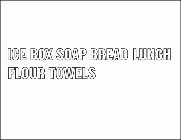

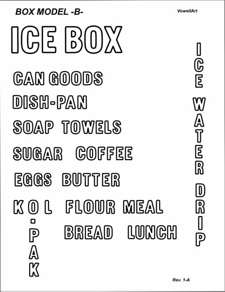

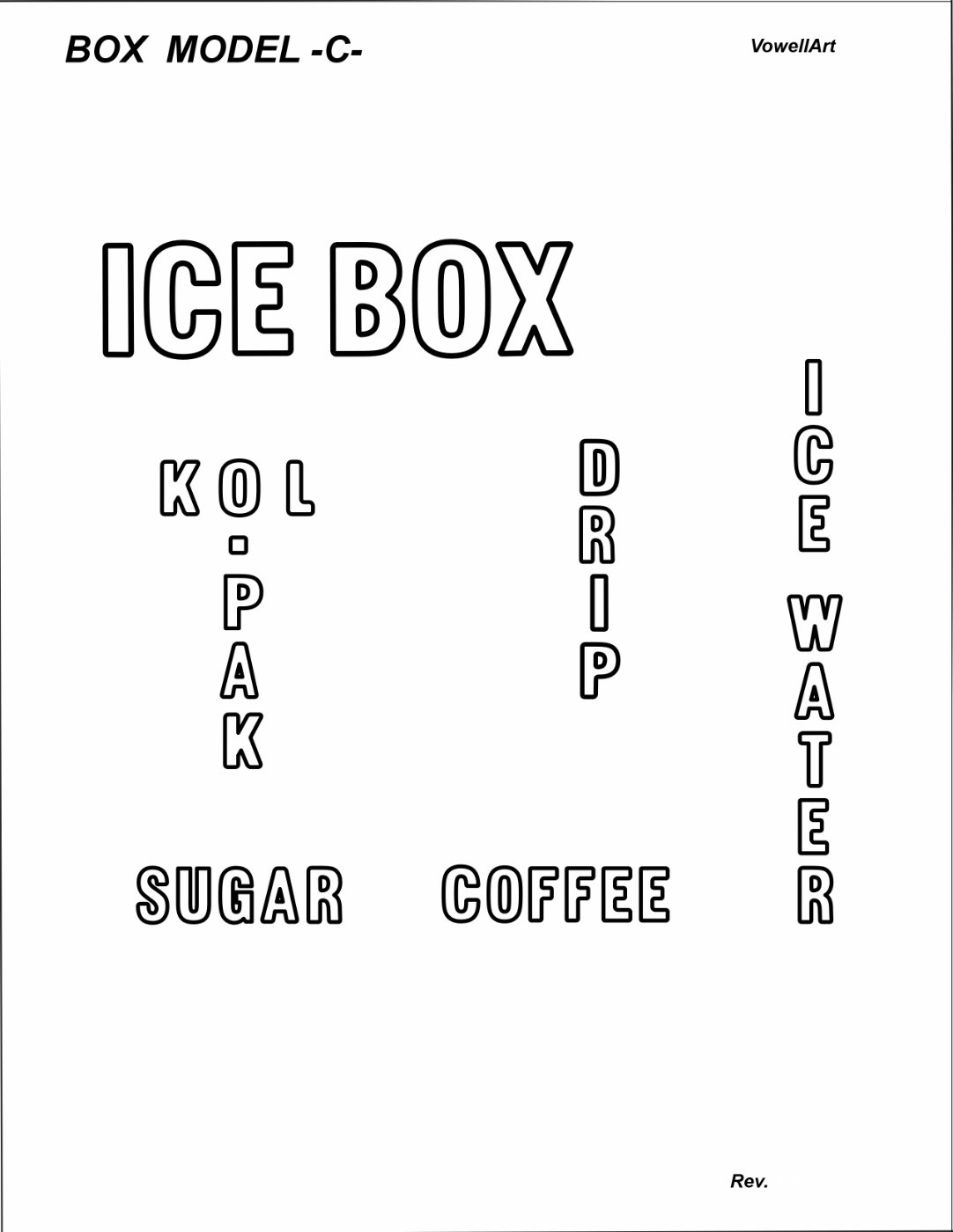

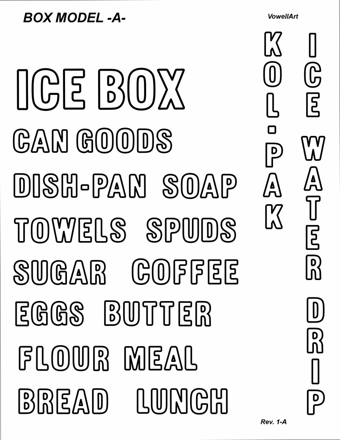

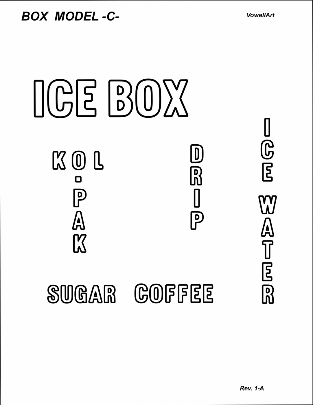

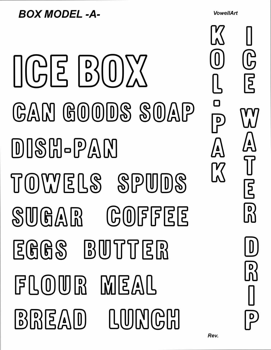

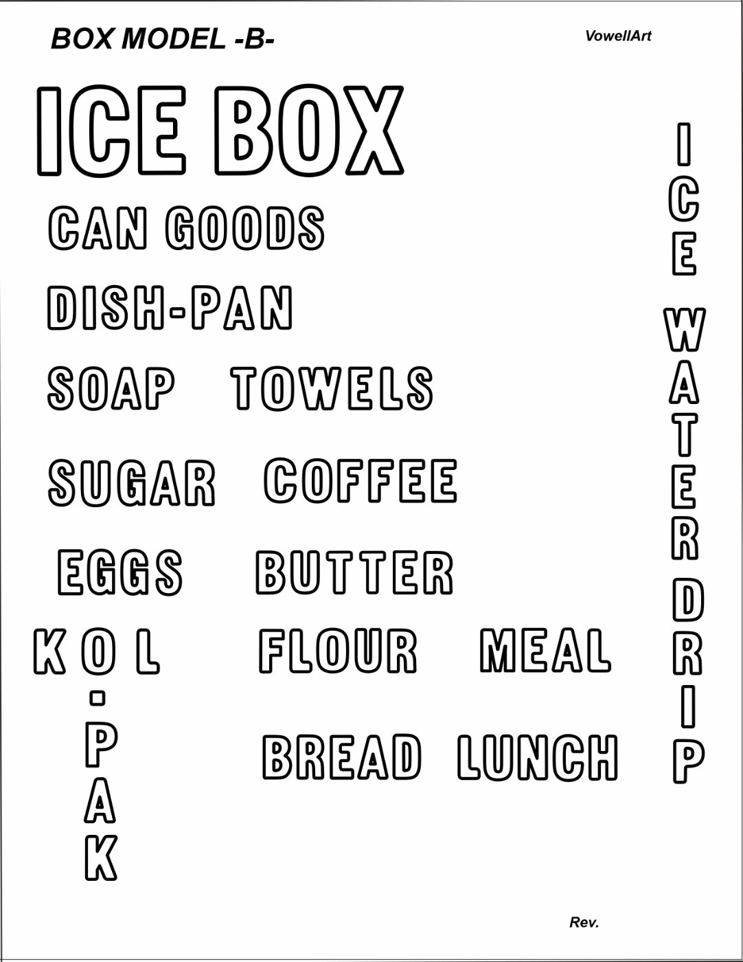

Your text is known as Gothic No13 BT in the "True Type" font case. It's a condensed font, but needs a bit of modification for the middle of the E and the lower arm of the F and the letters have to be outlined not solid. These were probably a "Varnish Transfer" like you see on Piano Fallboards. They would be applied with a thin coat of same color paint and transferred (your pictures seems to suggest this, because the centers of the letters appears to be slightly lighter shade than the rest of the drawer). It takes about 2 seconds to do each drawer that way and the position indexing onto the drawer would be absolute with no possibility of smudging.
I could set this up for you, it would be pretty easy. I have over 1200 fonts available to me and if I can't find it (like if it was a "hand laid font" I can copy it and put it into any format you like. I can even do the lids logo art too. After all, this is what I do kiddies!

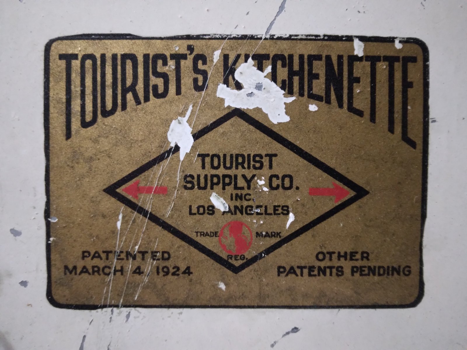

John,
I have seen other photos of decals for these cabinets, but this one seems different.

Paining zinc- I am aware of the issues. That is in part why I was considering not painting.
Zinc and food- I was not aware of the concerns. I know in industrial settings only stainless steel is acceptable. Even painted metal in contact with food is not considered acceptable... For me I was intrigued by the novelty. I plan to keep food not in contact with the metal. I am surprised no one brought up the lead solder joints.

I was thinking this was purhaps rubber stamped paint too. But Martynn seems to be an expert...
Martynn,
I would love to get your help. You are amazing to recognize the correct font! Here are the words on my box (some variation to other ones listed here.)
I would have to research how varnish transfers work, but if you could make this on a PDF I could print and verify size/layout for now.
Thanks everyone!

Erik,
Martynn,
- ICE BOX
- TOWELS
- BREAD
- DISH-PAN
- CAN GOODS
- COFFEE
- KOL-PAK (written vertical)
- DRIP (written vertical)
- ICE WATER (written vertical)
Thanks everyone!
Matt
Matt, okay so ICE WATER is 1" (72 pt) and the rest are 3/4" (54 pt)?
Ummm, from what I can see, it looks to be all of the drawers may well be 3/4" (54pt), but the 1" (72pt) Is ICE BOX, not ICE WATER (of course if you want ICE WATER that size too, it's your choice). Although I'm not quite sure that the lettering is 3/4" (54pt) of the vertical text is the same as the rest of the drawers, they look a tad short, but who knows maybe it's the angle...just verify those letter heights and give me the length of the vertical text for each string and their line weight (thickness) for both the 72 and the 54 pt type and I'll send you the PDF. Do you want me to post it here or PM you with it?
Oh I noticed on one of the pictures that there are some dots between BREAD and LUNCH, do you want these too? I need to know the size of those dots as well and their spacing. Do you also want the lid's logo? If you do, let me know. It appears be be a paper logo that the paper turned yellow over time (I'm guessing), because of the trim on the border lines and the leftover outside of the line (means it was machine cut and incorrectly indexed) which sort of indicates it to be a paper logo and the paper probably was white, like the unit. The red looks to be Pantone 1797 (Cherry Red) or 485 (Stop Sign Red), can't really tell from a picture though, but either one of those would be so really close to the original....just depends upon how vibrant you want it to be...1797 is more saturate (richer) than 485, being a tad lighter.
I'm going to set these up in CYMK (Cyan, Yellow, Magenta and Black), if you choose to print these on a RGB printer or in Grayscale, let me know because I'll have to change the color register.
I just had a different idea....can you take a full frontal picture of your unit (or if they're not really very visible, just a close up of each drawer would work too? Just their fronts, no angles....don't worry about the size, I'll make the text and fit it to your picture, that way when I enlarge it should the correct (line weights and all).
And send them as Jpgs to my email address vowell@vowellart.com

Matt, I just thought of something concerning your unit....what kind of paint did they used to paint over that text? If is some sort of lacquer, it may be possible to remove it without harming the text underneath. But that also depends upon what that text is too. If the Text was applied as a varnish transfer, then lacquer thinner won't damage it at all. Ever do any wood graining on metal? The first coat is always the whatever wood you're doings base color in lacquer, then the grain itself is made with printers ink. The reason is because if you don't like how it turns out, you can wipe if off with printers solvent and start over. The base coat won't be touched by the solvent at all. But once you get your grain the way you want it you'd coat it with either clear lacquer or clear coat. I did that with my Model A's interior window mullions and the dash and it looked just like mahogany (I also added some pearl to the base coat to get that deep sparkle that mahogany has).
But this all depends upon whether or not they used paint for those letters of printing ink. Even though to my mind they would've probably used Printers Ink rather than paint, because the ink would've been cheaper than the paint and it would make it easier to correct mistakes (because they could simply wipe it off and start over again).
What you're going to do is to try and remove just a tad of it from around one of your letters, to see if this is true or not. If it also removes a bit of the letter stop! It's something else and we'll have to go about like I said in my previous post....but it's worth a try, you might not have to do any lettering at all if they're still nice under that very sloppy paint job.

Did some searching to find out what paints are food safe. This is a good reference https://painttopics.com/food-safe-paint ... tal-glass/Matt in California wrote: ↑Sat Sep 02, 2023 3:23 pm......
Frank,
I appreciate your comments. Here are some responses:
Looks like Rust-oleum has several acceptable choices, but need to read the labels associated with the pictures to be 100%. The ceramic paint sounds good for the inside of the bins as well as the outside

Wow! What a wealth of knowledge here on the forum. When I originally posted I was hoping to get some direction to find some ready made decals that would be close enough... It is a learning curve for me to understand making custom decals.
Martynn,
I sent you photos of each decal. I see a few things I misstated above. I thing the photos will answer that. Regarding the paint I saw in early advertising that it was painted with enamel inside and out.
John & Allan,
We are on the same page regarding food safety. I can always put things in packages...
Mike,
I appreciate the detail you gave on making decals. If I can find an original decal for the top to reproduce that would be great insight to use!
Frank,
Thanks for the insight about the paint. If I go to the trouble to paint it, It would be worth the trouble to find the best paint. It will be a challenge to find food grade that works with galvanized.
I really appreciate everyone's help!
Matt
Martynn,
John & Allan,
Mike,
Frank,
Matt

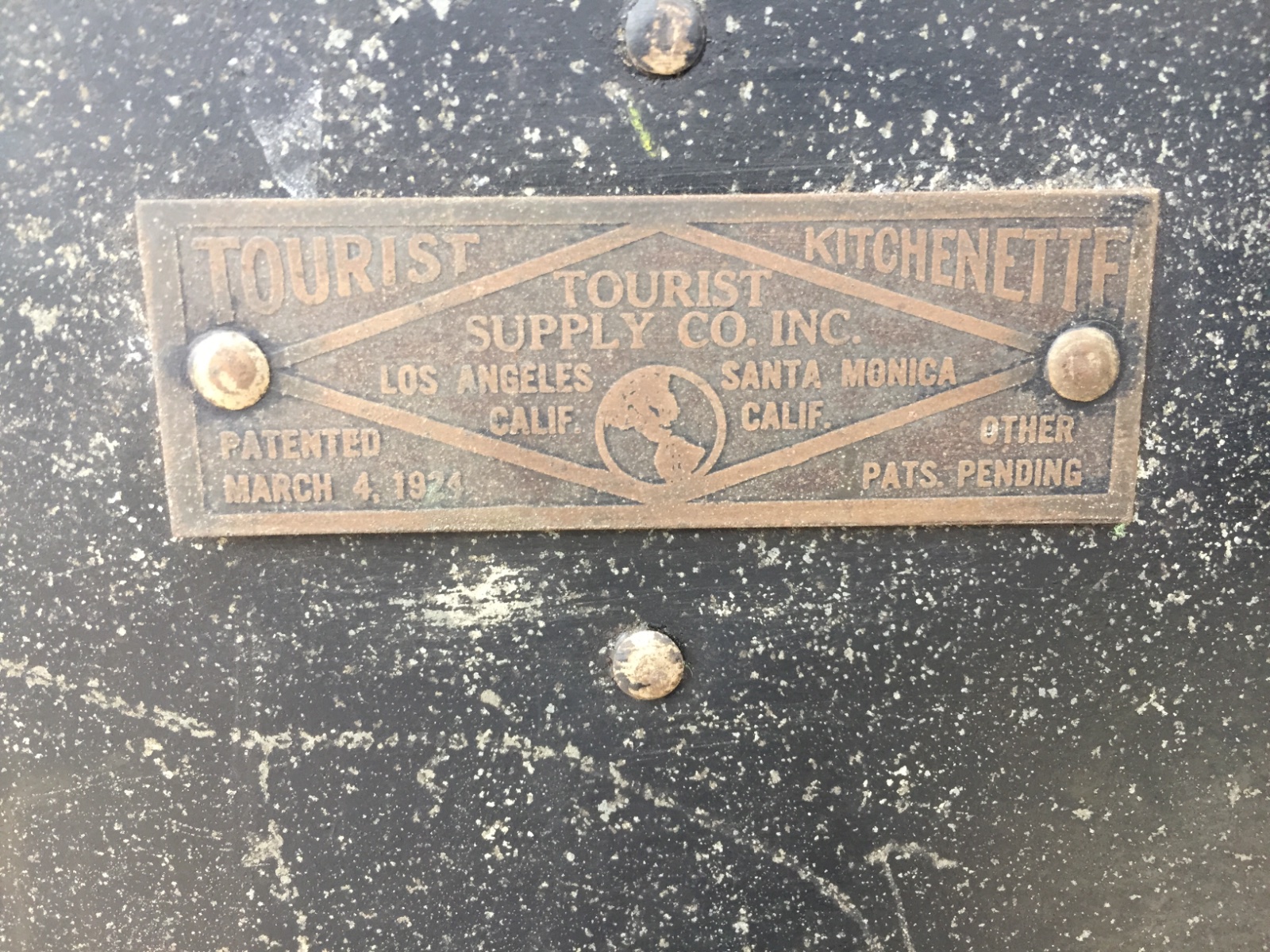

I am working with Martynn on the decals graphics. He mentioned that the decal on my is not the same as the others. I looked it up and found that it is "ALBATROSS STEEL EQUIPMENT COMPANY". I found key pit of evidence on google from 1928 (Source "Engineers": Listing of the Engineers of Corporations Page 148):
In my searches for advertising it seems that the "Tourist Supply Company" disappears about the same time. I am going to assume that Albaross took over around 1928. I imagine a luxury item camping equipment in the late 1920s was not a good seller and it probably didn't last long in production.
The cabinets are virtually identical except the top on my Alabaross is flat unlike the beveled one from the Tourist Supply Co.
Just looking at the logos on this tread I see three different logos. If someone could take a photo next to a ruler of each of the Tourist decals that would be helpful for Martynn.
I have done a search for Alabaross Steel Equiptment Co logos and not found anything. I image that the same decal could be on a medical or bathroom cabinet. This was my closed find, but unfortunately the person didn't post a photo of the logo before selling the cabinent: https://offerup.com/item/detail/2b83042 ... b2?cid=8.3
The issue with my is that it is partially removed and most unfortunately where the trademark was. Yes, I could take off some of the paint remaining, but I am afraid I will damage the logo more.
Matthew
BTW Sawtelle is in LA California. The same as the Tourist Supplly Co.ALBATROSS STEEL EQUIPMENT CO . ( Medicine cabinets , hospital furniture , refrigerators , kitchen cabinets , toilet partitions , tourist kitchenette ) Offices and Plant , 12,416 Exposition Blvd. , Sawtelle , Calif .
Matthew
I have been going back and forth Martynn and there is some great progress on the graphics.
After doing some searching and looking at what is left of the decal I figured out the first words were: THE ALBATROSS LINE https://www.google.com/books/edition/Ca ... frontcover
This solves the mystery of the missing trademark. Also the words are slightly different because company name and location is slightly different.
Fount is not correct, but gets the point across.
Amazing stuff!
Matt
Amazing stuff!
Matt
Good job! On your original decal, I can make out a long horizontal tail going to the right like on a songbird. While in real life, the Albatross has somewhat of a stubby tail, the bird on your original decal does not appear to have the tail of an Albatross, but maybe the original artist did not know that, but I assume you want to be accurate with the original decal. On the original decal the wing tip appears to extend beyond the upper right border. Also the lower portion of the wing appears to be raised as if in a flying position. In order to add a longer horizontal tail, you would need to revise the wing into more of a raised flying position with the wing tip extending beyond the border. Also, on the original decal, the left leg is almost straight down and the right leg is angled downward to the left of center as if it is walking. Jim Patrick
Matt,
I think you hit it with the exception of the text.
It's pretty obvious that the Albatross Co. moved from Portland to Los Angeles at some time and changed their name to equipment co. from furniture co. I think the confusion on the bird artwork may be due to the damage to the original decal. I'm willing to say that the artwork for the bird on the logo you discovered is the same as the one on your lid.
Measure your original decal. Take a copy of the one you found. Size your new artwork to match the length and width of the original in Photoshop. That is, if you have access to Photoshop. You can then change the script to match the original. Photoshop has a program to come pretty close to the blue color background in the diamond. Print that out on a piece of clear decal paper using a standard inkjet printer.
As I stated before, you can then cut out an oversized piece out of the clear decal you just printed. Wet that and slide that onto another piece of decal paper sprayed metallic gold. You can then trim the decal to the proper size and shape.
If it turns out that there isn't enough water soluble dextrose (glue) to adhere the clear decal to the gold, you can apply a thin coat of gold leafing sizing to the gold decal surface to help with the adheasion of the top decal.
Just a side note. Boyco, the company that made the running board emergency can sets, was located in two California towns. Los Angeles and Alameda. I have a can set for my car that when I found it, it had a near perfect original decal. I had a high-resolution photo taken of it. I imported that into Photoshop and copied it. Made it really easy to make more. That way, I didn't lose sleep over sand blasting it.
Good luck.

We are making great progress with the graphics that Martynn made.
One interesting thing was I found the clear tape would pull off most of the paint showing the original paint. To me it looks like glass antique white would be close.
Yesterday I had a great conversation with Mike. He had an amazing job at the toy company making decals. Hard to imagine that was his full-time job. This was not for production this was for prototypes. As stated in his tagline he really wants to share any knowledge he has. What a blessing for this community and myself in particular!
Mike’s advice was to buy laser decal paper print them out and as he mentioned it will be a multi-step process with the logo. For now, I am waiting for the decal paper. I want to make the decals before I remove all the paint so that I can compare...
Matt
Matt

Progress update.
I stripped pint off of most of the main box. The lunch box area alone took me a few hours. Now I realize that it will be a lot of fun to paint such a small area! It had a nice original paint in it. But it look like someone put a pie in there that spilled over perhaps taking it for a ride
I painted one drawer and put some of Martynn’s artwork on it. It looks amazing! I have never used printable waterslide decals. It is really easy and straightforward. But one discovery is that the tuner can rub off so I will need to spray clearcoat over the top.

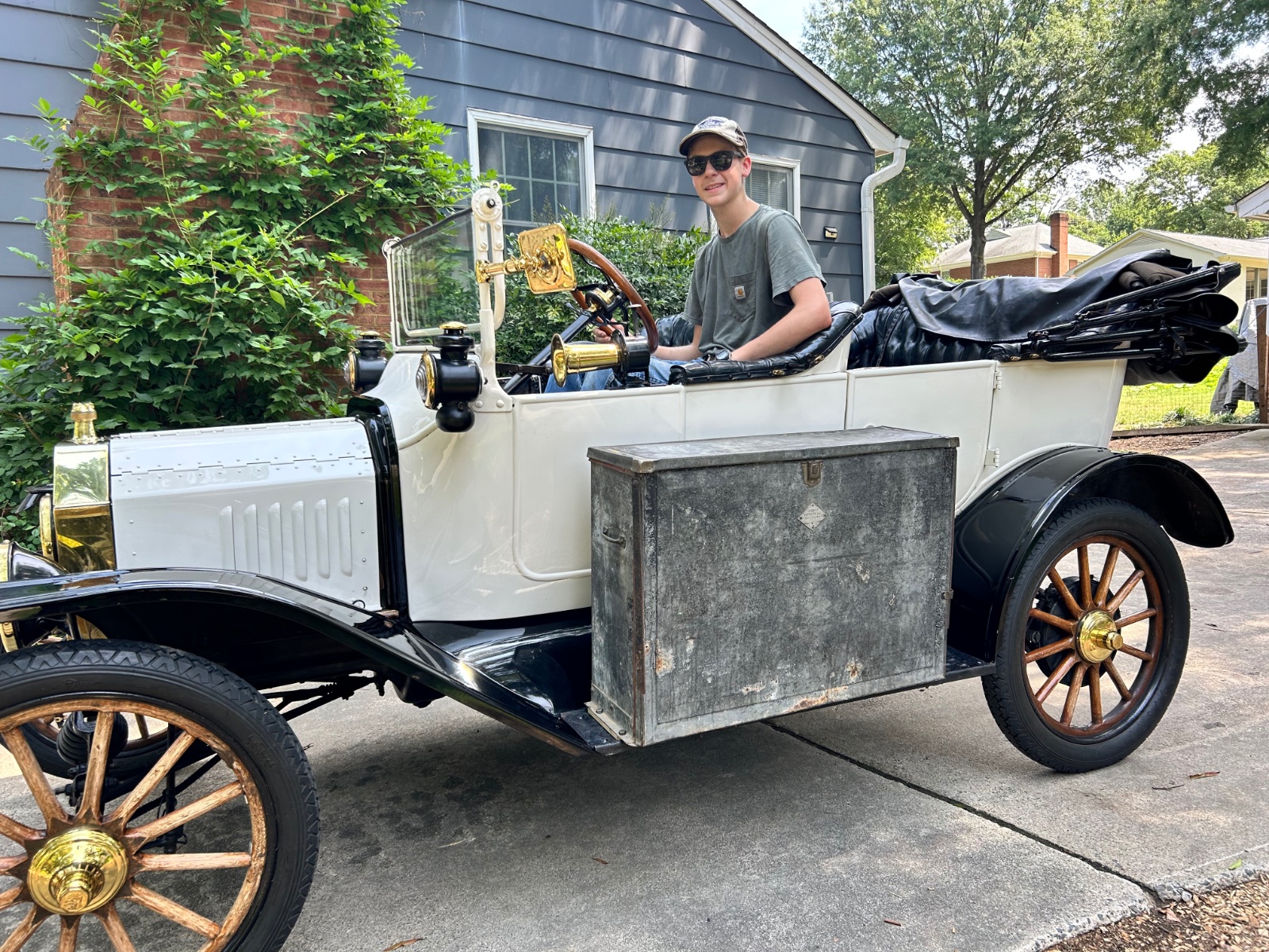

We mounted one of our on our 1915 touring. We used a donor running board to avoid drilling holes into our original running board. Fairly sturdy.
1915 Model T Touring

Alex your box looks great! I see you’re is a larger one. Mine doesn’t have much black paint on the outside either. How does the inside look on yours? Feel free to post photos.
Matt

The hold up has been the need for reinforcing the left side where the bottom had partly torn away, perhaps because someone was sitting or stepping on it.
I was waiting to find a spot welder. When I got one it was only large enough to do the spots close enough. I ended up using my wire feed with a hole drilled in the top sheet then I welded through the hope in the top sheet with a chunk of brass held against the back side as a heat sink to prevent blasting through. The inside space was very tight. But I managed to I got it to hold together.
I then needed to solder back the self that the drawer slides on. I should have ground down the welds, because now that is not an option.
Now the bracket is added. On the outside it looks fine.

It has been a year and now I have a significate progress photo.
I was able to paint, decal and clear coat the main cabinet. I still need to finish the three drawers and the front and lid. The lid will likely be the last part as I learn how to make a multilayer decal. The paint is not perfect, but I plan to use this, so it will soon get many more defects...
Many thanks to Martynn for the decals. I hope these can be shared perhaps under accessories with the other drawings Martynn made for MTFCA.
Again thanks for all the interest!
Matt
Matt

More Before and After
Video
Here’s a video I made describing the restoration.
https://youtu.be/_N2BURcOSOo?si=0r_Jk7X9QXmJawBe.
A very special thanks to Martynn Vowell for designing the decals!

Here is a pic from last weekend. It got a lot of looks. In looking at the pics of the other kitchens here, I’m apparently missing the inner lids for the ice box and water tank.
I’d love a set of lettering or the source file (I can laser cut them out of vinyl).
We drove 100 miles on Saturday. The kitchen handled great. The lid clasp is missing so I tied the top lid down to prevent it popping up and causing the panel to open up. It’s a fun accessory you don’t see often.

Did it look anything like this one or the one above?
Fun never quits!
Martynn,
I believe the letters are all the same size except for the ICE BOX. I believe 5/8" all other letters. The letter spacing you could do similar to the other words. If you could fit all the words on one 8x11.5 pdf it would be ideal, so anyone could print decals.
Box Model A
ICE BOX
SOAP TOWELS
BREAD LUNCH
DISH-PAN
CAN GOODS SPUDS
EGGS BUTTER
SUGAR COFFEE
FLOUR MEAL
KOL - PAK (vertical)
DRIP (vertical)
ICE WATER (vertical)
Box Model B
ICE BOX
SOAP TOWELS
BREAD LUNCH
DISH-PAN
CAN GOODS
EGGS BUTTER
SUGAR COFFEE
FLOUR MEAL
KOL - PAK (KOL horizonal - PAK vertical)
DRIP (vertical)
Box Model C (I am still looking for an example with all the lettering, but I believe the following is correct)
ICE BOX
SUGAR COFFEE
DRIP (vertical)
In short if you make the words for Model A. The only words perhaps you could make for both is the KOL-PAK both all vertical and horizonal / Vertical.
Thanks!
Matt

5/8" for all the other letters would be pretty small (just a wee bit bigger than 1/2"), you sure you don't mean something a bit bigger, like say 3/4" for those letters. Also not all the letters are the same size....Eggs and Butter for instance are smaller, now they may be 5/8", but the rest of those (with the exception of "ICE BOX" aren't.

Here are the measurements of the decals you made on my box:
Donnie Could you measure the original decals on your large box to confirm the size?
Thanks!
Matt
Thanks!
Matt
Matt in California
Topic author - Posts: 823
- First Name: Matt
- Last Name: G
- Location: California
Martynn,VowellArt wrote: ↑Tue Oct 01, 2024 7:55 pm5/8" for all the other letters would be pretty small (just a wee bit bigger than 1/2"), you sure you don't mean something a bit bigger, like say 3/4" for those letters. Also not all the letters are the same size....Eggs and Butter for instance are smaller, now they may be 5/8", but the rest of those (with the exception of "ICE BOX" aren't.
Donnie has the large model Kitchenette and he measured his cabinet. All the letters measure 5/8" except the "ICE BOX" that measures 1"
Thanks!
Matt

Did he measure SOAP, TOWELS, BREAD, LUNCH and DISH-PAN? They look a bit larger than those other letters...it may be an optical illusion and I might be a bit over cautious, but I'd like you to check and make sure, if you could please.
Oh and did you also want that diamond logo on the under side of the lid too? If so, just send me a picture of it and give me a measurement of it (length, width).

Ok, look at these and tell me if they're correct or not.
Camping Box A 1 inch "ICE BOX" and all other letters "5/8" inch.
Camping Box B "ICE BOX" is 1" and all other letters are "1/2" inch.
Camping Box C 1 inch tall "ICE BOX" and all other letters are "1/2" inches tall.
Fun never quits!

Martynn,VowellArt wrote: ↑Thu Oct 10, 2024 3:34 pmDid he measure SOAP, TOWELS, BREAD, LUNCH and DISH-PAN? They look a bit larger than those other letters...it may be an optical illusion and I might be a bit over cautious, but I'd like you to check and make sure, if you could please.
Donnie is on a excursion with camping set-up. When he gets back he can get in touch to confirm. But here is my response:

- To me all the line weight looked the same on mine.
- The font size should be the same for everything except the ICE BOX
- Donnie can print the logos and compare (like I did in the photos above)
Thanks so much for your help. I believe others will use the letters because the paint hasn't lasted on many of these for 100 years.

You probably wouldn't notice the difference in line weight, since the larger letters are 0.04 and the smaller letters are 0.035. The difference is hardly noticeable, but when it comes to ink and print bleed it is necessary to make some adjustments to thickness, even if you use some sort of copier, it still bleeds alittle.
Matt
Made a revision, some of the letters looked a bit narrow for the type face, so had to change them a bit, also added more curves on F and M, also took out the "muddy" look of the letter M (too many extra nodes, which made superfluous curves that just ruined the structure of the letter in comparison to all the other letters). Also changed the line widths back to 0.04 on the Boxes B and C. Having changed some of the letter widths, it changed the parameters vs line width, so, I was able to change them back to the original width without the probable "fill-in", (I hope).
Box A didn't change line width wise, but the letters themselves did (the C, G, D, R, E, F, M, A and S), so got numbered Revision 1-A.
Box B, no changes other than their line widths back to 0.04. Revision 1-A.
Box C, no changes other than their line widths back to 0.04. Revision 1-A.
After looking at these, compare them to my first posting and decide which line width you like better and I'll make the correction.
Matt,
You mean the diamond shaped logo, like the one here?
That's a metal plate with a silkscreen (and the idiot assemblers put the bloody rivets in the wrong place, they're supposed to be on the outside of the lines, not inside. The image is never supposed to be compromised that's what the curves on the points is for, to locate the rivets OUTSIDE of the image).
There are two ways of doing the logo (maybe one other, but the registration would be really critical and probably impossible).
1) Dye Sublimation, on a piece of white coated aluminum). The image lasts a really long time and is scratch resistant. It's really good for both black and or full color imagining (I used to make Christmas ornaments and funerary remembrance plaques with it, (dye sub my image off on a piece of Nickle Brass, then roll it onto an Engraving Lathe drum, then make any words in black and print on a printer, mount that to the copy drum of the Lathe. and it cuts the black image onto the Nickel Brass, it remove the Nickel from the plaque, revealing the bright brass beneath. The result was a really fancy Christmas Ornament or Funerary Plaque, custom made in full color with gold lettering and or detail imaging like Rosaries, Crosses whatever the client wanted).
2) Laser engrave on a piece of white/black "Rowmark" plastic, any engraving store will have it available and be able to cut it for you (and probably drill the holes for the rivets too), from any file format including Jpeg.
And then there is the 3rd way....print it like you did these other decals you've made. And if you make the 2 color version, you'll have to run it off on a color copier (preferably a laser color printer).

Martynn, Sorry for the delay. I finally got a chance to check the measurements. Here is what I found.
1. All small letters are 5/8 inches tall on all three sizes of Kitchenettes. But they can vary in height up to +1/32. The letters even vary on the same Kitchenette. No letters were less than 5/8 inches tall. But most of the +1/32 taller letters were on the medium type B Kitchenette.
2. The words EGGS and BUTTER are 5/8 inches tall but narrower fonts.
EGGS letters are 1/4 inch wide and overall length of word is 1-5/16 long.
BUTTER letters are 1/4 inch wide except the tops of the Ts are 5/16 wide and overall length of word is 2 inches long.
EGGS and BUTTER are on the large kitchenette.
I will post a photo of the EGGS BUTTER drawer and the drawer below it to show the difference in the font spacing.
3. The photo of the silver diamond logo is on the inside of the large type A kitchenette lid. It is 4-1/4 inches long, point to point, and each side of the diamond is 2-1/2 inches long.
4. The photo of the gold logo is on the inside of the medium type B kitchenette lid. It is 3-1/2 inches long and 2-1/2 inches tall.
5. The photo of the front of the small kitchenette shows the letters I was able to reveal with lacquer thinner and steel wool. It is possible to read all the words except the ICE WATER tank letters. But it is reasonable to assume that is what was used on the tank as the other two sizes also used ICE WATER letters.
I believe the best thing to do is to make all the letters 5/8 inches tall except the ICE BOX letters that are 1 inch tall. and make the EGGS BUTTER letters and words to the scale mentioned above. Since the letters are not consistent in size, 5/8 inch seems to be the best compromise. I assume that the spacing of the letters will be what looks good for each word??
Let me know if you need any more info
Martynn,VowellArt wrote: ↑Mon Oct 14, 2024 7:33 pmMatt
After looking at these, compare them to my first posting and decide which line width you like better and I'll make the correction.[/size]
Thanks for your patience in my response. I was talking with Donnie and offered to print him out the decals. But then I realized I needed a PDF version to get the resolution. Is it possible that you could add that here on the forum? If not feel free to email it to me.
Thanks!
Matt and Martynn, the rev-1a drawings look good to my eye except eggs and butter on the type A do not look like the "scrunched together" letters in the photo of my type A. I believe they have to be "scrunched together" on the type A, to fit into the shorter recess caused by the area for the finger pull handle. As long as the overall length of those words is the same as I mentioned in my post above, I think everything should work OK. It appears that they "scrunched" them to keep the end margins the same or similar in both lengths of recesses to match or appear similar to the two drawers below the eggs/butter drawer. The eggs margin is bigger but probably is a compromise to keep the font the same in eggs/butter words.
Martynn, you're a bit harsh on the "idiot assemblers". The rivets they were given have heads larger than the reliefs in the artwork outline. Perhaps the blame lies with the designer who made the reliefs for the rivets too small.
Allan, you're absolutely right, probably not the assemblers fault at all! Probably the Designer/Engineer who drew up the assembly in the first place (I've had my "beat head against wall" moments with a good many of those folks in the past), but even after all the checks and rechecks that their department does, their department heads would send the designs to the "Visual Communications Department". A rather fancy term for Photo, Art, Reproduction and Book Binding....my department , knowing full well that if there was any mistake(s)...we'd find it (and we always did). However it never hurts to have extra sets of eyes on any project, something that Henry Ford left most times to everybody from the engineer who designed whatever part it was on down to the customer who would either fix it themselves or drag it back to the Dealer to scratch their heads over to figure out how to fix whatever it was.
I'm thinking that the reason for rivets of that size is because whatever is on the other side of that lid needed them to affix it firmly to the top of the lid....like a handle to open the lid with, maybe? So maybe what they should've done was make that stupid logo bigger (since they went through the expense of make a silk screen anyway).

Okay, Donnie and Matt; I've had a spot of trouble with my program (the subscription ran out), so I've had to resort to "free trial" versions. The one I'm using currently is the basic one and is seriously limited in what I can do and or how I can do it and since it is a "Free Trial" I've got a limited amount of time to use it (currently 12 days). So what this means is that I've got to finish what I was working on when things went ka-blooy on me and quit. Then I can make whatever corrections you need, post them here for your approval and then translate them into PDF's and send them directly to you guys, how's that sound? I'll also post them here on the Forum as well, but they'll be in JPG format.
If my trail copy quits on me, not to worry, there are 3 different versions of this program and the other two offer a "Free Trial" as well, I'll offload the one I'm using (and would never buy anyway because of it's "limitations" design-wise) and load one of the others and continue on as I've already suggested. One way or t'other we'll get this stuff done!
Martynn,
I hope all is going well for you. Sorry to hear about your PDF headache!
Donnie and I both agree what you have come up with looks great! I would just need the PDF. (I tried to print what is in the gallery here on the forum and couldn’t seem to get that format to work.) I believe the PDF will keep the crisp lines and size.
Thanks so much!!!
Matt
