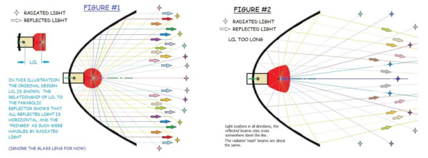

These seem to work well. The Ford headlight reflector isn't needed to focus the beam, it is all internal to the bulb. https://www.logolites.com/products/led- ... eadlights/

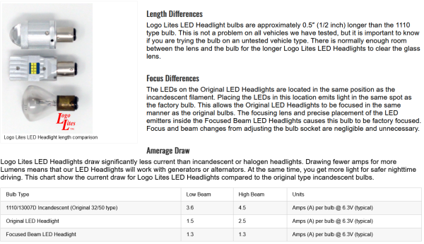

Logo Lights look like a good alternative to both filament & other styles of LED light bulb.

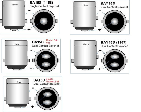

The Model T headlight socket is either BA15S (single beam) or BA15D (hi/Low Beam). The issue with using non standard bulbs is the that source of the light needs to be basically a pin point to be adjusted into the focal point of the reflector. Its important to understand that the reflected light is then projected onto the fluted lens that projects a light beam out onto the road (or wherever). The PROs & CONs of switching to LED bulbs are less amperage draw and apparent brighter light. However their designs don't emit their light into the focal point of the reflector. Actually this is not much different than an original bulb not being adjusted properly. This diagram illustrates the result. So if you would look at the headlight directly an unfocused bulb would make the headlight lens look brighter than properly focused one. Its also important to know that the color of the light (warm 3500, daylight 6000) will make things look brighter (actually whiter) when in fact the same amount of light, measured in lumens, is reflect onto the surface.
The specifications for the Logo Lights indicate that both the Low & High beam light sources are relatively at the some point allowing for the lens to focus the light properly. As I indicated early the fluted lens is design to focus the light, so I'm uncertain if this will interfere with the Logo Light beam.
While the objective is to illuminate the road at night (note I didn't say brighter headlights) the decision to change light source, falls back on amperage draw. In looking at the specifications for the Logo Lights, the amperage draw is outstanding for Low & High beam. Since it a focused beam, the condition of ones reflectors is of less concern. In fact a bit hazy one may disguise the presence of the led.
I would prefer these at 4000K over the Logo Lights 6500K for a more period look ($35 vs $49) shipping for 1 bulb

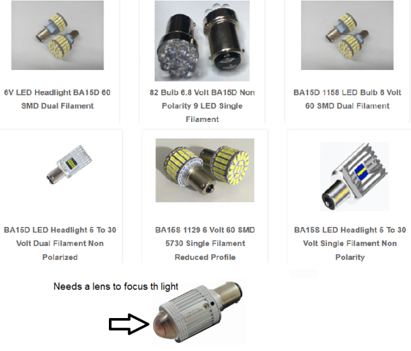

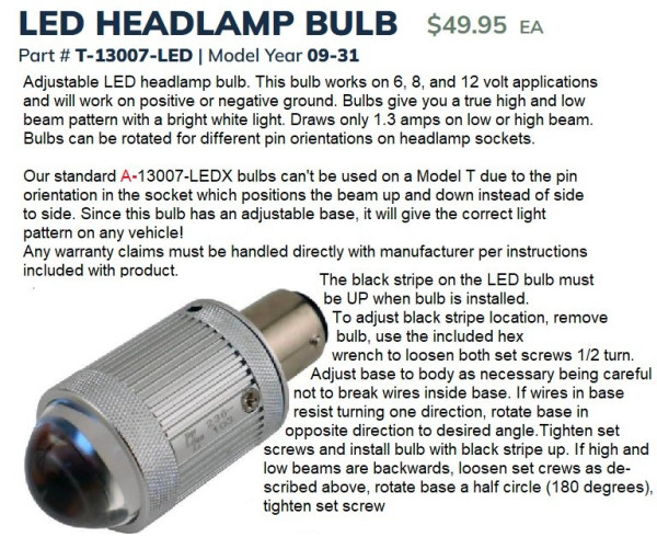

Are the headlight bulbs from LED Light in Arizona a focused bulb or do they rely on polished reflectors?
- Posts: 6397
Re: Headlight Double Fillement Bulb
I didn't see any in their on-line catalogue indicating a Focused Beam. A lens is needed for that. They did have one bulb, wouldn't fit a Model T, that had a lens but the description said "here is only one filament. Built with 24 quantity side firing high quality 3030 chips. 6 3030 led chips for forward firing plus a lens. " A forward firing chips and a lens. So no idea of the light beam is a spot light, flood light etc.Dennis_Brown wrote: ↑Fri Sep 01, 2023 9:02 pmAre the headlight bulbs from LED Light in Arizona a focused bulb or do they rely on polished reflectors?
$50 each. I will pass

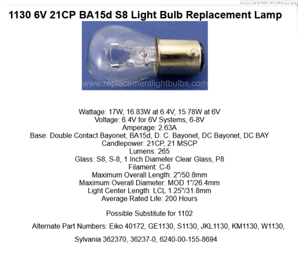

I'm using the original 21-2 cp bulbs in my car. They don't do much in the city, but are fine when it's dark and there are no street lights.

Larry,
What is the amp draw for 21cp?
- Posts: 6397
Likely it depends on the bulb brand
The following was an entry error on my part that Luke pointed out (Calculation Watts to Amps Watts / volts = Amps , 21/6 = 3.5 amps per filament)
I meant to use the watts for the example 21 CP bulb specification attached
Calculation Watts to Amps Watts / volts = Amps , 16.83/6.4 = 2.63 amps per filament
Also if you look at the specification the watt value changes with the voltage drops
There is an approximation of CP to Watts for filament bulbs that is dependent on a performance factor P (assume 100) & standardized variable 12.57
CP = W * P/12.57 or CP*12.57/100 21*12.57/100 = 2.64 https://calculator.academy/watts-to-can ... alculator/
As Larry indicated these work fine when it's dark and there are no street lights. They should bright enough to alert on-coming drivers
Some seem to be more concerned about the affect of amp draw on the battery & recharging than light output. So lets say your ammeter is at minus 6 amps (for whatever load you have on it - coils, lights, USB charger) and you have a 100Ah fully charged battery. 100Ah / 6amps = 16 hours but that's not reality & would drain the battery. So one can easily expect 10 hours of use. Recharging time depends on the amperage output of the charging system, rated battery Ah, current Ah and even temperature. The formula for estimating assuming needing a full charge. Ah of the Battery / output amps of the charger.
100Ah battery on a 6v smart battery tender output of 2 amps = 100Ah/2amps = 50 hrs on a 6v 5amp charger 100Ah/5amps = 20 hrs
Battery charging - ignore the EV reference - https://ev-lectron.com/blogs/blog/how-m ... battery-at
Frank,
Candlepower (CP) isn't the same as Watts, Ohms law isn't applicable to calculate current draw directly from CP. It may be that Larry's bulbs draw 3.5A, but not necessarily.
Also, with regard to a typical Pb battery, if you want to get maximum life out of them you shouldn't discharge beyond about 30% of their nominal capacity. Thus a 100Ah cell really has circa 30Ah available to the user before they would begin to shorten their life by drawing down further.
Specific cell construction and chemistry can enhance this, and other cell types such as LiFePO4 may be discharged down by as much as 90% without concern, in which case you're able to safely utilise much more of that battery capacity at the standard rate. As LiFePO4 is becoming more prevalent, is a comparatively 'safe' chemistry, and is close to Pb in terms of cell voltage and charging regime, they can be a great alternative if you need extended runtime.
Finally there's Peukert's law which, keeping it simple, essentially means that the available runtime will also be affected by the rate at which current is being drawn from a cell. Cells are usually rated at a standard discharge rate (say 20hr); if you draw more than this the cell will tend to have a shorter runtime than stated, if you draw less it will have a longer runtime. In the case of Pb this could make as much as say 25% difference, with LiFePO4 it could be as little as 1%.
Thus in the example you give it is likely that drawing just 2A from a standard 100Ah Pb battery would in fact give you more than 50hrs runtime (if you chose to discharge the battery to destruction, and ignored the voltage drop), conversely if you drew say 50A you'd have less than 2hrs to run.
Luke.
Luke.
- Posts: 6397
Oops, did I do that? Yes I know CP isn't Watts my mistake I thought I corrected that and added some specs I found for a 21 CP bulb
Might have forgot to hit submit on the initial correction
I am correcting my original entry & include the specification
Thanks for the noticing!

I don't know much about electricity, but can follow a wiring diagram. I also know the bulbs they used to make are not the same as what's available now.
The 21 cp bulb pictured above is not the same appearance as the originals. It also doesn't mention what the lower cp is.
I don't think they even use the cp designation any more?

Larry,Original Smith wrote: ↑Mon Sep 04, 2023 10:54 amI don't think they even use the cp designation any more?
That's quite correct, the UK candlepower became candelas (a SI unit) in the 1940's I think. There is an approximate conversion between the two with one candlepower being about 98% of a candela, and they originated as a measure of the intensity of a light source compared to a 'standard candle'.
Today manufacturers tend to use lumens (lm), which is a different thing again, effectively being a measure of (visible) light over a unit of time. Lumens are relatable to CP via something like: 1 lm = (0.98 x 1CP) x sr where sr is a square radian. The reason for this is to consider a light source that radiates equally in all directions and, practically, what this means is that a 1CP light source would equate to about 12.3 lm.
Given an automotive bulb doesn't radiate equally in all directions, along with various other things, it's possible that 1CP could be very roughly equivalent to say 6-9lm. Thus your 21CP bulb might be ~120-190lm, but I need to stress this is very much a 2-minute back of the cigarette packet calc, and that someone may have actually measured this much more accurately (ie. I could be wildly wrong!).
Finally, as LEDs are measured in lumens, and consume much less current than an incandescent bulb, you could (again very roughly) say that for an equivalent light output a LED lamp might consume somewhere between 1/5th to 1/10th of the energy required to power an incandescent bulb.
Luke.

- Posts: 6397
Thought I'd add the difference between the connections & pins for automotive & marine. The marine bulbs could be used for those T's where the headlight bulbs are wired in series.babychadwick wrote: ↑Thu Sep 07, 2023 9:03 amPuzzle solved apparently I need a ba15d automotive bulb and the seller listed as an ba15d auto/rv stop turn bulb and silly me since they never mentioned filiment or marine I assumed it was a stop/tail dual filiment ba15d base bulb. Now that I know since and I don't have time I'll simply rewire it for marine (single filiment dual base) and order something right. Then transfer the bulbs to the speedster as the ground has beed problematic in the past and it's just on/off light switch.
The bulb base BA15 s/d are mostly called taillight bulbs Today. The BAY15 s/d are also taillight bulbs but brighter but have offset pins so they don't fit the T sockets.
