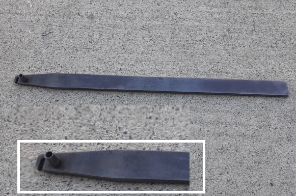

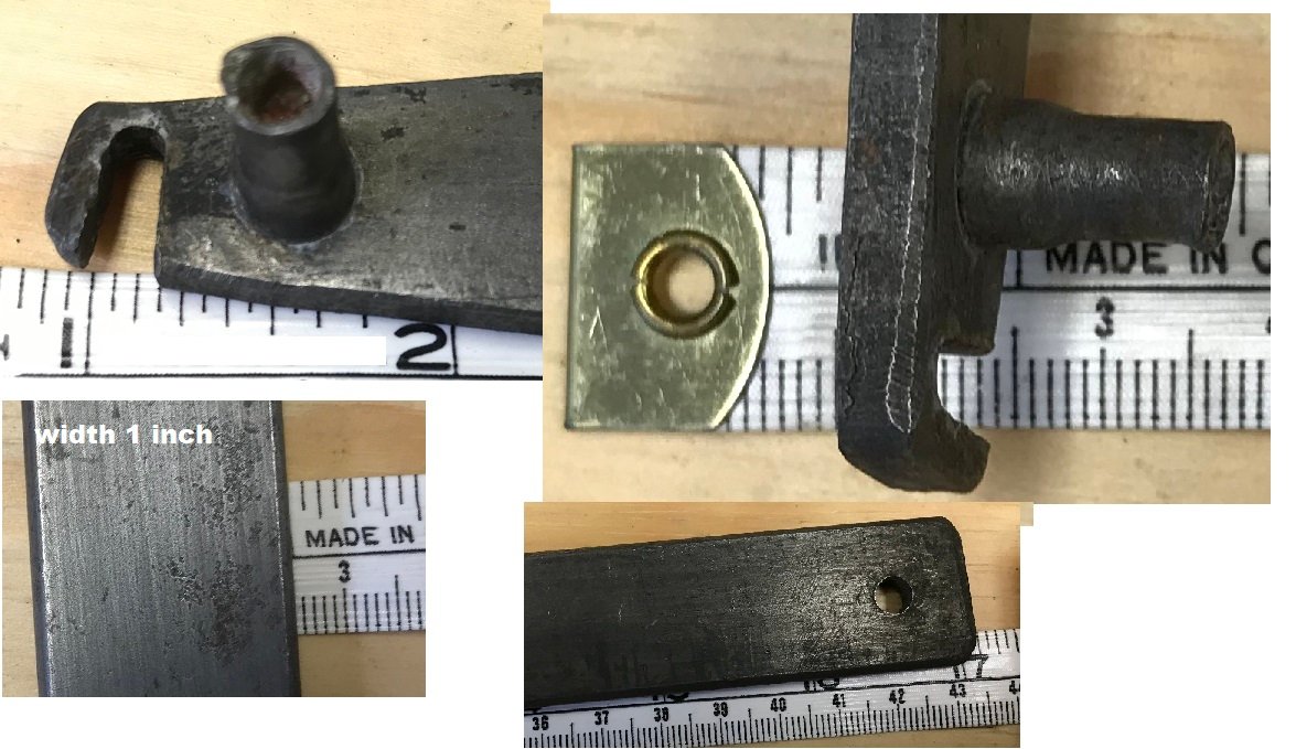

In a previous post someone was looking for dimensions of the large hub spring tool
Large Hub brake tool 2.png (273.04 KiB) Viewed 1189 times

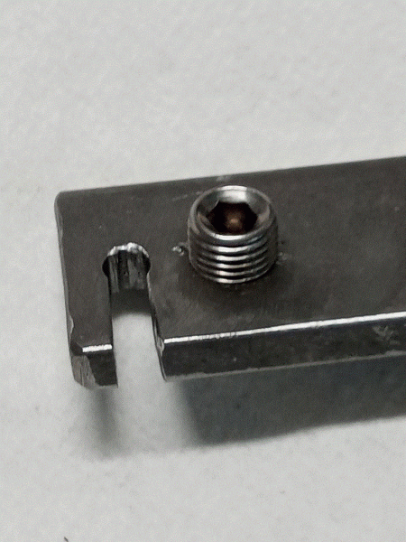

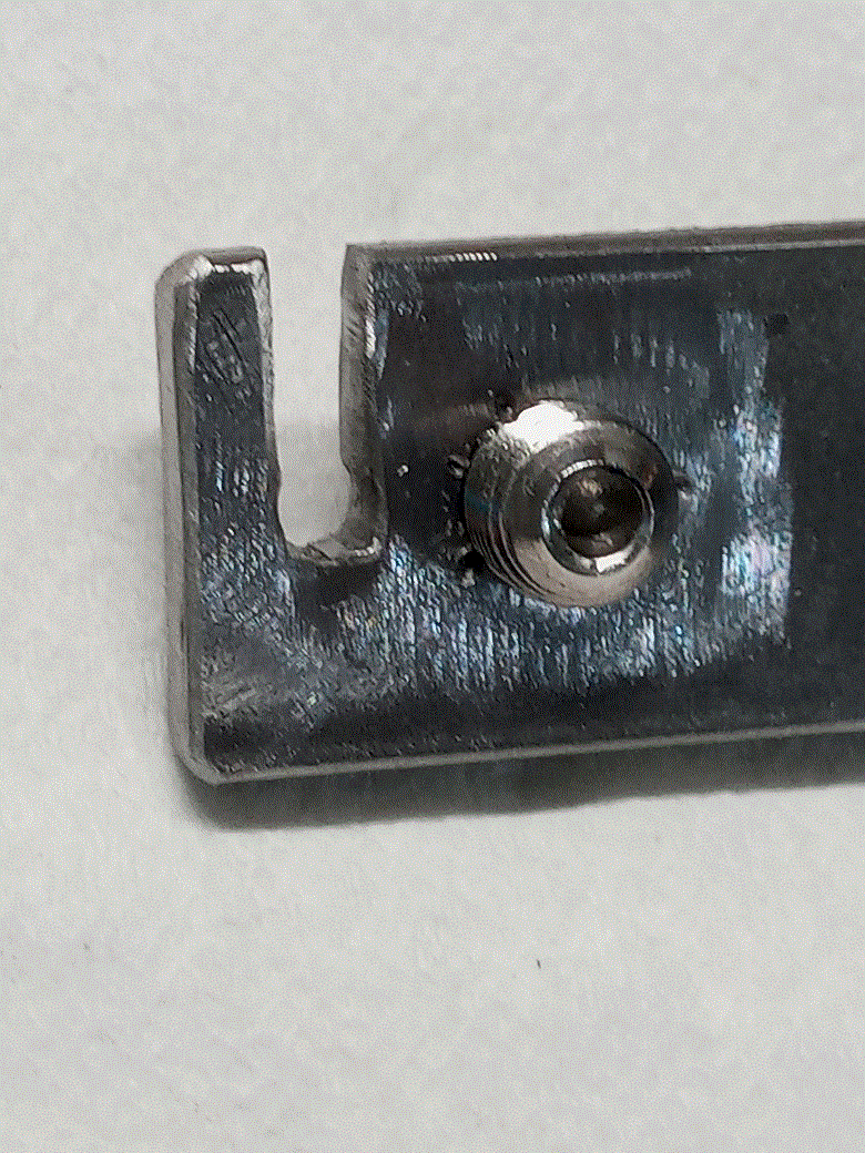

I made one from some scrap metal and a set screw I had laying around.
It ain't pretty, but it works.

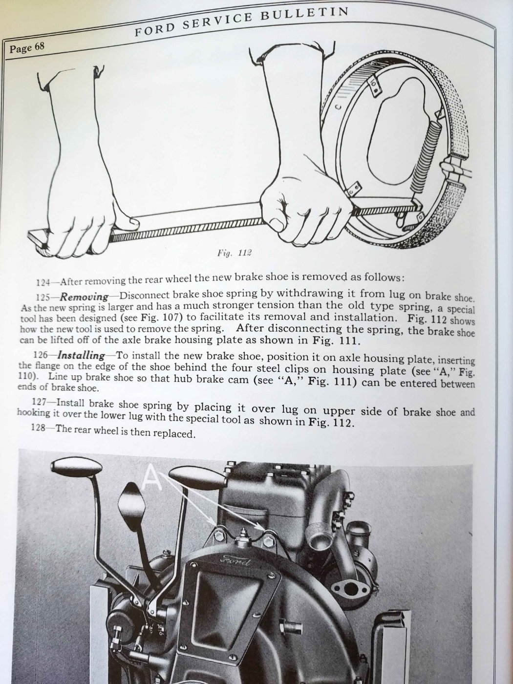

I don’t think I have ever used a tool like that one. How does it work???
Posts: 5570
Re: Large Hub Brake Spring Tool
Post by RajoRacer » Wed Aug 30, 2023 4:10 pm
It's only used for the single large spring on '26 - '27 cars.
Posts: 2066
First Name: Jeff
Last Name: Humble
Location: Charlevoix, Mi
Board Member Since: 2006
Post by Humblej » Wed Aug 30, 2023 4:54 pm
Ford Service Bulletin
Post by Tourabout » Wed Aug 30, 2023 6:53 pm
Now it makes sense.
Thanks!!
