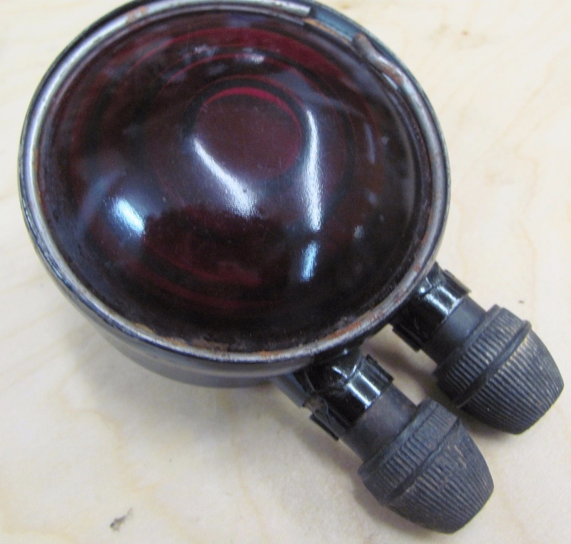

I went to Luray yesterday and bought a tail light and bracket, the bracket is Ford p/n T.7506 A ( IT'S A LITTLE HARD TO READ). The looks like a std model t round light except it has 2 plugs on the bottom. Does anyone have an idea what it fits ? thanks Chris

It was made so it could be run on ether the magneto with the headlights or battery, one socket for each.

Thanks that is different, any idea what year it was used ?

The bracket factory number would be for a touring, '15-'21.
For the neat dual lamp, Ford supplied a single bulb elec. tail lamp beginning 1919. Those dual lamp taillamps are aftermarket accessory.
