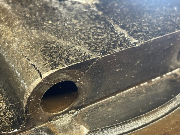

Been wanting a T for 20 years. Have an A but wanted a T. Bought on local, 1927 Tudor, “Dad drove it in the barn, I watched him”. Yep it likely did on about 1960. Seems the 10 year old boy didn’t know or hear the rod knock that made them park it. Didn’t hear it when I cranked it by hand before buying.
Pull pan to look it over and find loose rod bolts and find babbit all but gone. Pull it apart, buy a pile of parts and start the complete rebuilt. Full stop right now because of no camshafts available. Not putting a used up cam in an otherwise brand new engine.
Next I buy a 25, again told it ram and drove. Was a farm car. Get it home and running. Runs OK but has some issues. Cracked head, blow head gasket, band trans bands and a host of chassis issues. But it drives for the most part. It was just a frame, cowl and windshield. Was going to build a truck bed and just make a fun driver.
Along comes car 3. Nice 26, original car. No engine. Good body and lots of “parts” came with it. Figured I’d take engine from the 25, slide it into the 26 for a decent driver while I wait for a can for the 27.
Pull engine and figured might as well look it over inside while it’s out. I find debris. Seems magnet keeper came off, hit mag coil and wadded up the oil funnel. So I start looking and making a list of every thing the “running” engine needs. The List is long and would be much shorter if I listed what was good.
Buy engine 3, a 26 that was pulled because car was hit decades ago. Old boy said she was in good shape. HAHA.
Maybe in 1970 it was, before the mice moved in. Another, order everything but a block, job it seems.
I’m thankful that I can do all the machine and dab work myself (outside of grinding the crankshaft) but man, it’s getting old ordered $300-400 worth of stuff weekly and not getting ahead of it. I know in the end I’ll have 3 cool rides but this isn’t what I expected. I was hoping to get one running and enjoy it before the next step, seems Im at rebuild it all top to bottom, then sit on it all winter.
I’m just bummed and venting a bit, sorry guys. It just seems there isn’t a middle ground for a guy to get into a car. It’s either a $3,000 car that needs $10k invested or buy a $10k car that needs another $3k invested.
Again, sorry for the rambling.

Thank you all for taking time to reply. Ordered another round of parts for this “running” engine. They are supposed to be here tomorrow. A few things are new valves with bigger stems, needed to ream the guides. Pulled the engine completely apart, hot tanked and set it on the mill table. SHIT. Now the block is broken!!!!😔
Seems someone didn’t have a main bolt installed correctly. I didn’t notice as the crack was likely full of oil sludge. I just walked away for the night, glad I don’t drink.

That block damage isnt a motor killer. Run it.

My point is, just get one running. It doesn't matter if a non-critical part of the block is cracked or you sling in an old cam. Perfection is the enemy of progress. All this stuff is super easy to fix anyway - get one of those cars moving under its own steam and enjoy it (maybe just don't go too far from your house at first).
