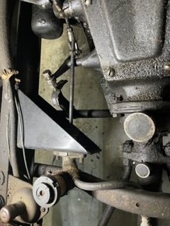

I bought this 22 centerdoor from a freinds estate and he
Had added juice brakes back in the 1990s. Can anyone id this setup and explain what the missing pedal linkage looks like? Its on there so might as well hook it back up. Thanks.

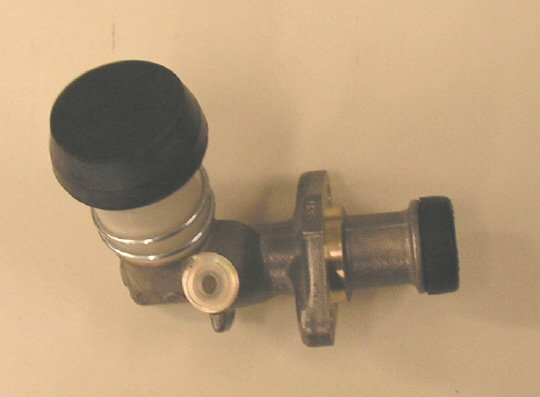

The brake master cylinder is actually a Honda Clutch Master Cylinder for certain early years with manual transmissions.
They are still available for under $50.
I recently bought one, and I can find the details if you need them.

Re: Help needed to identify and repair juice brake system
I found the details!
TechniBrake made that brake kit many years ago.
That Brake Master Cylinder is for a 1978 Honda Accord Clutch Master Cylinder for a manual transmission. That unit was made by Bendix, Tru Torque, Beck-Arnley and another company. Only the Beck-Arnley unit appears to match the units I have seen and photos. Bendix has dis-continued sales and production. That unit is still available for $41 and a rebuild kit is available for $16 from Beck-Arnley.

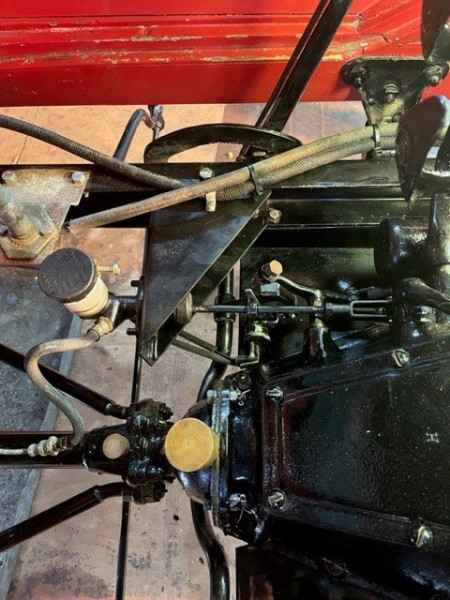

This photo actually answers your question explains your pedal linkage better.
The brake pedal has to have a link welded below to actuate the rod that closes the cylinder and apply the brakes.
The small center rod section has a short link that actuates the brake switch there.
