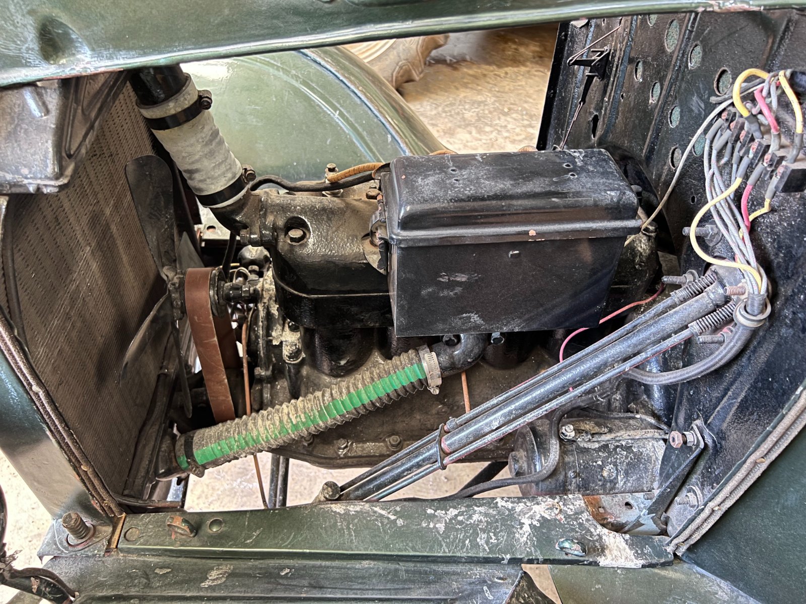

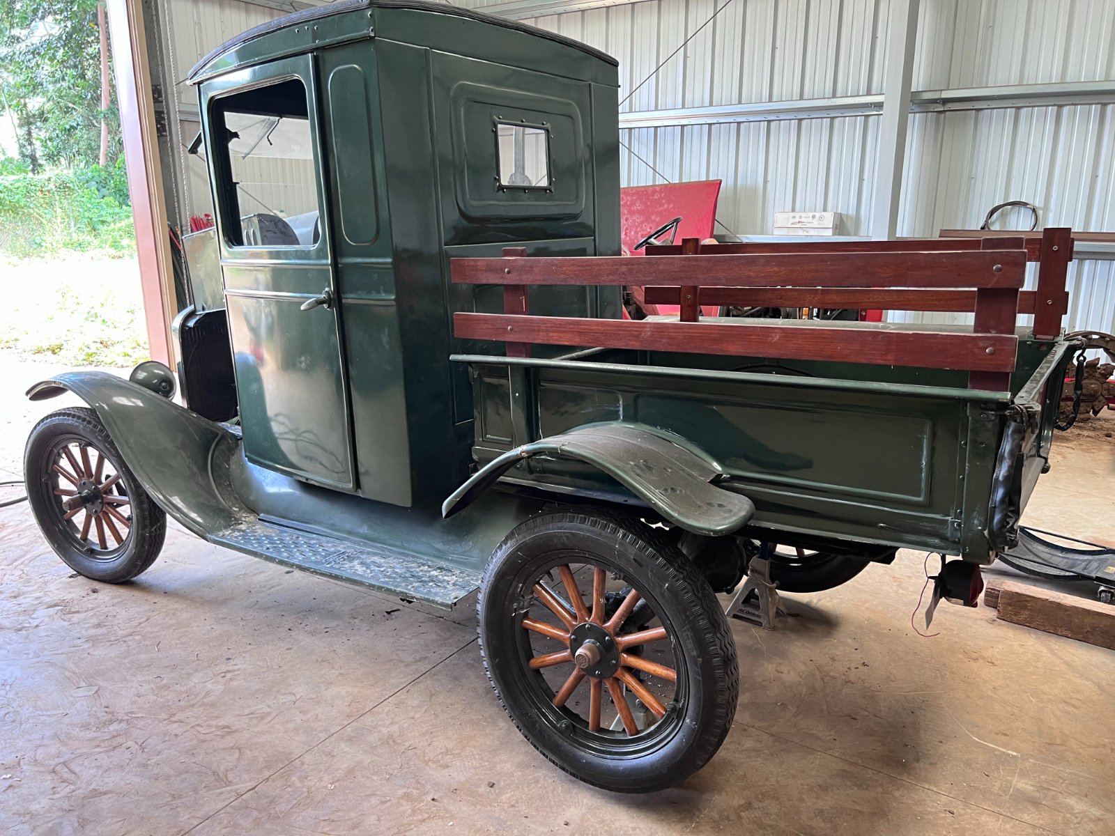

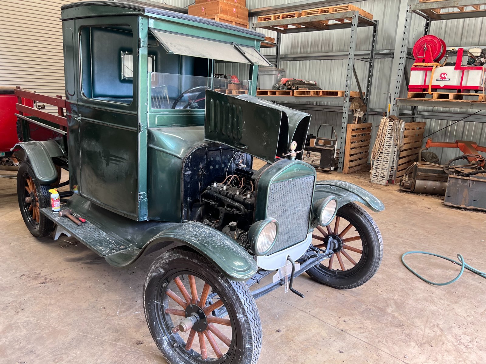

Hi all, I'm new to the forum. Have worked on cars all of my life and have a number of classics (50's and 60's) but never owned a real T before. This one showed up on my facebook marketplace and I was shocked it was in Honolulu, just a few miles from where I live. Its been stored in a Coconut syrup factory (the white stuff on it is corn starch) for the last 24 years (last owner recently passed away) and I'm told that before that it was stored in a warehouse in west Oahu for about 20 years. Long story short, I wound up buying it a moving it to a small farm we have in Windward Oahu. My speculation is that this is a FrankenT? The motor based on serial number is from July 1920. I have no clue how to tell when the frame was made. The cab looks like it came from a 1919 TT? and the rear bed looks like a repop to me, its just in to good shape to be something 100 years old. After cleaning up the fuel system with fresh gas and carb cleaner, changed the oil, tested the coils and spark plugs, set the timer and then hot wired the box (no key) with a new 6 volt battery, the engine cranked about 4 times and then started up. Pretty amazing for something that has not run for probably 40 years. Can run it for only about a minute since the lower radiator outlet is rotted out. I can tell from a few short runs that at least one intake valve is probably stuck since there's some blowback through the carb and the clutch is stuck, I guess from sitting so long. I'll deal with those issues once I can run the engine long enough to see if they work themselves out. I did include a quart of ATF in the new oil to help things unstick. Hope to have it on the road again in a few months so I can tool it around the farm community:-)
I'm really looking for comments on what everyone thinks this is so I can try to get my story right!
Thanks in advance!
Steve
Thanks in advance!
Steve

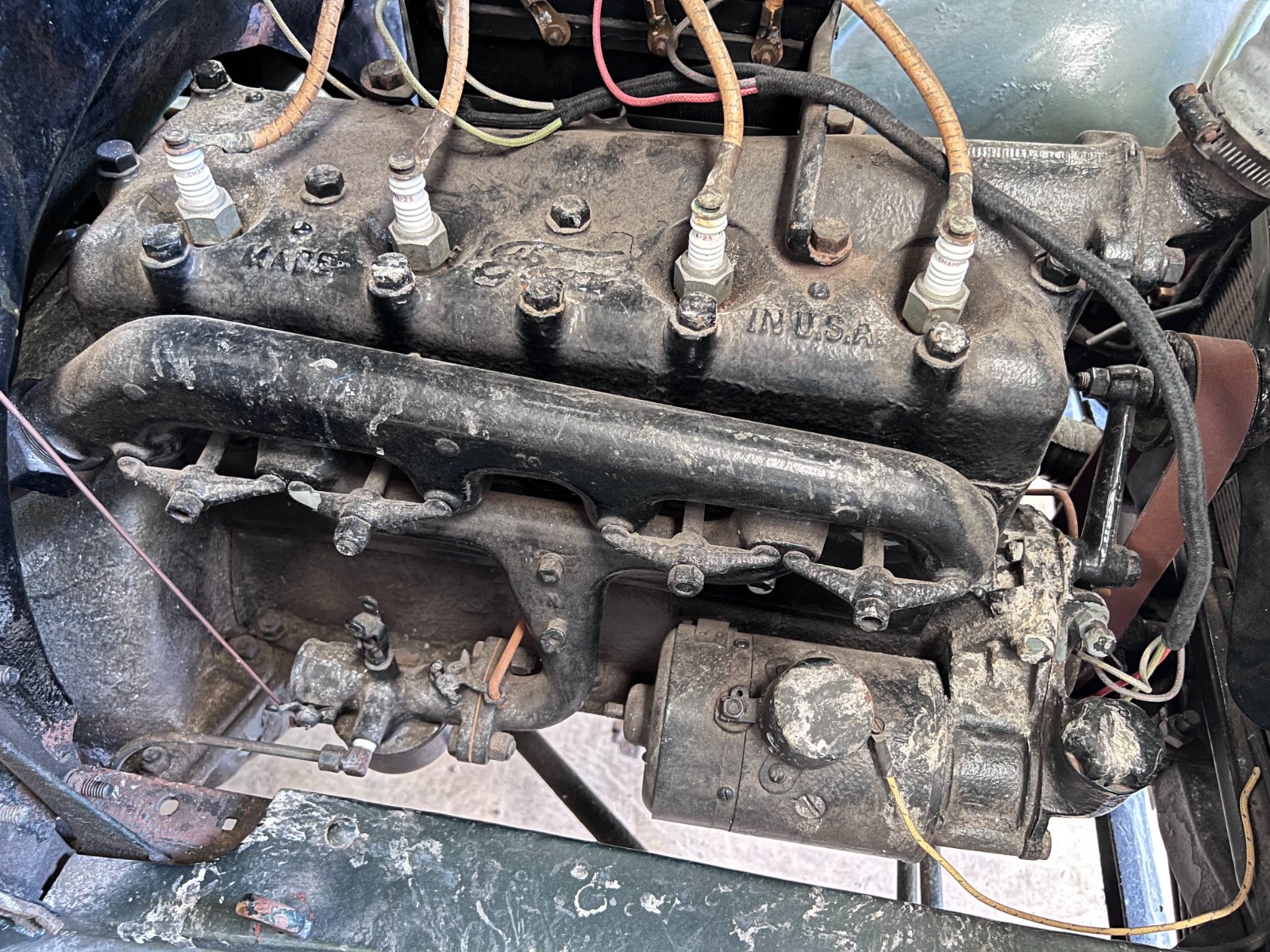

Yes it is a bitsa T, don't let that take the fun out of it. Just go with the 1920 & have a good time. Check the compression to find out if there is a
stuck valve. I reasently had to free up 3 exhaust valves in a engine for a friend. If thats the case, remove the generater, tappet cover & plugs.
squart penitrating oil, MMO or what ever you have through the plug hole. ( go a head & get all of them just for good measure ) with the tappet
close to the valve you can pry up gently, then turn the engine to drop the tappet & pry down on the valve. A brake spoon has the right angle to
get to the valve through the plug hole. Once you get it running ( if there is no water in it dont run it very long ) with both wheels jaked up, hand
brake straight up try pulling the hand brake back slowly to stop the rear wheels. That should free up the clutch after a while. Then look for a
radiator shop. Good luck. & wellcome to the afliction.

The TT cab is from 1925 through 1927. But I wouldn't worry about that. It looks wonderful, and there are several other similar model T pickups scattered around the continental states.
I am not sure what the box is from. I appears to be an era factory pickup box of some sort, and might even be a model T box from late 1925 through 1927. Or it may be off something else. Either way, again, unless you are wanting to restore it back to car show condition? Things like that were changed around for many years after model Ts were manufactured. Thousands of model Ts were turned into pickups during the 1930's depression years when many people needed a cheap work truck. That is also a part of the model T story, and something to be proud of.
It appears to have the coil box mounted on the top of the engine. That is also a 1926/'27 thing. Close examination might reveal the chassis to be much later than 1920. If Hawaii is like most of the other states, and you have a valid state title for the T? Don't try to change it or correct it, bureaucrats don't like to be corrected. Make sure the numbers on the title match something on the car. And call it whatever you think fits.

Good show Steven ! Great looking Model T ! The only non Ford thing I see is the 2 rear fenders - but they’re cute and fit right in. A barn find right nearby! How fortunate !

Fun looking truck. The builder used a late TT (‘24-27)cab and placed it on a small drum axle car chassis (pre-26).
The bed is the ‘27 metal T pickup bed offered for the runabout. Nice work on the flared fender with extension to fit the location where a runabout fender would go. Perhaps those rear fenders are fiberglass?, can see damage on the upper edge. If so, that could date assembly. Nice paint and body work too.
Very good fun truck, should be easy to get it in running condition.

You can check for a stuck valve by turning the engine with the hand crank. You should feel two compression events per engine revolution.

That's a very nice looking vehicle. If the chassis is in good condition, it could safely carry around 400 lbs in the bed
with 2 persons up front.
It will ride and handle much better than a TT chassis, and should be able run run comfortably at 30-35 MPH if it has standard
passenger car gearing. If equipped with an auxiliary transmission or 2 speed axle, it would be more versatile.
If the chassis is in good condition, it will handle safely and predictably, EXCEPT when backing up, and of course, braking is severely limited. Always back up slowly, and NEVER let the vehicle roll backward fast.
Driving a T is quite different than driving a "modern" vehicle. You actually do have to drive it, which I find enjoyable.

Your T is missing the carburetor adjustment rod that allows applying the choke and also adjusting the fuel mixture from the driver's seat.

Your TT is in pretty good shape! It appears to be a solid TT that has been sort of redone here and there but it’s an enough Model T to be the real deal.
This is a T that can be good enough as it is with just some minor work. It doesn’t need a restoration and I wouldn’t think about it at all. Hopefully you got a title or bill of sale with it. Whatever is on the title go with that for whatever the year is. Don’t try to make it exactly as what it is. In other words don’t worry about it!
If it still has an original T radiator that may have to be replaced. The lower radiator outlet can be fixed but will the radiator cool is the big question! Since you’re new to Model T’s if the radiator “looks” good that DOES NOT mean it will still cool. Your radiator ‘might’ can be fixed but be aware that it may not cool!

If you can post a photo of the dash & switch, we can determine the year of the cab.

For the stuck valve- put some Marvel Mystery Oil in the gas or even just some engine oil. That may be enough to free up the stuck valve, or pull the plugs and squirt some diesel fuel over the valve area in the cylinder. Its less work than removing the valve side door as a beginning. If your water outlet is toast, just mix up some JB weld or Marine Tex, clean the rust off, and use window screen to temporarily "rebuild" the outlet so you can keep water in the engine. just a sugestion.
- Posts: 4631
Re: What did I get myself into:-)
That’s a good reminder about JB weld. Do as Dan M says so that you can get your T going and driving and you may get lucky and find out your radiator still cools fairly decent. I hope it does.

The JB Weld outlet nozzle repair worked better than I could have ever expected. Thanks again Dan for the suggestion and i'm confident it will hold until I get the permanent fix in place. I'm just using it to work out the bugs and won't take it on the road until I have the permanent fix in place.
Ran the engine at least 5 times today, each time for 10-15 minutes. By the second run the clutch was working and by the 4th run the blowback I was getting through the carb was all gone. Now I have to track down some rattles in the front of the motor. Can't tell if its coming from the fan, the generator or something else but will try to track that down with a stethoscope tomorrow or Monday. Also removed my hot wire while the engine was running and it didn't shut down so I guess I have a good magneto! Without the key the only way I could shut it down was to put my hand over the air intake.
I used my temp gun and found that the back of the head near the fire wall toped out at about 210 degrees, the front of the head topped out at around 200 which seamed reasonable to me with the engine sitting in stagnant air in the barn. Really impressive that a 100 year old engine can run this well!

Be ready for someone to tell you to pull the head and check to see if you have 2 piece valves as well as tearing apart the rear end to check for bronze or babbitt washers. The coils, timer, box will be problematic as they were originally as evidenced by the multitude of accessories offered to correct them.

Borrow or buy a borescope to check valves, etc.
If the ignition system performs well, it's probably in at least fair condition. I've had very good service from a stock ignition system (with a New Day timer) over many thousands of miles. The only issues I've had with it all stemmed from a defective set of points.
