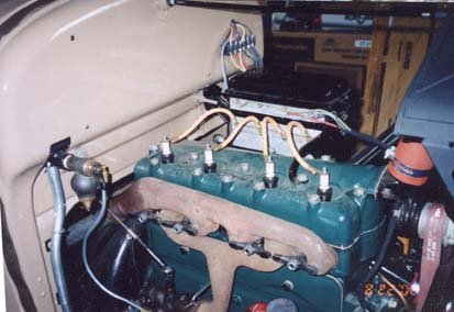

You need a tubing bender to do it right. or you could bend it around something round, about 2 or 3 inches in diameter. If you try to bend it without a support, it will kink very easily. See picture.
