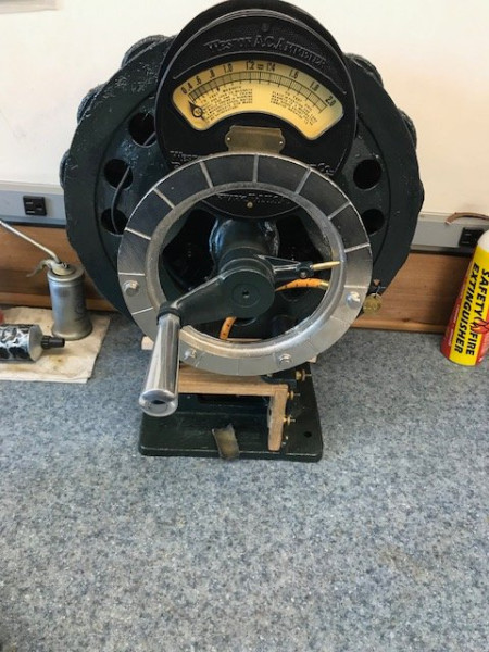

Re: HCCT Magneto Coatings - What, if anything, needs to be bare?
I have restored over 50 HCCT's so I qualify to opine.
This procedure will address your painted surface questions.
This process is for a Ford /Ford clone HCCT.
With the exception of the spark ring mechanism (I will address the spark ring later) everything may be painted. Do not paint electrical connections.
Totally disassemble the HCCT, including the flywheel. The flywheel is cleaned and painted. The magnets were cleaned, crack checked, recharged and assembled onto the flywheel with new screws and clcmps using Brass or new (do not reuse aluminum spools) setting the magnet heights with a KRW Gap Gauge. I then spray paint the entire assembled flywheel and hand paint the rebuilt field ring with a brush covering all the myriad noooks and crannies leaving the solder pile and field ring mounting machined surfaces (these are electrical connections ) unpainted.
I clean and paint the HCCT cast iron frame, install two new shaft bushings (driveshaft front bushings) in the casting.
Install new wood pieces in the coil test slot wood. Prewire the fame and coil test slot, field ring and meter connections leaving the wire to the meter long enough to connect upon final assembly. Install the field ring on the frame, make and install new Delring spark ring insulators onto the field rign mounting bolts. Under no curcumstances should you drill the 1/4-20 spark ring and 3/8-16 field ring mounintg screws/ bolts entirely through the length of the Delrin spacres. Mount the meter and connect the electrical connection to the coil test slot. The metere mounting screws will provide the meter ground connection.
Mount the flywheel assembly and set the (.025) magnet to field pole gap.
Now about that pesky spark gap. The tip of the rotating gap brass pointer should be rounded with a radius of approximately 1/8 inch (NOT SHARPLY POINTED!!!) with the spark gap set to 1/4 inch 360 degrees around the circumference of the spark ring inner radius You may have to shift the spark ring around to get a consistant gap measurement.
The following is is very IMPORTANT. The spark gap (radius of the rind and pointer tip) must be kept clean.The high voltage. low current sparks across the gap loves to corrode and if not kept clean the HCCT will soon quit sparking. I Nickle plat the spark ring. I also suggest cleaning the entire gap of the ring and pointer tip with a small stainless bristle wire brush before each use. Most HCCT new owners are not aware of this issue and when the gap stops sparking the reduce the gap to get it sparking again. A properly adjusted coil should provid enough energy to jusp the 1/4 inch gap in free air if the spark gap is kept clean.
The HCCT is a great tool, but it is a trap for logical people and is only as good as a man with some experience operating it and knowing the correct indications.
Have fun and don't get shocked.

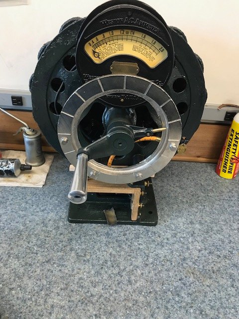

Notice the small piece of emery cloth?
Thats for spark gap cleaning.
