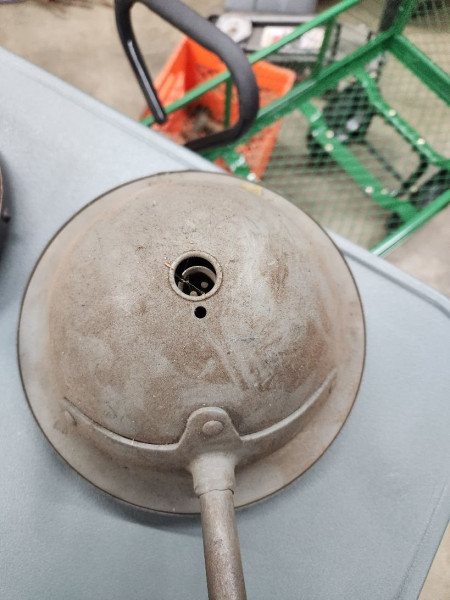

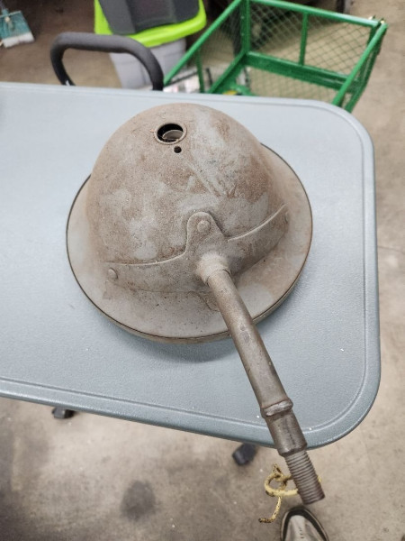

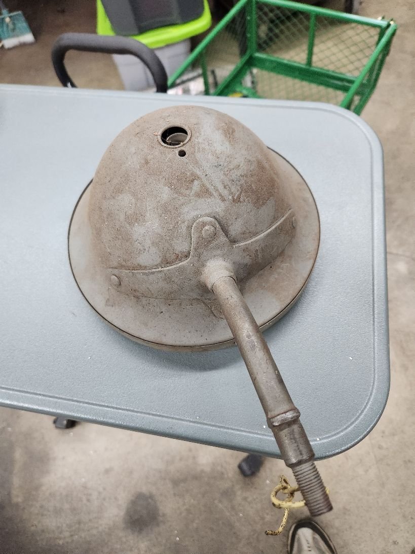

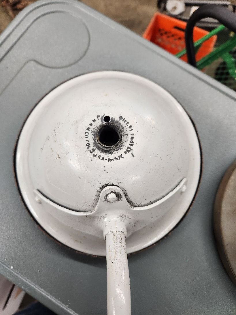

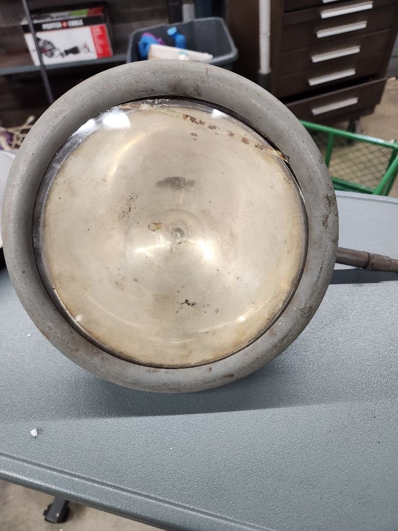

I know the 1915-16 head light had the focus screw hole on the top but what year was it at the bottom? see photos,Bob

Never saw one at the bottom before.

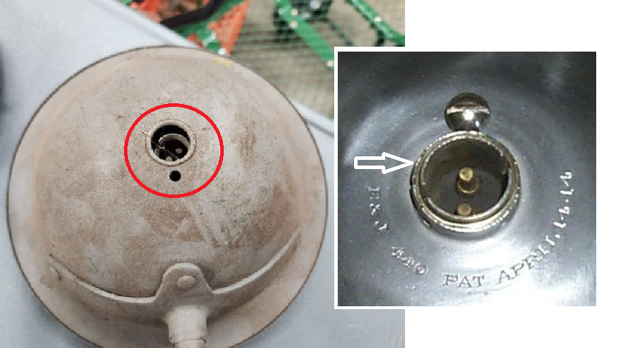

Wonder if its an aftermarket product or a production fail. Your photo appears o show a differences around the hole for the socket. Also what does the bolt end look like?

Just a guess, but maybe the lamp is earlier design, prior to changing to an adjustable socket for focusing the bulb?

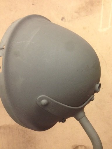

Here is a pair without any hole for adjusting screw, so maybe the early '15 when electric lamps came along, the suppliers to Ford had different designs, certainly later, the adjustment screw was above the socket, as mentioned in the 1919 Service Bulletin.
These early lamps did use the elbow type plug which hung down, so maybe this one with hole below is at the change time. Sure would be hard to adjust the bulb screw with the elbow plug in the way!

The white painted bucket with the stamped manufacturer's information circling the socket is one of the most common 1915 style headlamps, and were used at least through 1916. Note that although the bucket shape is slightly different than the common later headlamps, that it does still have a small flat area where the bulb socket pokes through.
That detail is important, because the other less common 1915 headlamps had a slightly more rounded back of the bucket, with no flat area for the socket.
Headlamps those years were made by a few lamp manufacturing companies, to Ford's design, however there were variations between the manufacturers. Some like the white one pictured above had the manufacturers information stamped into the bucket. Others did not. I have one "round back" 1915 lamp that has a round stamping barely enough to show through the paint, and not quite deep enough to read the lettering. I have another nice enough round back that clearly has no markings on it. And those two "round backs" are just different enough that I am not sure I want to run them as a pair.

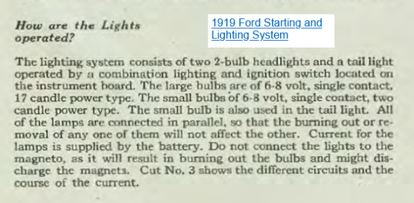

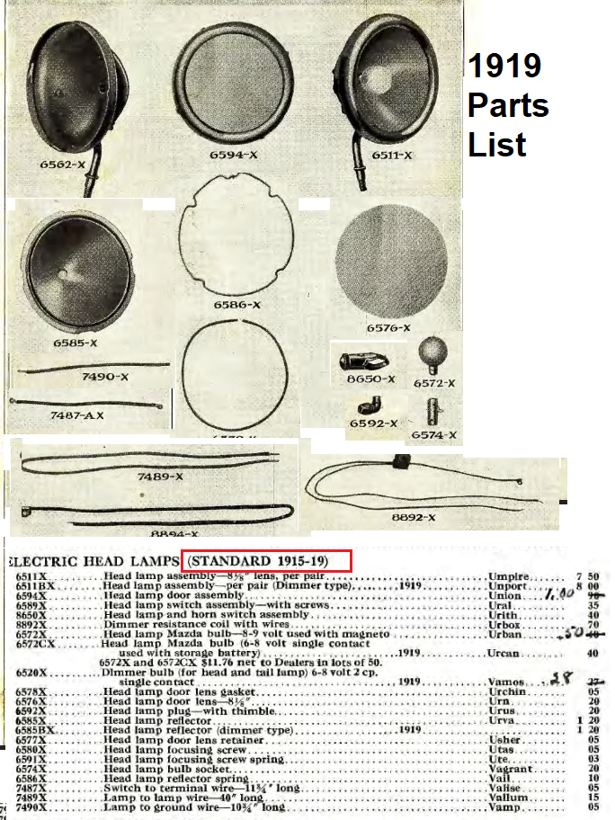

I believe there is some confusion with the larger bezel headlights on the 1915 and the on time offering of the dual bulb headlight in 1919. I looked at the parts catalogues in Cinmorelli's Library https://www.cimorelli.com/mtdl/default.htm to see if there when there were references to the dual bilb headlights. The 1919 Ford Lighting System is the only one that references their operation. There are no references to their parts (reflectors, wiring or buckets) in fact the 1919 parts catalogue seems to intentionally exclude them (Standard 1915-19)

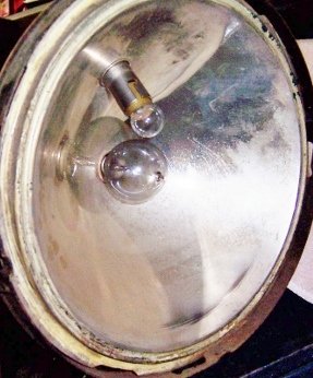

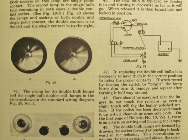

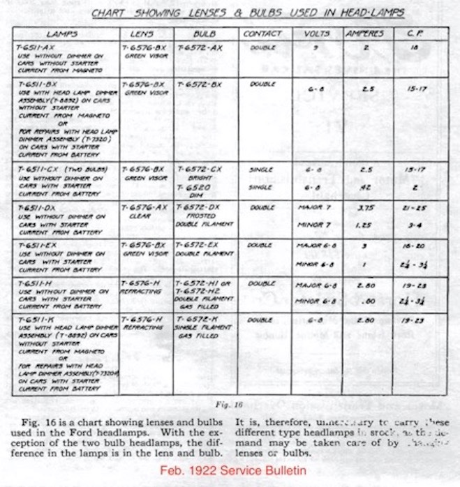

This info may help narrow in the dates of use, at least it gives the different headlamps and bulb usage. (From Service Bulletin
The two-bulb headlamps (Part # T-6511-C, or Fac. No. 6511CX, the third one down in the list ) were used with the green painted visor clear lens, in 1919 mostly, but who knows!
Would also think the larger brass rim was on the earliest magneto headlamp in 1915. There were other manufactures than Victor too for these early headlamps.
Click on images to enlarge some or for zooming in on your PC.
And this info is from Bruce Mc's research using Price and Parts Lists to assist the dating of usage. Indeed, knowing the exact time of use and the exact month in a model year of the Ford is difficult, as parts were chasing the build rate!
