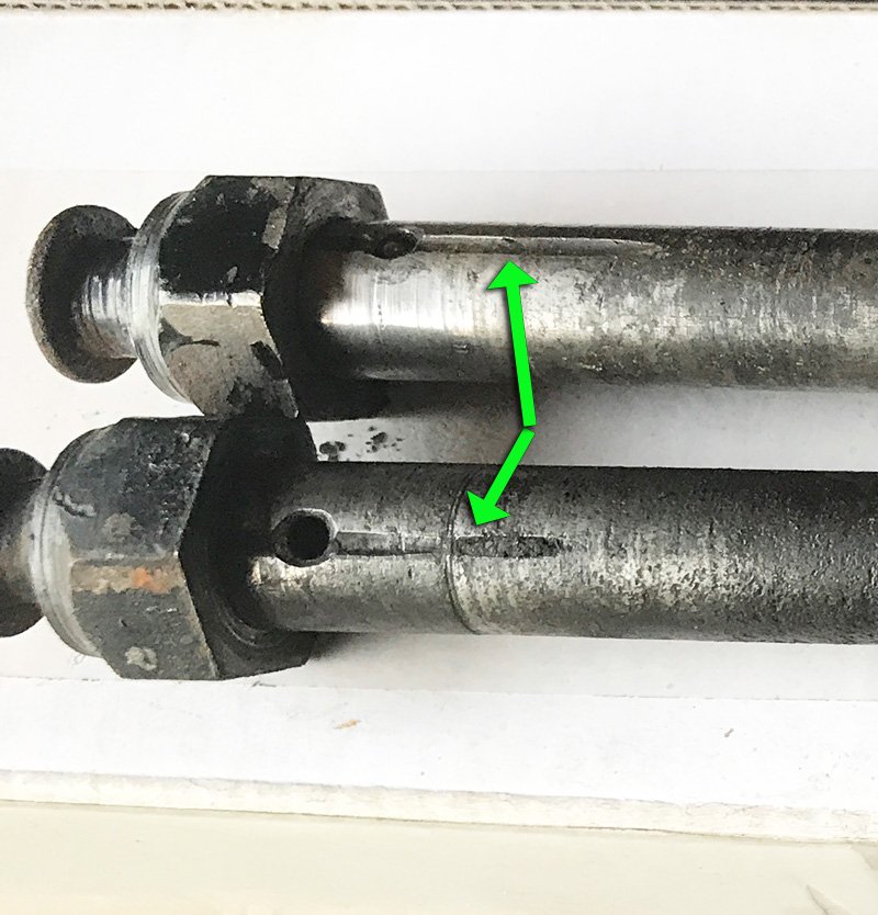

I suspect most of you are aware of this but for those who aren't (like I was) this is good to know. I recently replaced the spindle bolts (kingpins) in my front axle. Denny Newman used a Steven's tool to install cone-shaped top bushings in the axle so everything is now nice and tight. looking at the new bolts I observed that the top bushing covered the oil hole in the shaft. The only way oil can dribble down the bolt into the brass spindle bushings was to find it's way to the narrow split in the top bushing. A test showed very little oil making it's way thru.
Conferring with Denny Newman and looking at my old spindle bolts I learned the solution was to grind a small groove from the hole in the spindle bolt to a point below the top bushing (or if unmodified, the top axle arm) so that oil can make it to the bushings. The attached photo of my old spindle bolts should give you an idea what I'm talking about.

If they are made correctly, (big assumption I guess), the new bolts should already have those grooves. Original bolts had them from new.

Mine came from Lang's - they had a groove around the circumference of the bolt at the level of the hole but not the longitudinal groove.
Posts: 4042
Re: Spindle Bolt oil groove?
Post by DanTreace » Sun May 12, 2019 9:27 pm
Unless you can find NOS Ford spindle bolts, they all have just a hole and circumferential groove.
BTY, your old bolts are the nice to have original spring loaded manhole type, the oiler with that manhole cap is integral with that king pin bolt.
Ford design vs. Repro re-engineered. :?

Those spindle bolts look like 1915. Before that they had NO groove, so apparently Ford discovered the problem early on. I have several late Ford script spindle bolts, and they all have that groove. Randall Anderson is also putting that groove in his reproduction spindle bolts.

I robbed the oil cap from this bolt and noticed it has a flat spot down the whole side...

The photo that "Ruxstel24" posted, shows a spindle bolt that has a pretty simple modification that is the first one I've seen that seems to be a very positive means by which oil can find it's way to the lower spindle bolt bushing.

Evidently I have the non-grooved newer version kingpins that the vendors supply now. Question now is, how can I correct this problem, by creating a groove without distorting the rest of the already reamed and fitted kingpin? Thanks, Dave
Posts: 6708
Post by Scott_Conger » Sat May 18, 2019 10:38 pm
If you will really look...the original '15 kingpin had the hole in the middle of the AXLE boss. The groove then went approximately 1/2 way down into the top bushing. It did not go PAST the bushing. Oil had to still navigate it's way past the upper bushing to get to the lower bushing.
If you have a new kingpin that does not have the groove into the top bushing, then it has a hole at the very top of the bushing with a circumferential groove. Big deal. If your bushings bind on the kingpin, you either dorked up the line-ream or used too-small of a reamer...believe me when I say that after 5 miles of driving, the bushing will be passing oil to the lower bushing regardless of the care or lack of care used in the reaming process.
There are plenty of other things to worry about. Don't lose sleep over this.

The bottom spindle bolt that Dan posted is correct. I guess from this discussion, that Ford started the long groove in 1915? Randall and I had this discussion several years ago, and it was then that he decided to start the long groove in his spindle bolts. It only makes sense. I personally don't believe a Zerk has any place on a Model T.

The oil groove was the circumference cut by 1919 at the latest. I have two Ford drawings of the spindle bolt, one dated 8-7-19, and the other 4-28-22, both have the groove around the shaft, the older one being 9/16" below the bolt head, the newer one being 1/2" below the head.
